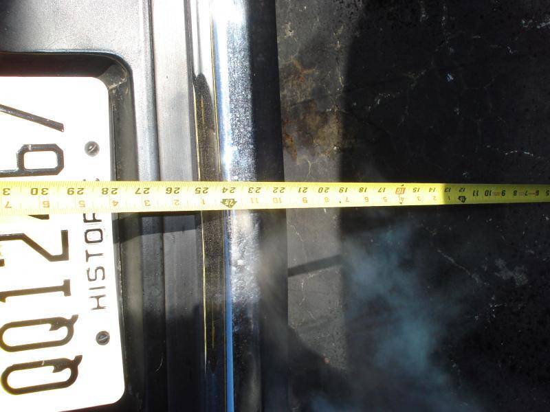

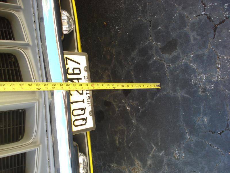

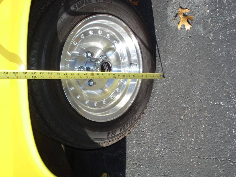

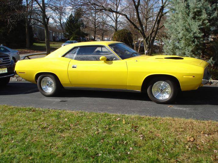

The car is not modified see attached photos. The rear leaf springs are new and the car sits higher than it did with the old ones.
What do you use instead of Teflon tape? DSC03178.jpgDSC03179.jpgDSC03180.jpgDSC03181.jpg
The front tires are 215 60 14" (23.5" dia.) rear are 245 60 14 (24.5")
not sure if these photos are attached correctly

Also in the 14 " sizes you are very limited to large tire sizing. The best thing to do would be to go with a 16-17" rim. This will give you an endless choice of brands, speed ratings, tread patterns. In current 14" tires commonly available, 215/70-14 is 25.85 " in height, 8.846 " wide in the section of widest part of the sidewall. Harder to find is 225/70-14. 26.40" tall and 8.86" section width. Also get a better brand than Pep-Boys Futuras . Their lowest performance/cost tire that they sell.
