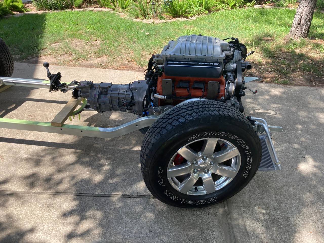

I have a TR6060 Manual 6 speed from Cleveland Performance with a Hellcat engine and a Schwartz Performance Chassis. The problem is Schwartz sent me a TR56 trans mount. Rather than swap out mount they want me to buy a tail section for a TR56 and mount to my transmission. The tail section is $1900. Question - if I use my TR6060 as is , will shifter location be OK in my 1773 Cuda? I realize I got to change with adapter. ANyone had this experience?

There is a u-tube video series from a guy who swapped the 6-speed into his challenger.
It;'s likely one of the post-swap test drive or first drag videos will show the shifter location in the car.
