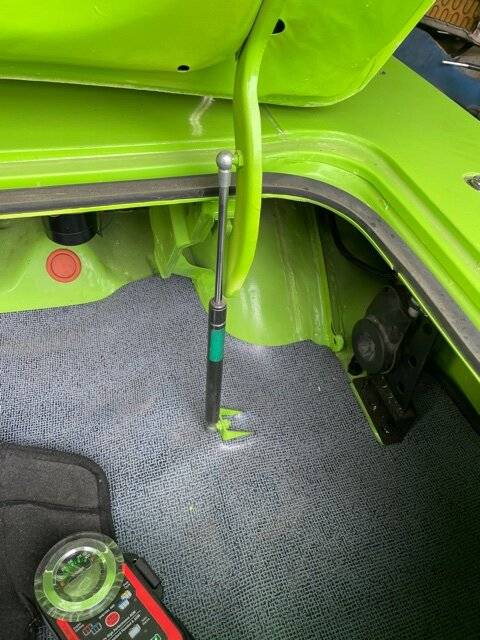

Spring/s are there just to open the trunk lid, on my 73 I replaced them with gas shocks (one per side).
Can you tell me what length shocks or part # you used in place of your trunk torque rods, have adjusted my rods as far as i can on 73 challenger & trunk lid still will not stay up. Any help would be great, Thanks Richard

Unfortunately I don't know the PN of them as I got them at a swap meet, I bought a handful and used the ones that fit. I can probably measure them though.
