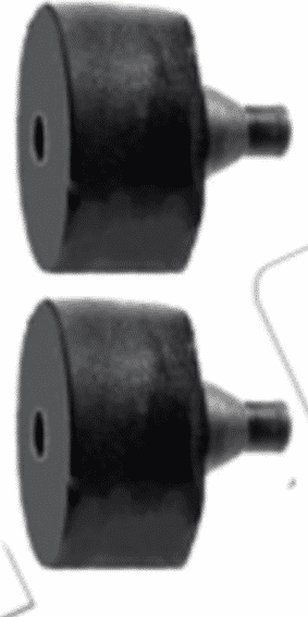

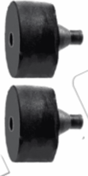

Hello,
Has anyone tried to install the rubber bumpers on the trunk lid, hood, doors etc. and ripped off the nipple rendering the bumper useless? I have.... Does anyone have any good tricks to install them?
I used dish soap and a small screwdriver which didn't work. I think I need something with a blunt end but small. Any and all suggestions would be helpful. I just don't want to buy more rubber bumpers if I can help it. Thank you.

For the round bumpers, use the hole in the center. Put a blunt object in the hole and push the bumper into the sheet metal hole. Did you use those holes in the bumpers?
The other bumpers definitely need lubricant as stated above.
I tried that, used a pin punch that just fit the hole. All I accomplished was separating the nipple from the bumper. I used silicone lube and twisted while pushing in and it still separated.
Repainted cars can end up with a bit of paint in the holes. Your call on reaming the holes to remove some paint.
That could have been my problem, I put mine in just after the car had been painted and I never thought about paint buildup. Good call!
@MoparCarGuy I tried to use the hole with a 7/64 ball end of an Allen wrench and lubrication (dish soap & water mix) with no luck. The Allen wrench just pushed through the end of the bumper.
I never thought to ream the holes out slightly, that would have been the way to go I think. I struggled getting them in and a lot of cussing....
