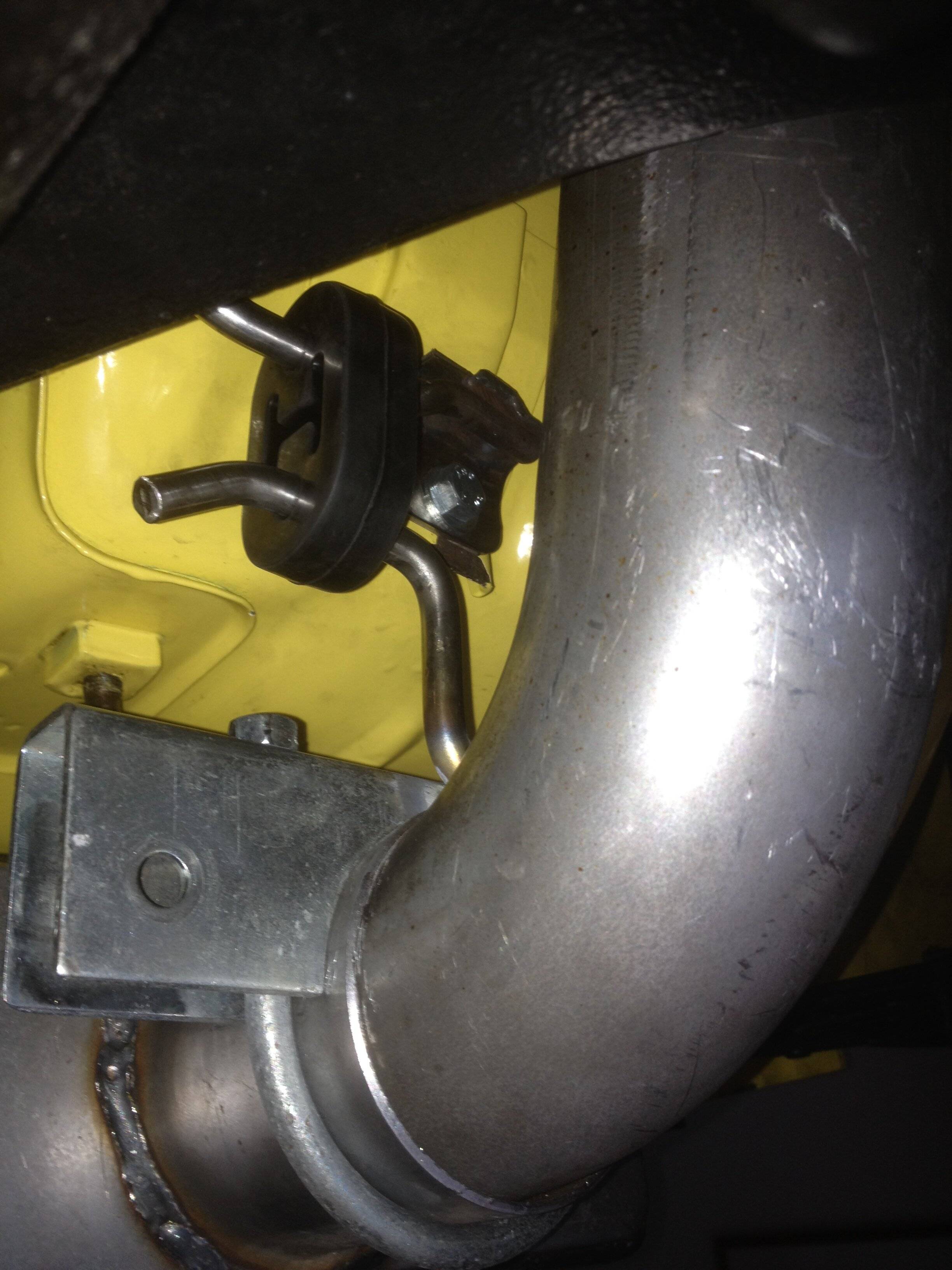

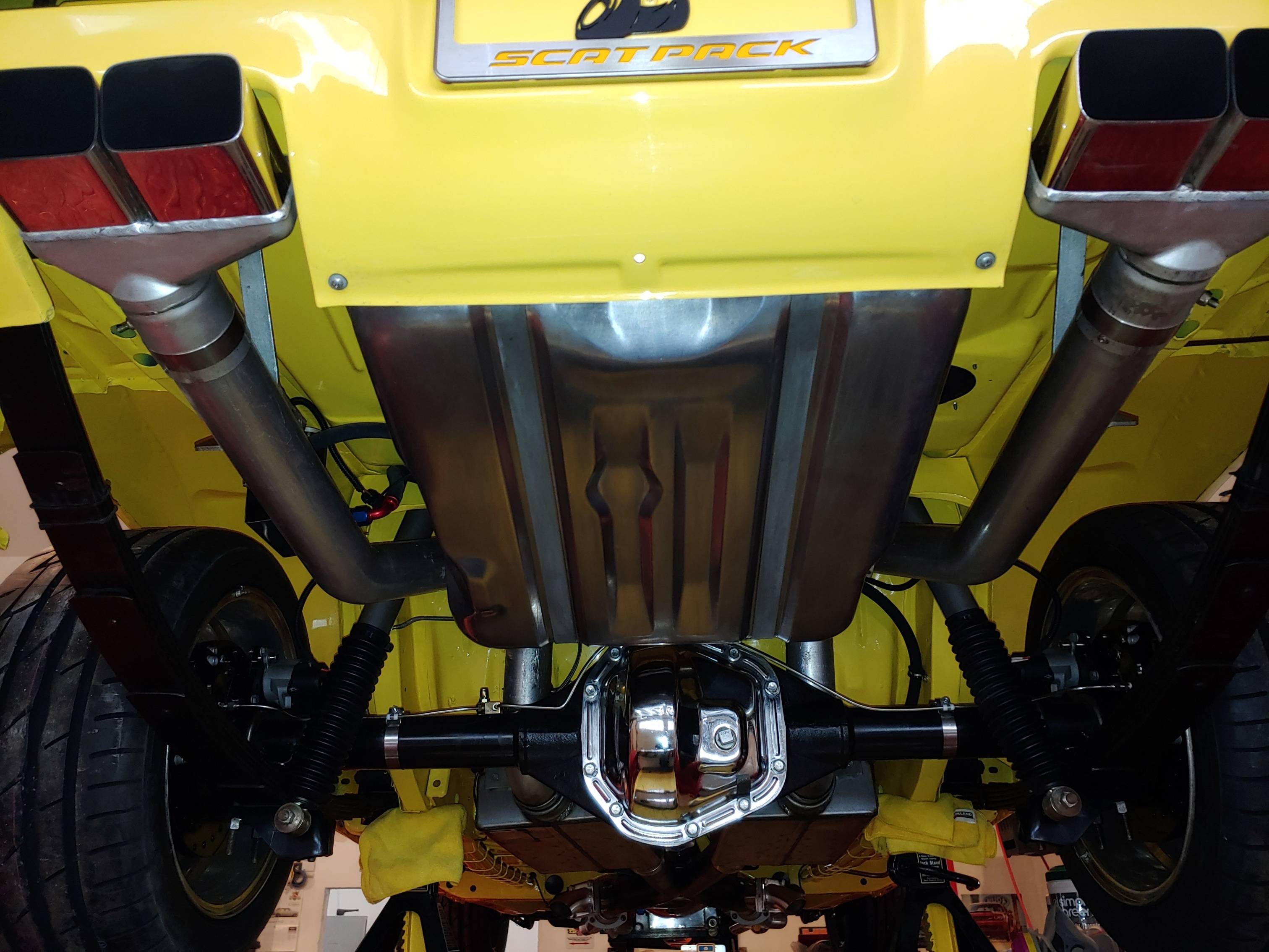

Anyone else hate the look of the TTI muffler hangers?
I always thought the 2 'tire rubber' straps and clamp showing cluttered the Chall rear view.
So after doing some custom hangers for my Demon exhaust that has 180 deg mufflers and AAR type rocker exits I decided to try to improve on the TTI E body setup.
I kept the TTI clamp and inverted it (helped since the crimp from the u-bolt was already there. I went to an online parts catalog and looked at a bunch of rubber isolators for size and strength. These Honda/Toyota parts I used cost less than $20 apiece.
Then just some tig torch time with 309 rod doing stainless arm fabs and joining to the carbon steel clamp.
Way cleaner look for a few hours work once I figured it out.
