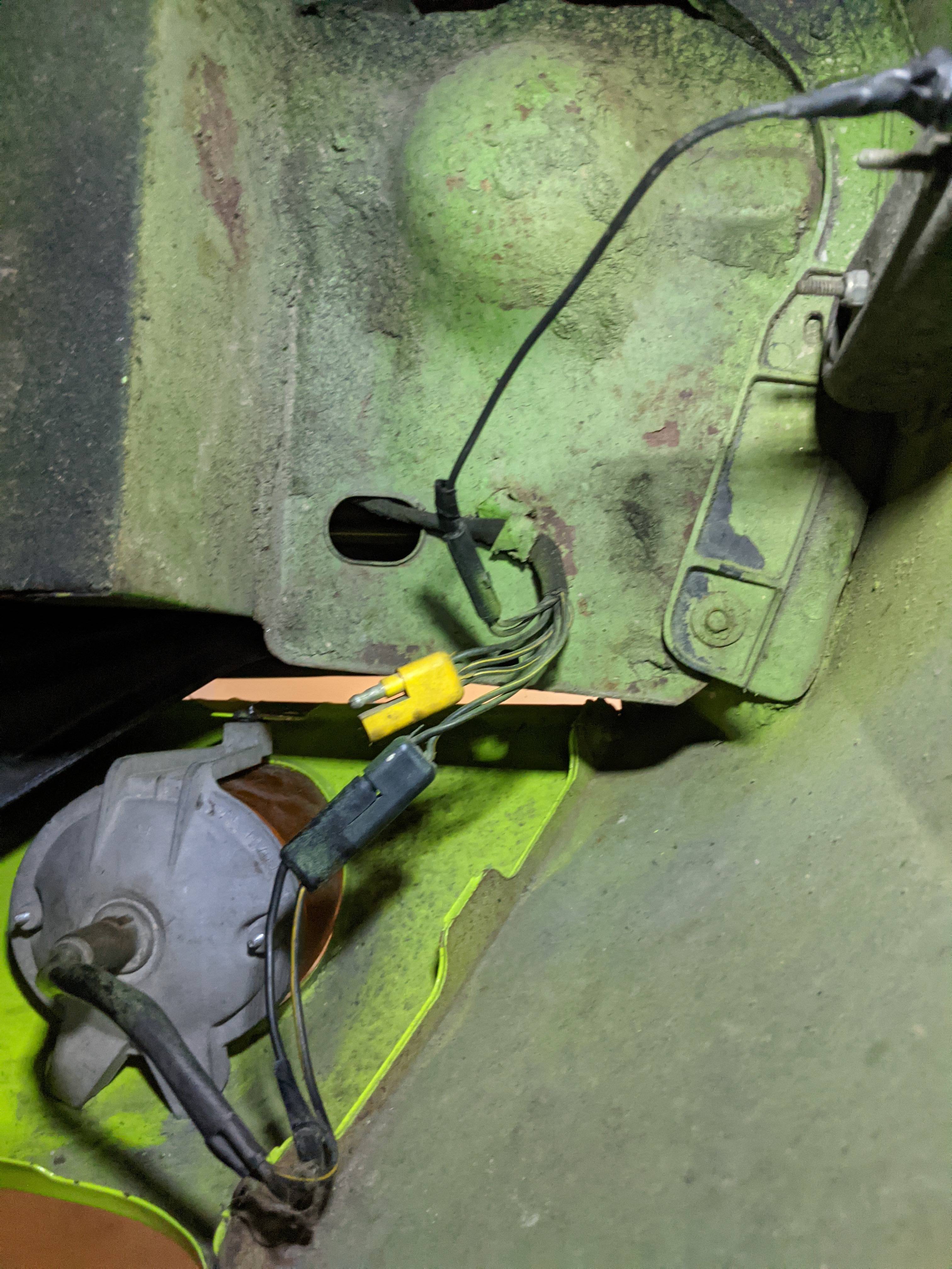

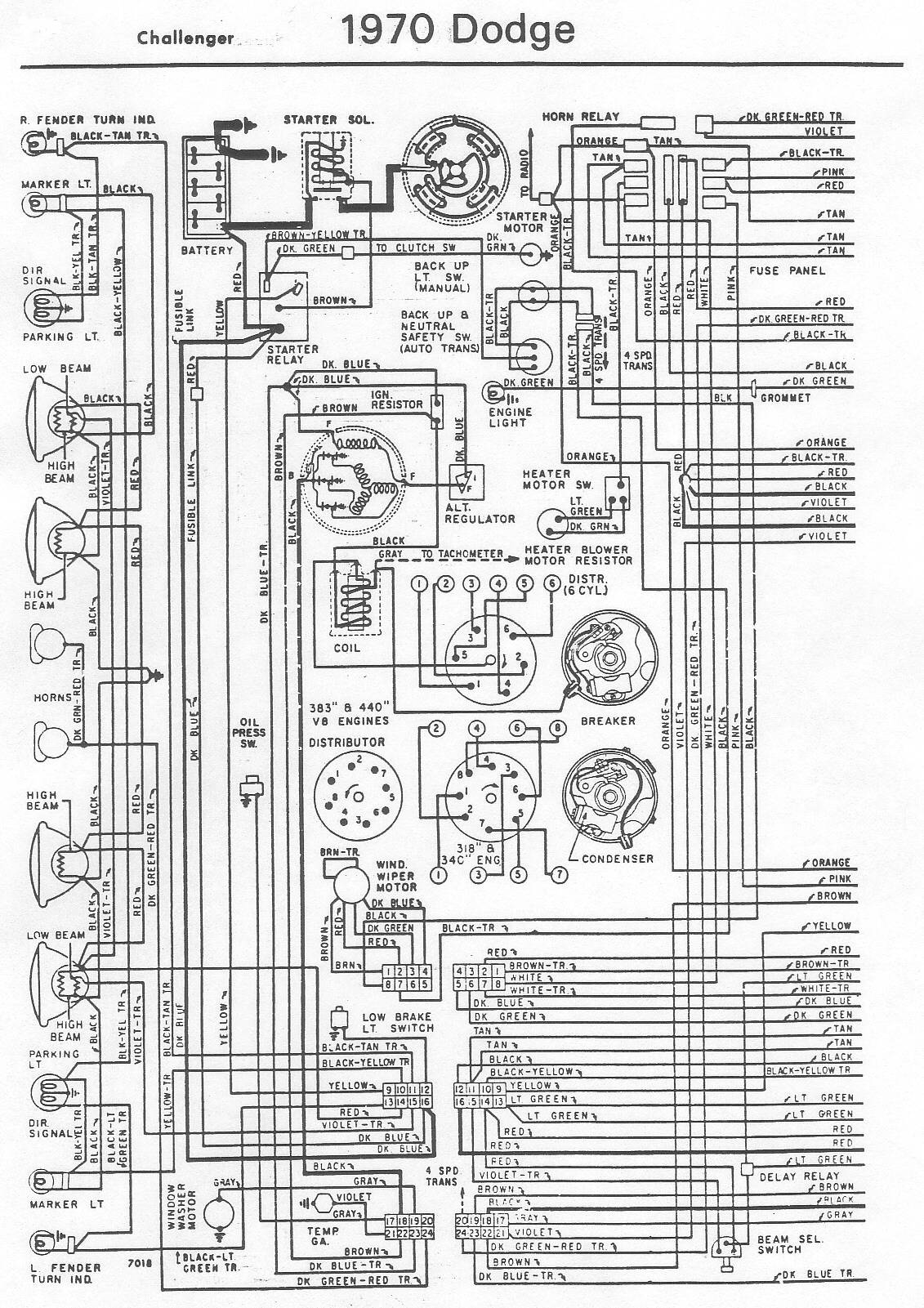

To add more info to the situation, I'm attaching a schematic and picture of the wiring I got going on behind the valance lights.
As shown on the schematic, wiring to the valance running light ("DIR SIGNAL PARKING LT") and fender marker ("FENDER TURN IND") look proper except it also shows a "MARKER LT". It has 3 wires running to it instead of 2 so it seems obvious that this is the yellow plug in my picture. What I don't understand is why this yellow MARKER LT plug isn't being used? Is it supposed to be? Related?

FENDER TURN IND is not the sidemarker lamp. It's the fender-top indicator visible to the occupants of the car (typical of cars with A04 light group, i.e. not all cars have them). MARKER LT is the sidemarker seen by people off to the side of the car. It is not supposed to blink, simply glow whenever the park lamps are powered.
From what I can see on your car, your sidemarker has the wrong lamp socket and wiring and it's connected to the single-pin connector for the A04-style fender-top turn signals. The socket for the sidemarker should have two wires and terminals, which connect to the yellow plug in your photo. If you don't have fender-top indicators, the wire currently powering the sidemarker is just left dangling by the factory. You can do the same... or add fender-top turn signals.
This, however, may not ultimately solve your ground issue. The front park lamp/turn signal assemblies ground through their housings via the valance. There must be a clean electrical path from the valance to ground, either via a wire/strap to the core support or through the various panel contact points and fasteners holding all that bodywork together.
There's a couple of things that could be happening, or a combination of the two:
  • 1) Since the sidemarker is connected wrong, the ground path for that bulb could be weak since the sidemarker lights are not self-grounding like the fender-top indicators are (see diagram).
  • 2) There's not a "clear" path from park lamp/turn signal housings to ground.

unplugged the side fender markers. hit 3 parts stores and none had the plug/pigtail i need. the socket itself is a single wire also... gonna go ahead and order the right ones soon so i can have 2 wire and properly plug into the yellow plug of the harness. for now, the side fender markers are simply unplugged.
i ran an alligator clip from the housing of the left parking light directly to the battery negative. ran another one from the right parking light housing to a solid ground in the engine compartment (wasn't long enough to go directly to the batter). i didn't start the car but simply tested again with the key in the 'on' position and saw zero change. behaving just the same as before: all exterior lights work as expected until the headlights are on running or fully on, then the front parking lights won't blink.

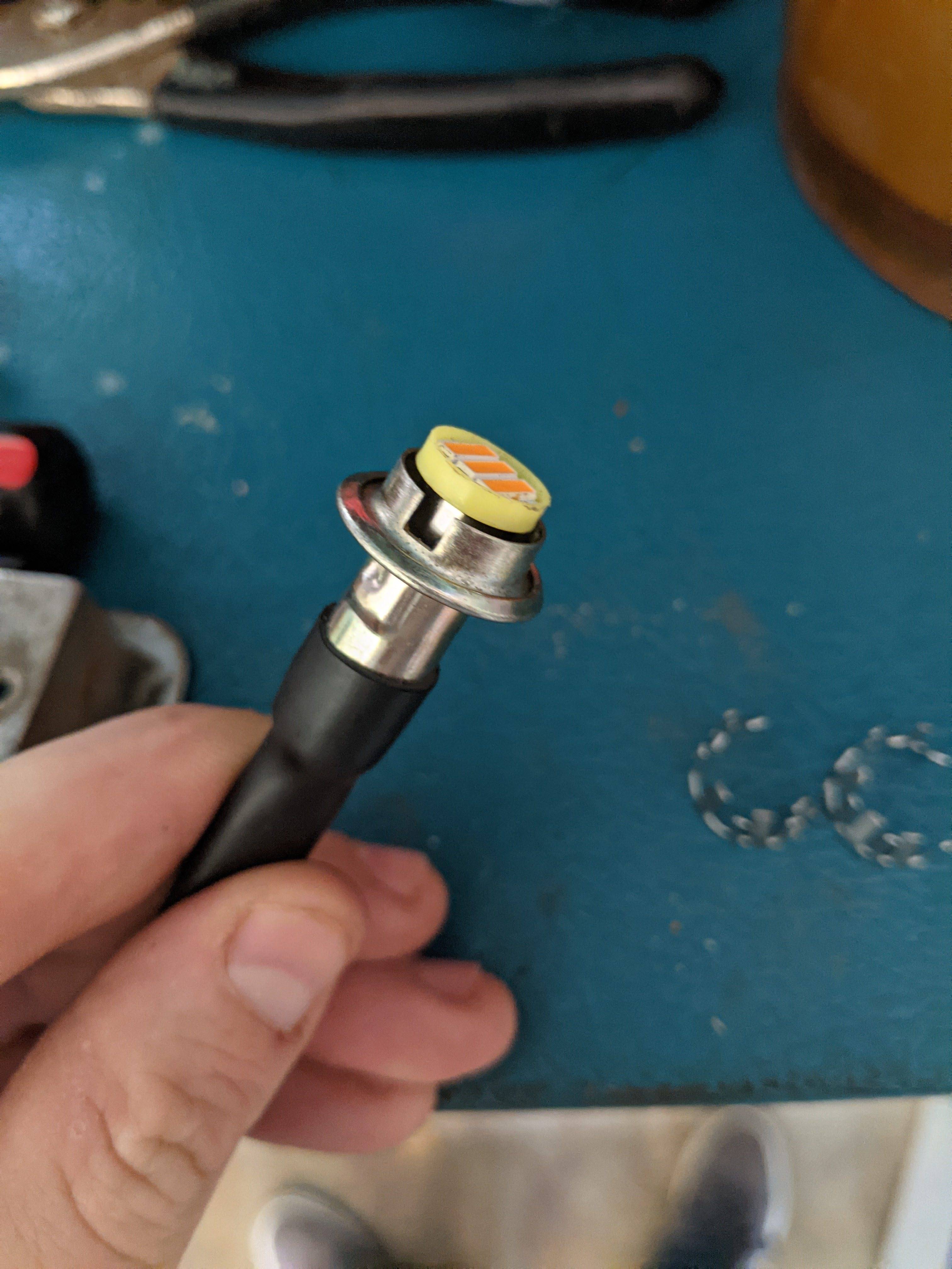

the negative wire coming off the back of the passenger turn signal light, before even it plugs into the harness, had electrical tape on it (actually can be seen in the photo i posted above). i didn't think twice about it but in being thorough i unwrapped it just to see what was underneath. sure enough, that negative wire was busted and hanging together by a thread. i cut it and wired it back together clean, complete, and solid. since that black wire is shared with the other turn signal light i knew that was it. right away the lights were working but the one side was dimmer, and less performing that the other. i looked at the LED close up and could see that a few of the diodes were out. i ordered brand new LEDs for both, installed, and viola it's all good now.
in summary---
1. fixed broken negative wire off the back of the passenger turn signal
2. replaced the LEDs/bulbs
