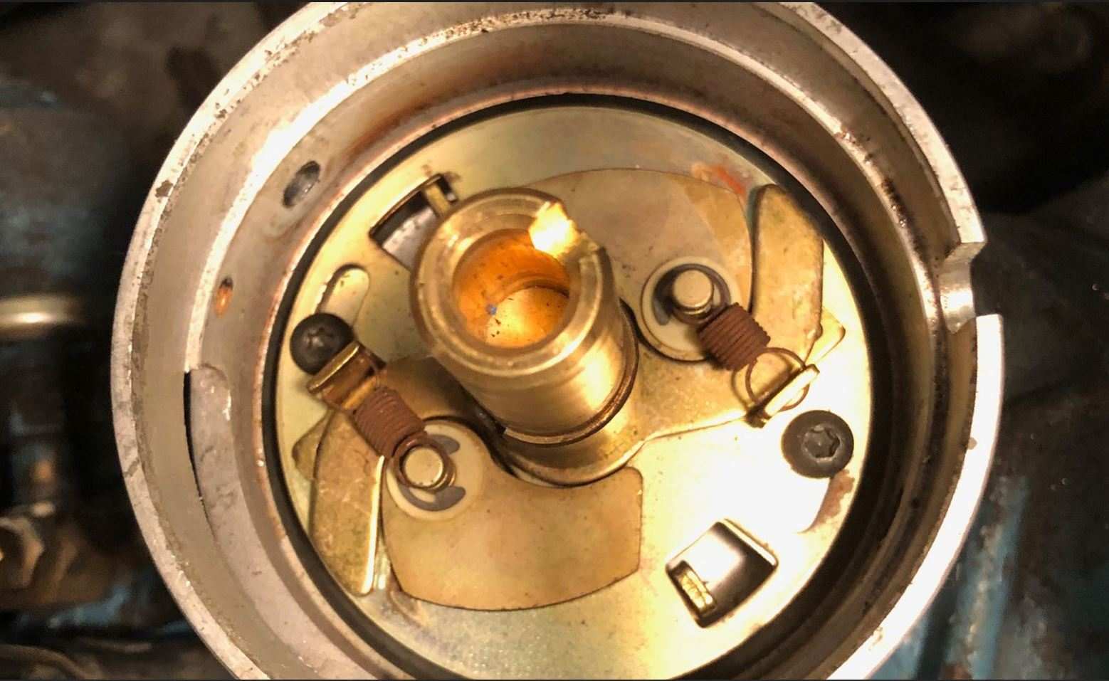

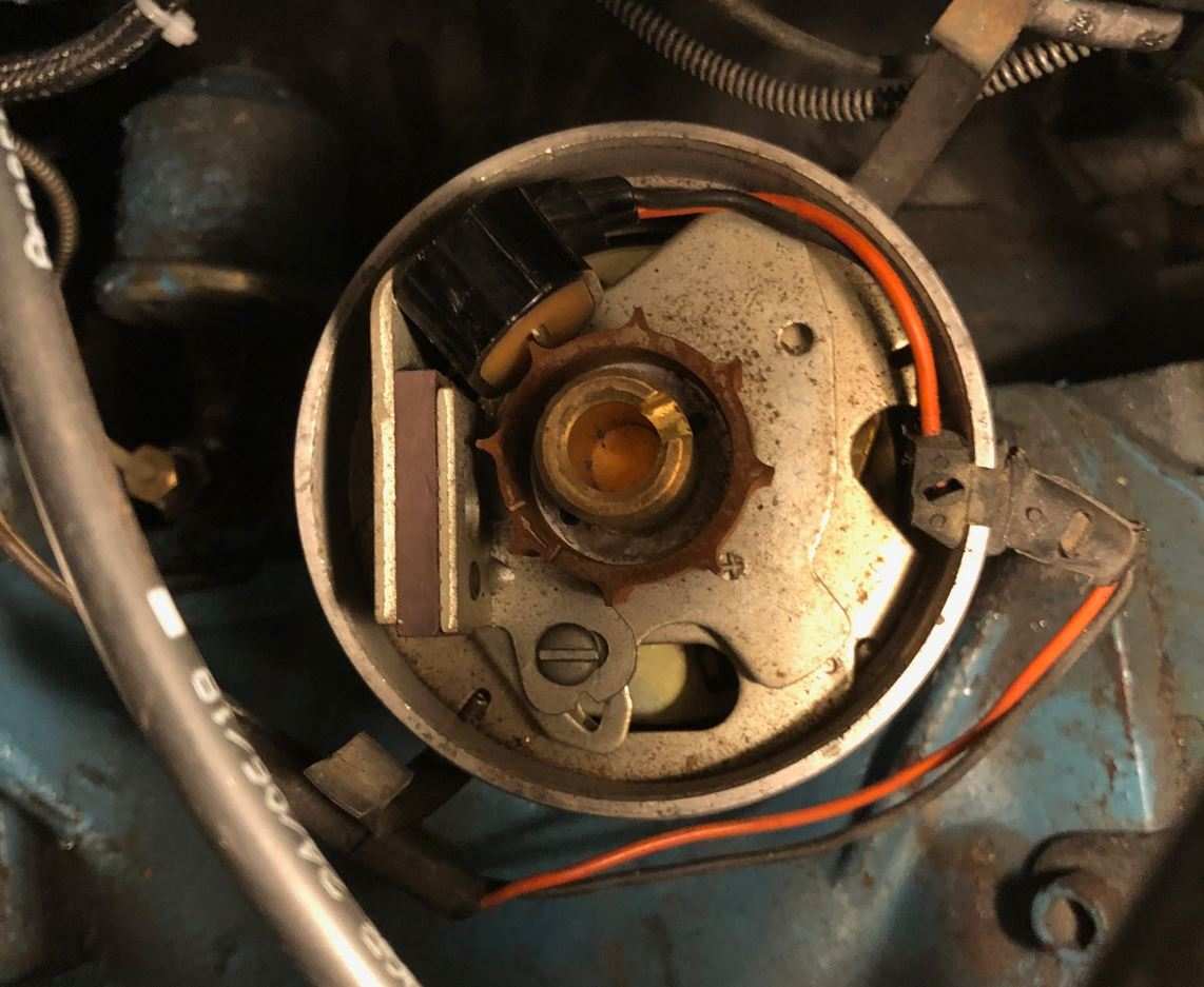

A callout to mopar distributor folks. As I continue to learn more about my (new/old) dodge, I ran across the distributor plates which appear to be sticky, they don't rebound very well unless I give them a bit of help. When I removed the pickup coil plate, I noticed it does not have the normal/removable limiter center-post held in with a clip. I'm also not seeing a screw that could hold it in, either. Would someone be able to identify would kind of aftermarket distributor this could be? Would this be worth repairing or should I just be looking to replace the whole assembly?

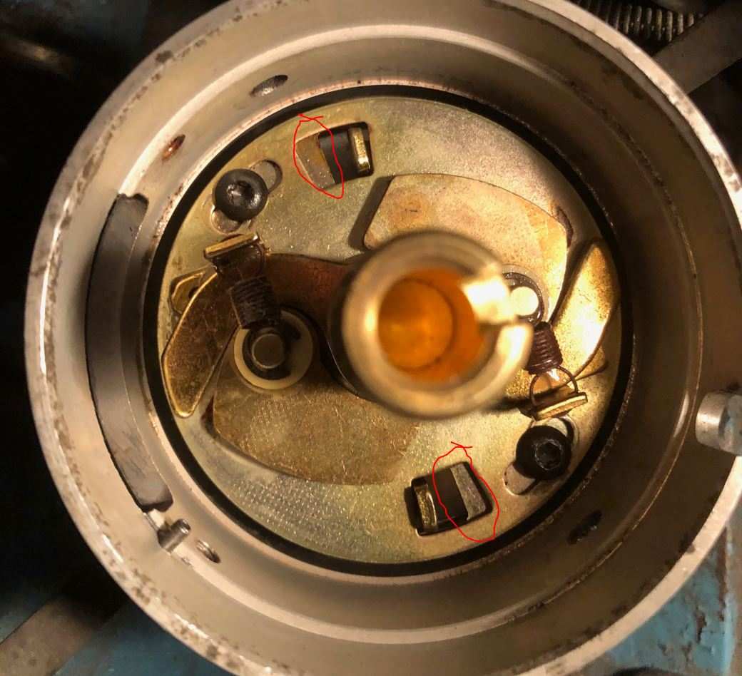

That is one of the later ones , , it is a very good dist , in the second picture there are 2 torx scrws & 2 windows , the plate can be adjusted to limit the mechanical advance once the 2 torx screws are loosened , lube it so it doesn't stick adjust the mech advance , this will allow you to use a lot more advance at idle 14-18* without over advancing at higher RPM .
If you are going to toss it send it to me !

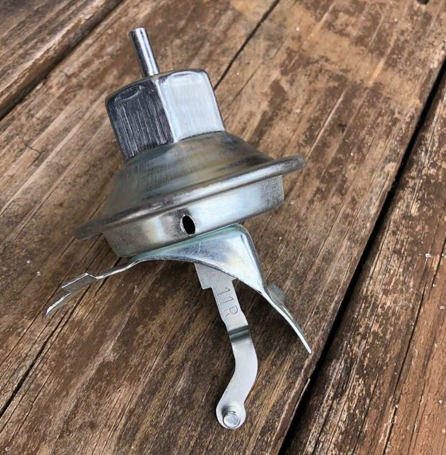

Thank you for the information. I also have a new adjustable vacuum canister that is for this distributor, it is stamped 11R. Does that mean it has 11 turns of adjustment to it? Would you have any recommendations for the initial setting for this canister?

I believe that 11R means that it has 22 degrees of vacuum advance.
And I agree with Chryco Psycho about the distributor, its a good one to have.

Would anyone know what benefit the canister could provide?
Adjustability for tuning. Say your combination runs great but pings at highway speeds. You could take some vacuum advance out of it. You may not need or can use 55° at 55.
You won't have any vacuum advance without it installed. Vacuum advance is used for highway cruising speed, increases ignition advance to about 50-55 degrees for factory iron head engines at highway speeds. Supposedly increases MPG, but as you will see, some will dispute that and claim otherwise. Its your choice as to which way is correct, but not using it is the same as saying the Chrysler engineers didn't know what the heck they were doing. :drama:

Thanks for the info. I'm going to close those limiter plates up a little bit so I don't have any surprises. The canister appears to have 13 turns of adjustment. I'll set it in the middle and see how she runs.
