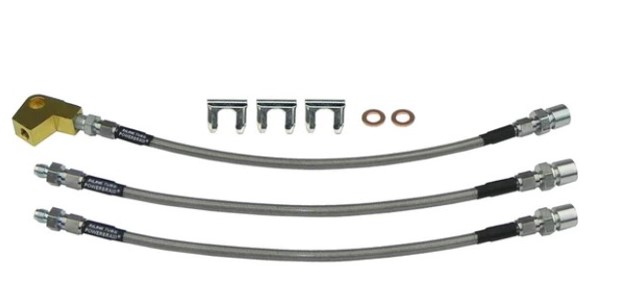

Looking for member thoughts on replacing 25 year old brake lines. Both the front and rear flexible rubber brake lines were replaced during my restoration in 2000.
I am considering replacing the rubber lines with braided stainless braided front lines from Inline Tube and replacing the single rear line to the "T" junction block as well.
I am already replacing my master cylinder due to a pedal that starts firm but slowly sinks to the floor.
The rebuilt Bendix power brake booster is also from the 2000 restoration.
Does an upgrade to braided stainless lines make sense?

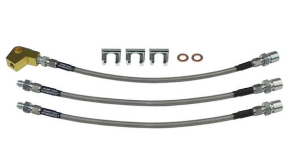

My hard lines are fine. I am wanting to replace the flexible lines to the disc brake calipers and the flexible line from the chassis to the rear differential housing's T-fitting.
The 3-piece kit below.

I have used the exact lines you are looking to buy. They fit nicely and supposedly will not expand when you press the pedal unlike the rubber lines that expand ever so slightly. They are stiffer than the rubber ones. I like the look too. Hopefully they last. Haven't driven the car since installing them yet so I'll know more in the spring.
I heard that you have a better pedal response but since I haven't driven the car since the 80's I don't think I'll notice anything...
