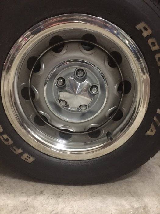

just took off my front center cap and realized that the retaining bolts for it were hitting the adaptor plate that is part of the willwood front disc package. It was about 1/32" not flush with the wheel due to this. Never would I recommend this kit, not the first issue. Anyway I just blew a hole through where the witness marks were on the adaptor and installed Alen button heads for safe keeping. All is flush now.
Before and after pics below. I'll do the remaining three when I return from abroad in a couple weeks.
The old ones can be donated to whomever needs a set. The front two are missing the press in centers as hey popped off during driving all due to the interference with the willwood bearing cover. Gesh.
