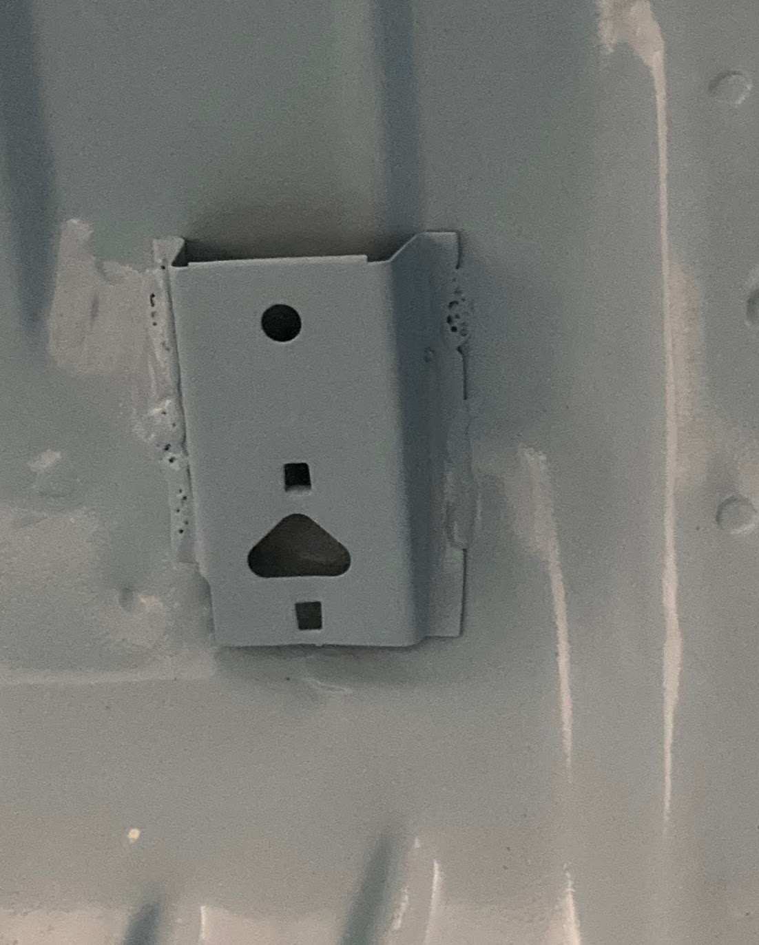

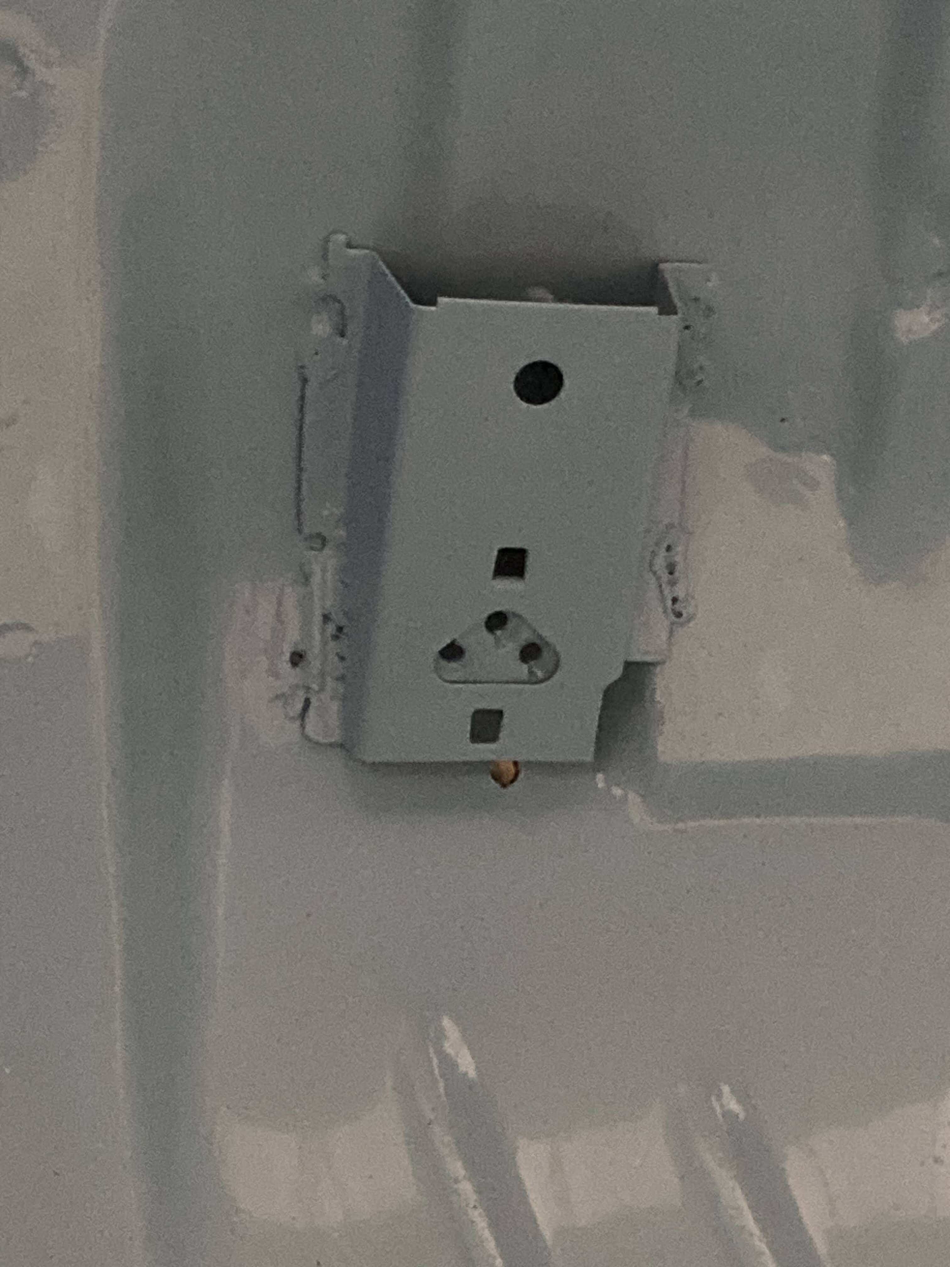

Hey everyone. I was installing all of the body plugs the other day and I noticed that I am missing one of the upper back seat nuts or nut plate that is needed to hold the upper back seat in place.
Has anyone lost one of these and used anything else for it purpose? Does anyone know where I can get one? Thankj

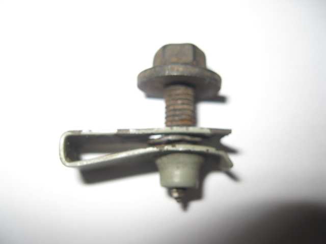

Not reproduced. Find a a donor car and pop it out. I had one missing until my Dynacorn 6000WT was installed. The second picture was my MacGyver replacement until then. The clip slide in from the bottom, it was long enough for the threads to show through the triangular hole.
