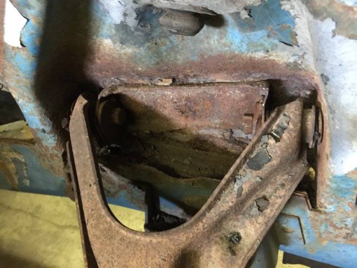

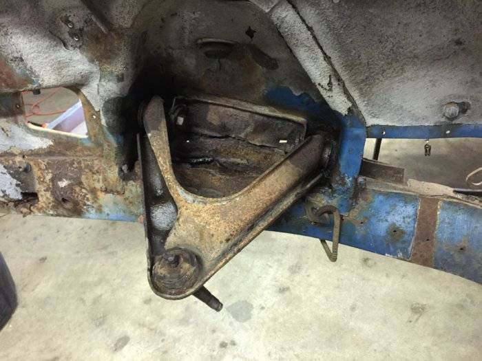

Hello all!
I just removed all of my suspension for a frame rail replacement. I can’t seem to get the bolts that hold the upper control arm to the shock tower to budge....all four of them. Any advice? I am replacing both shock towers so is it worth just cutting the arms out?

If you heat the nut up to red, it should release its grip. Can you get an impact gun on it? Engine is out right? So 3/4" socket on breaker bar and another two foot long cheater pipe. Sharp impact from a 5lb+ hammer is your friend. If that won't do it, cut the nut off with a grinder. I'd hate to catch the car on fire or blow a hole where you don't want one.

I do have the nut off, the bolt is just stuck in the bushing sleeve.
I’ll try a little more heat next time I am out there. I don’t think they are going to budge...

Hammer time. I just removed one of these on Sunday. Mine came out without a fight. But if the nut is off, then you should be able to get a hammer on the end of the bolt and tap it out. I'd bet the eccentrics are rusted to the bracket. Maybe try putting a wrench on the bolt head and work it back and forth to loosen it up.

Just went through this.
Tried heat, marginal success;
Tried kano aerokroil
Industrial strength with the extra silicone
Sprayed several times over several days and used a hammer to tap them out.
Let the oil do the work.
Worked great with minimal aggravation.
Works better then the CRC and other penetrating oil brands. i mail order it from the factory.
Hope it helps.

Been through this before. Spray it with PB Blaster or similar penetrating oil of your choice and then use an air hammer with a nice, pointy chisel. Most likely will ruin the cam bolt but it should come out. The vibration of the air hammer is a huge help in freeing the bolt from the rusty grip of that bushing sleeve...
