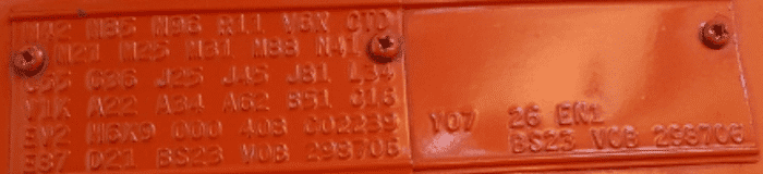

Caledon, ON
This is the tag that was posted with the add. Hope this helps... are they saying it's a copy or fake? Is there any other cuda's similar, that have the correct paper work, tag etc that could be used for reference price. Not sure what to look for on the tag to make sure it's original and besides pitting but it seems to be well paint it over?

Between the coasts
Tag has an awful lot of codes shown, hard to verify without a broadcast. There are no apples to apples reference points. More like oranges to tangerines with a lot of looking and learning. Glad you're doing your homework though. Best place to ask is over there. Maybe hire a second set of eyes to go there with you.
