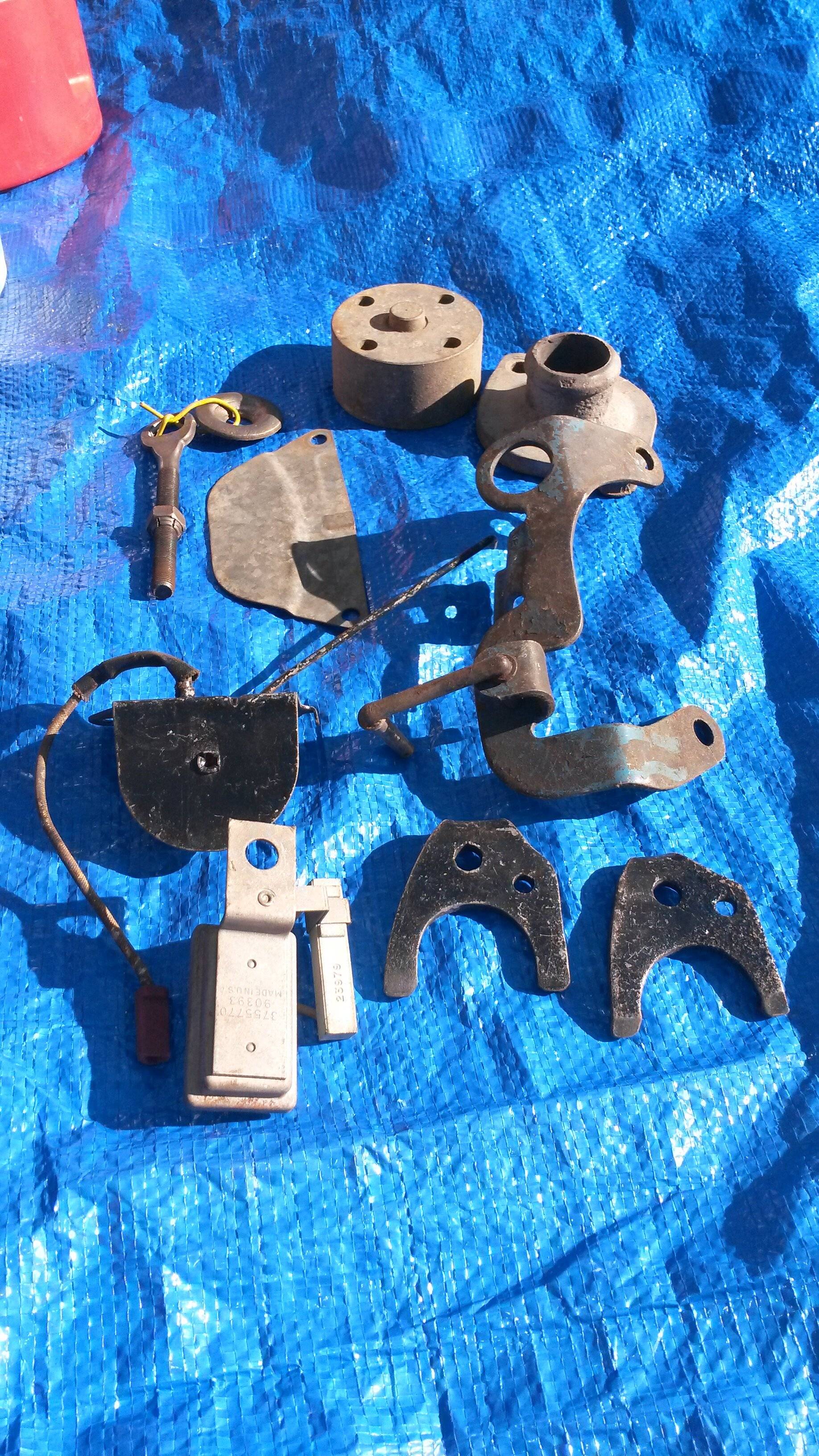

Mine is set up the same way on my 440. It is easier to have the pcv valve on the passenger side as you don't have to go through or around any of the throttle/kick down linkage.
Was this the work around? I think the bracket was off a 400.
