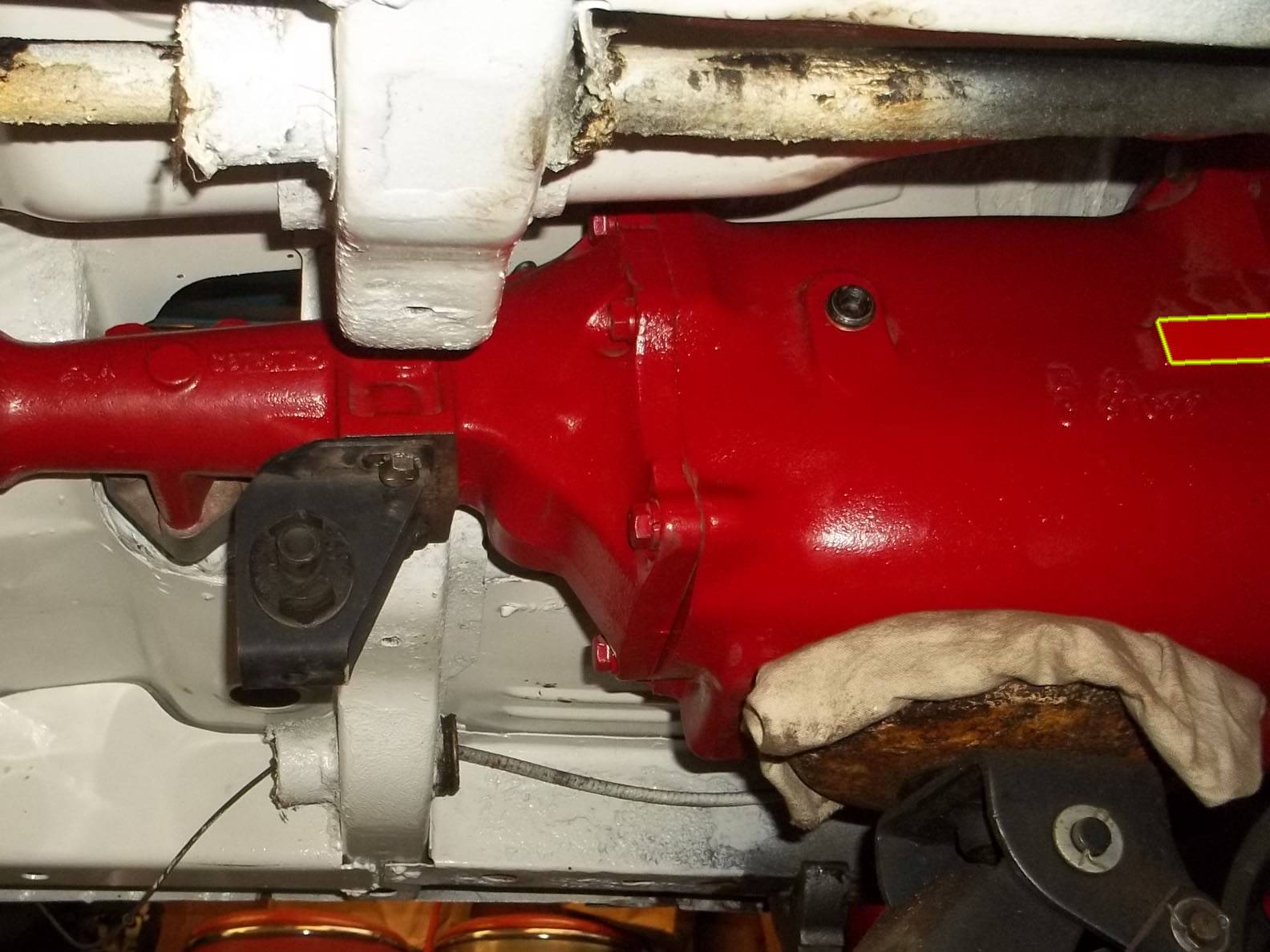

There's a large raised pad on the passenger's side of the transmission. It's viewable from underneath. A ScotchBrite pad and some brake cleaner are your friends to get it cleaned. The highlighted rectangle at far right is part of the pad on my Valiant's A833:
Obviously that's an A-body transmission but the main cases are the same. The pad is always in that location.
The pad will have "PP833" and some other smaller-font codes stamped on it, and in larger digits should be the last 8 digits of your dashboard VIN--the year, the plant, and the sequence number. Using one of my old Chargers as an example, the stamping read "3A201395": 1973, Lynch Road plant, sequence #201395 (lowest number possible is 100001). The ID pad did not exist prior to '68, so if there's notihng there the transmission's been replaced. The same goes if the PP833 codes are there but there's no partial VIN--that's the hallmark of a service-replacement transmission.
The stamped number should be the same on the engine, located below the distributor.
