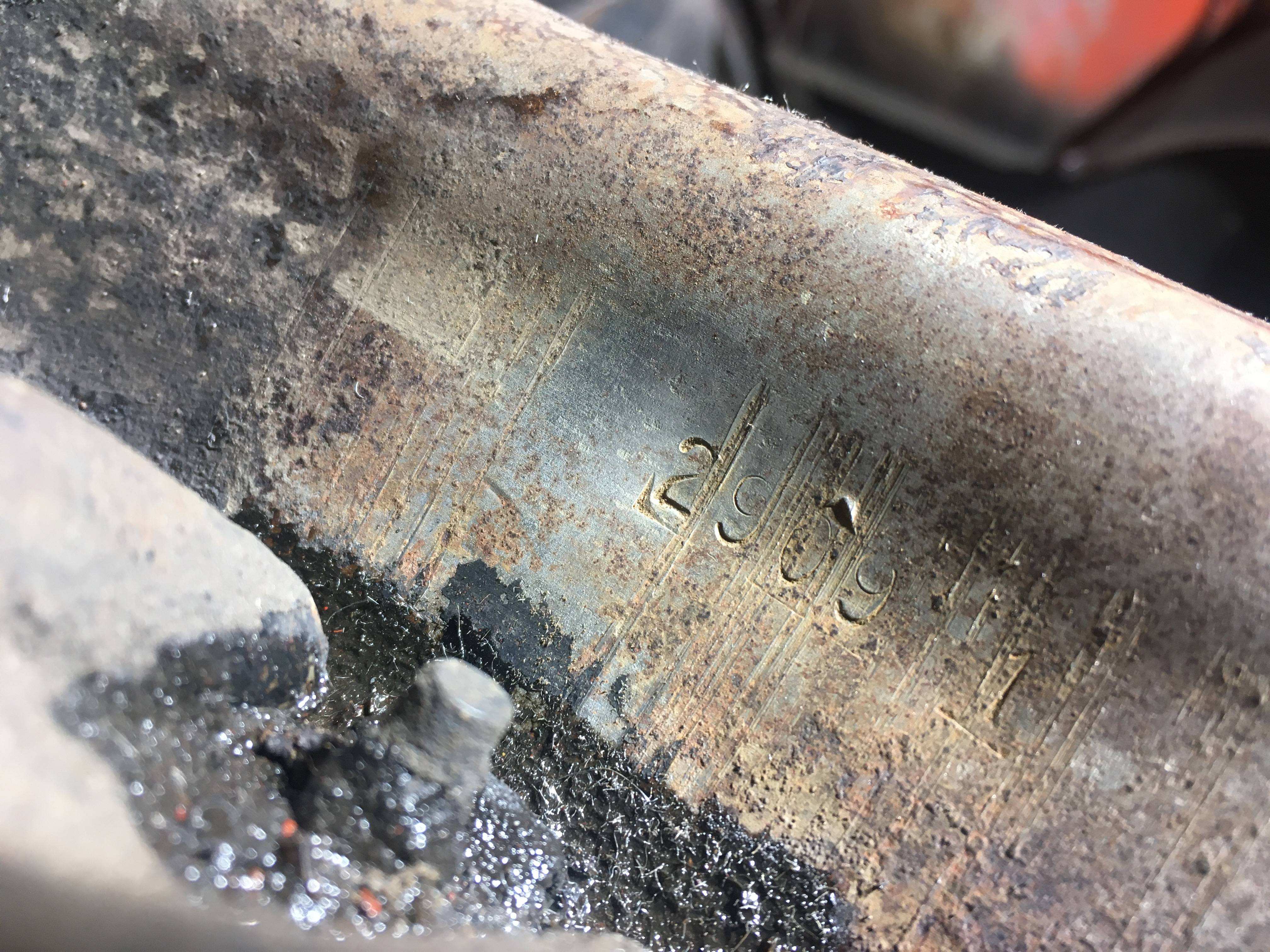

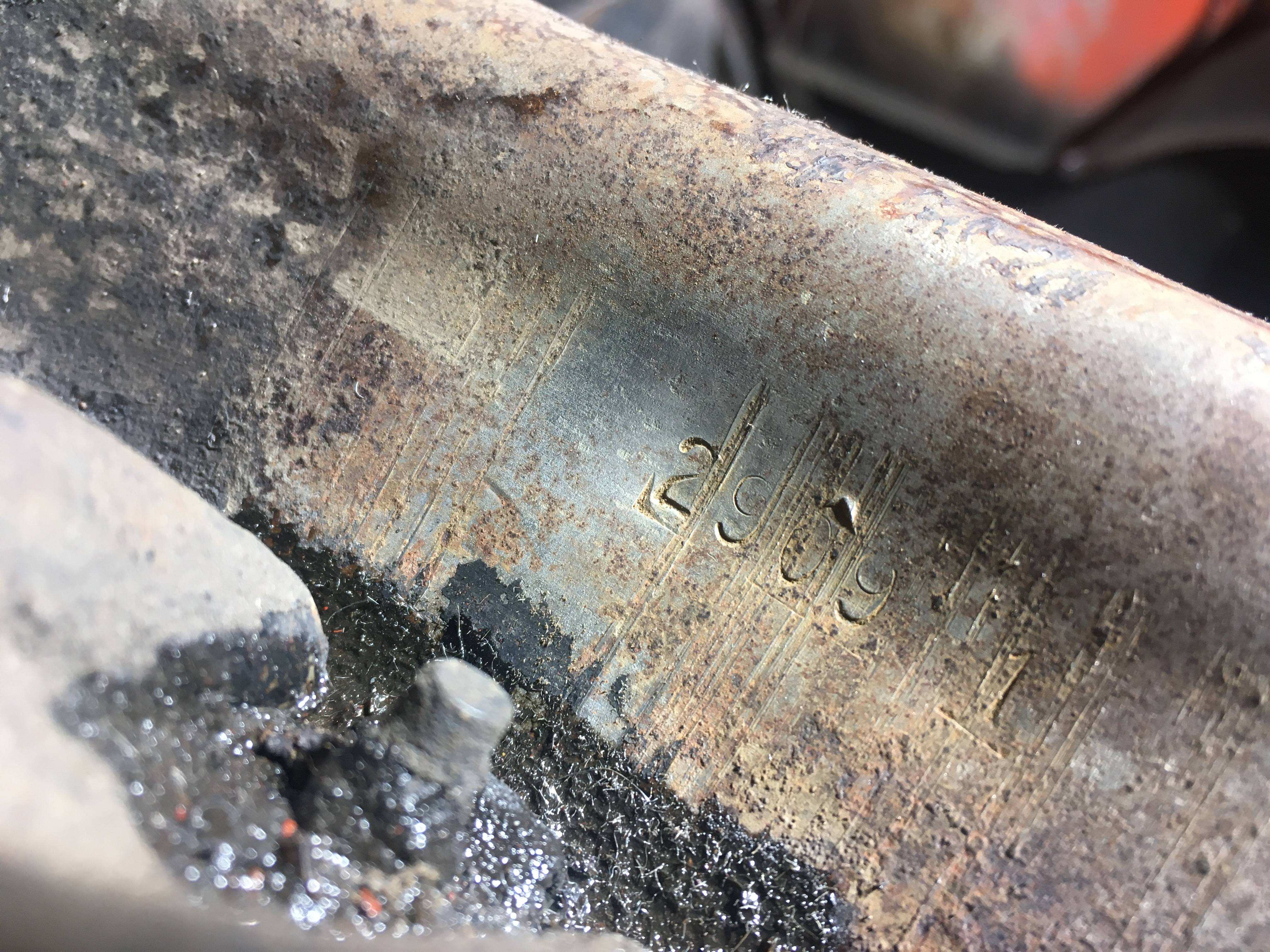

look on the front of K frame. That's about as close as you can get if it's there.

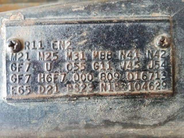

I have a BH23C1B126*** born on 909.
BH23G1B104681 is 812.
Unfortunately you will never know the actual date unless you locate FT, BS or factory paperwork.

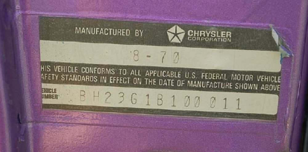

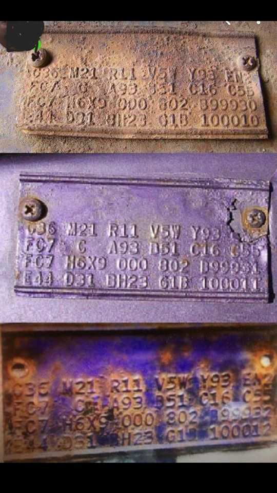

Early 1971 BH fender tags from August 1970. You cannot guarantee that your 102123 was built in August but it is most likely an August production date.
That Door VIN decal date should be 8 - 70.
Production was past 114XXX (over 12,000 cars above your sequence number) by the end of August.

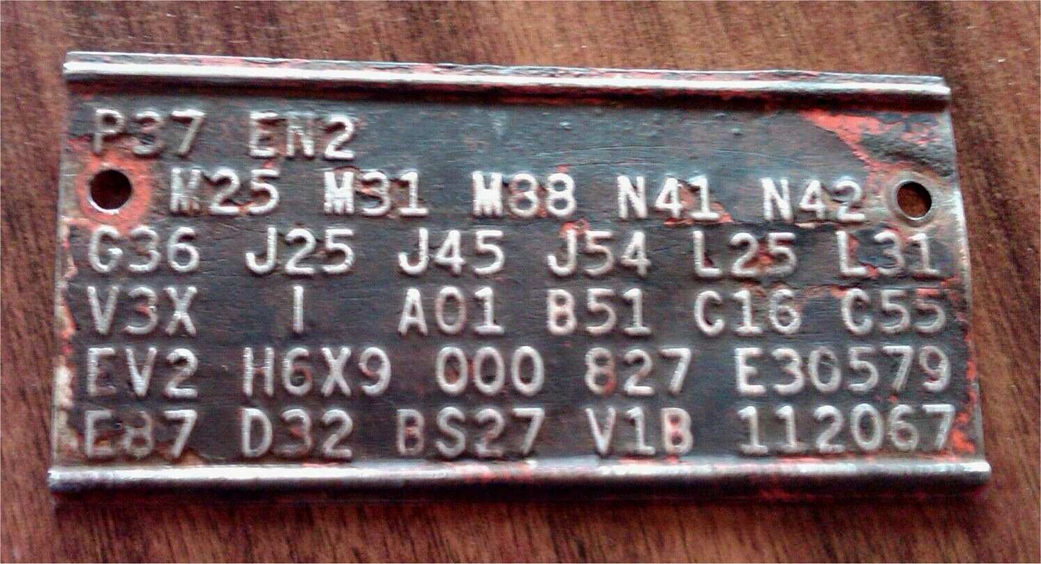

101088 is 807
102141 is 808
so I think there should be August on the decal
