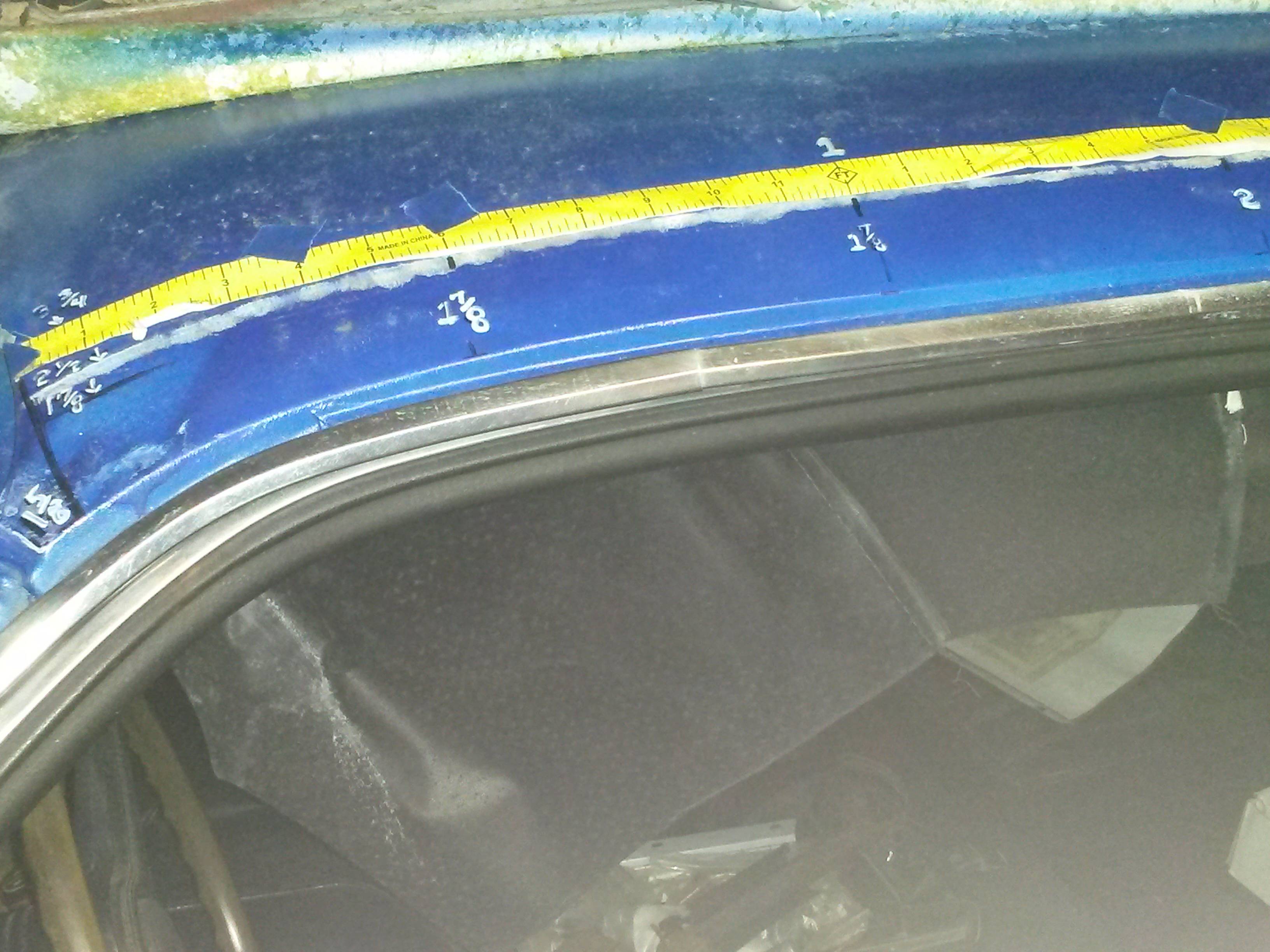

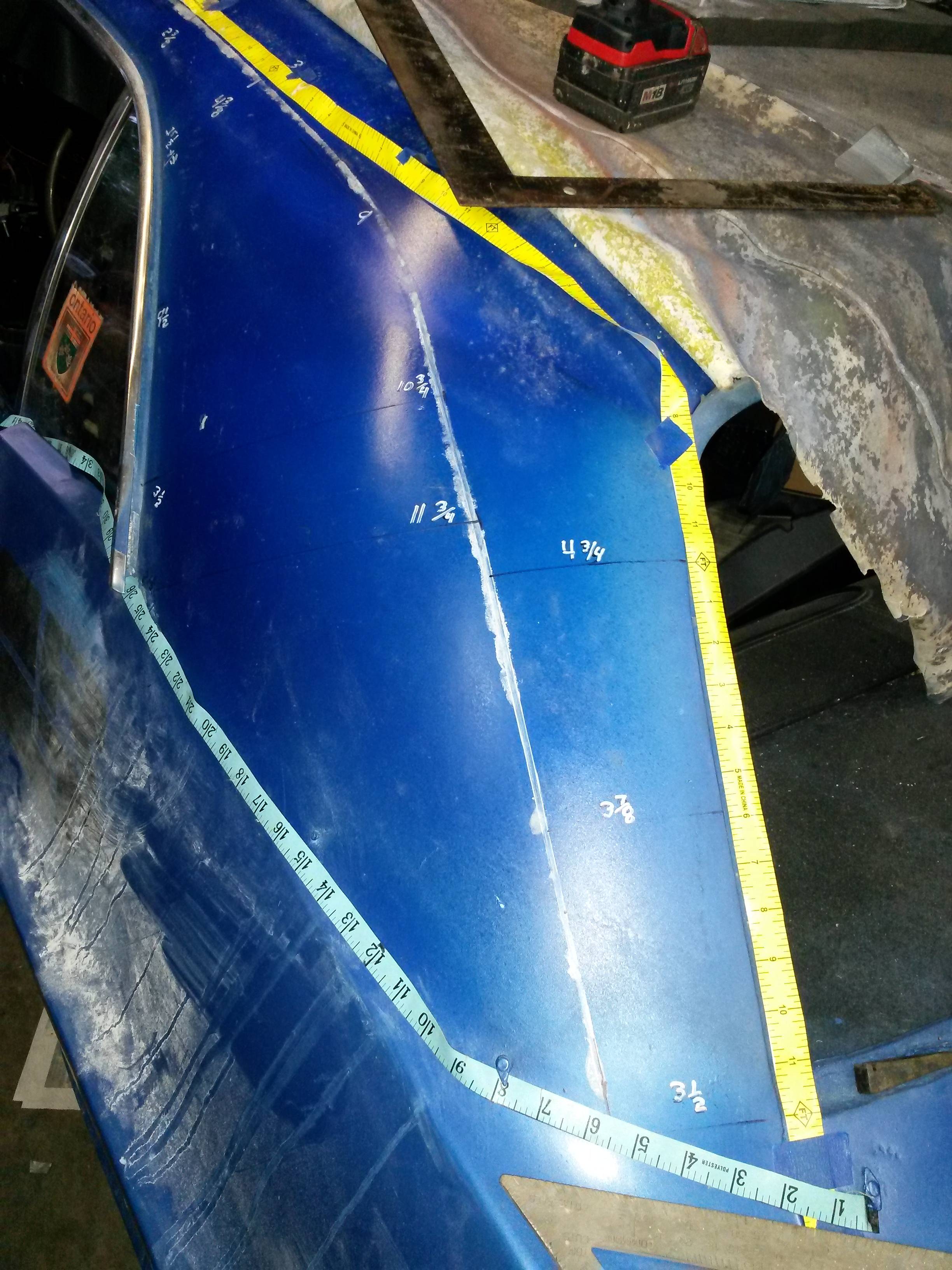

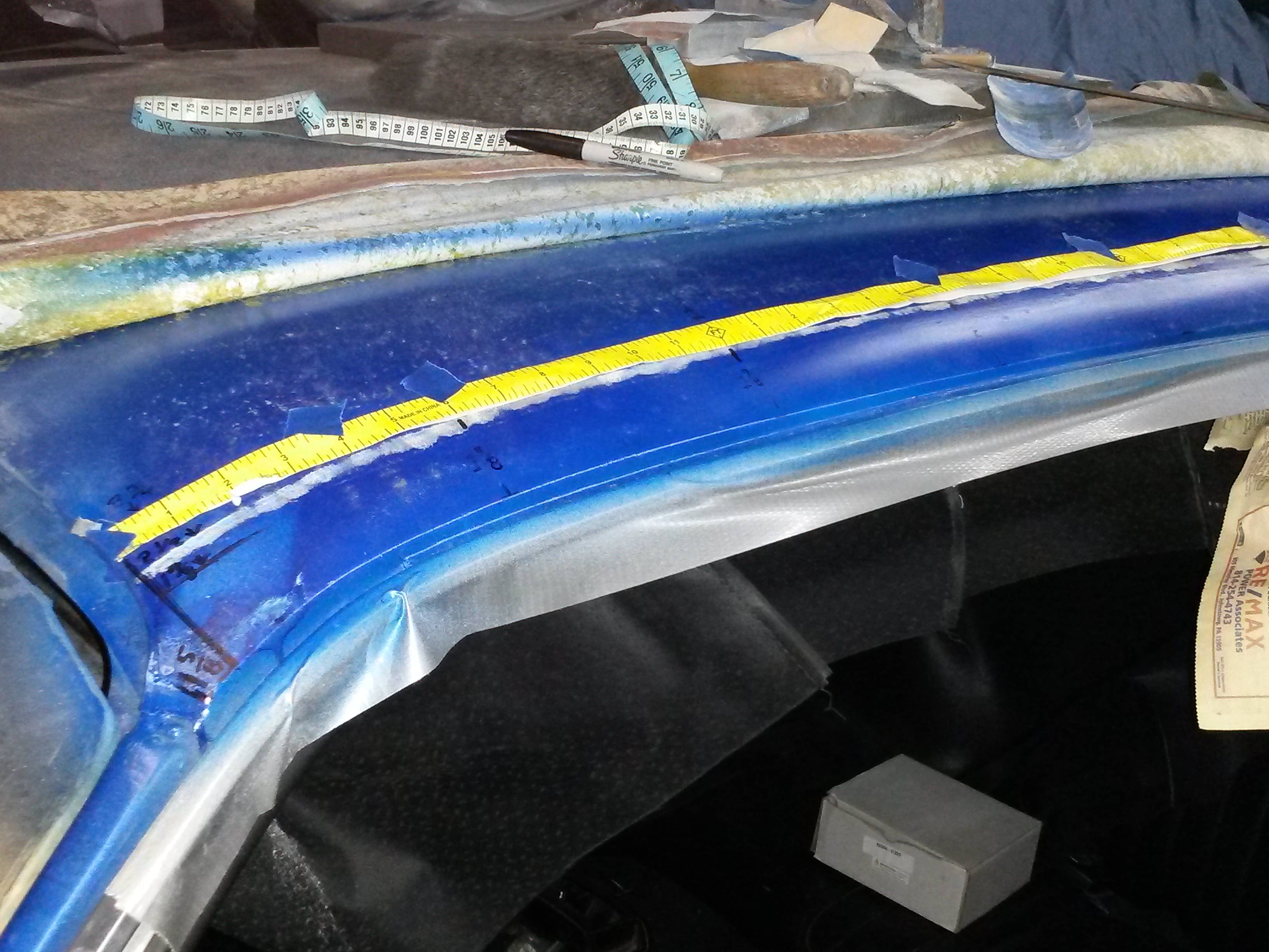

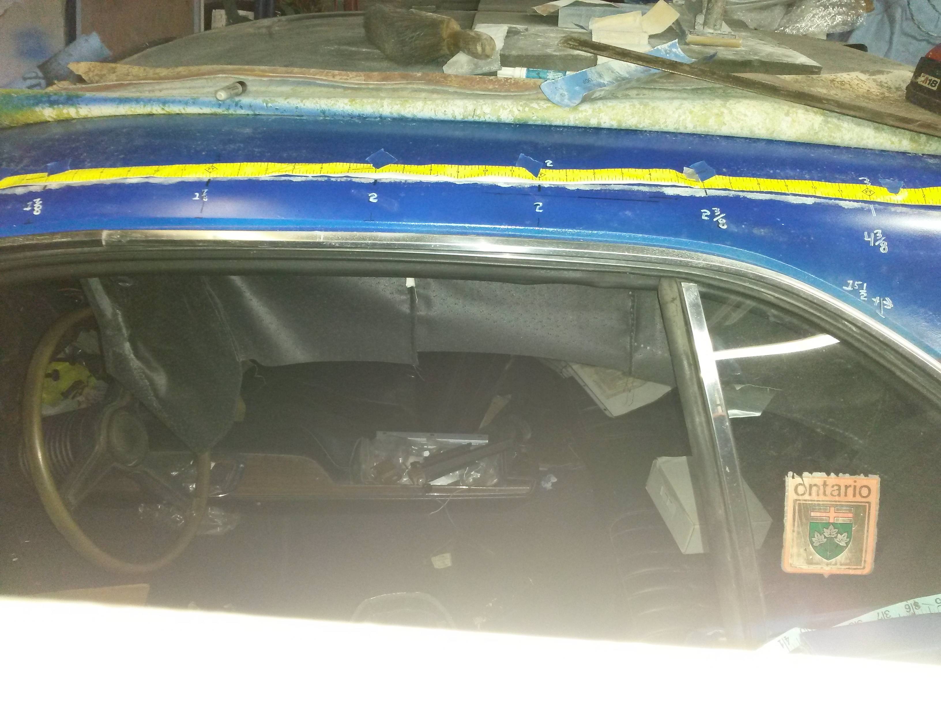

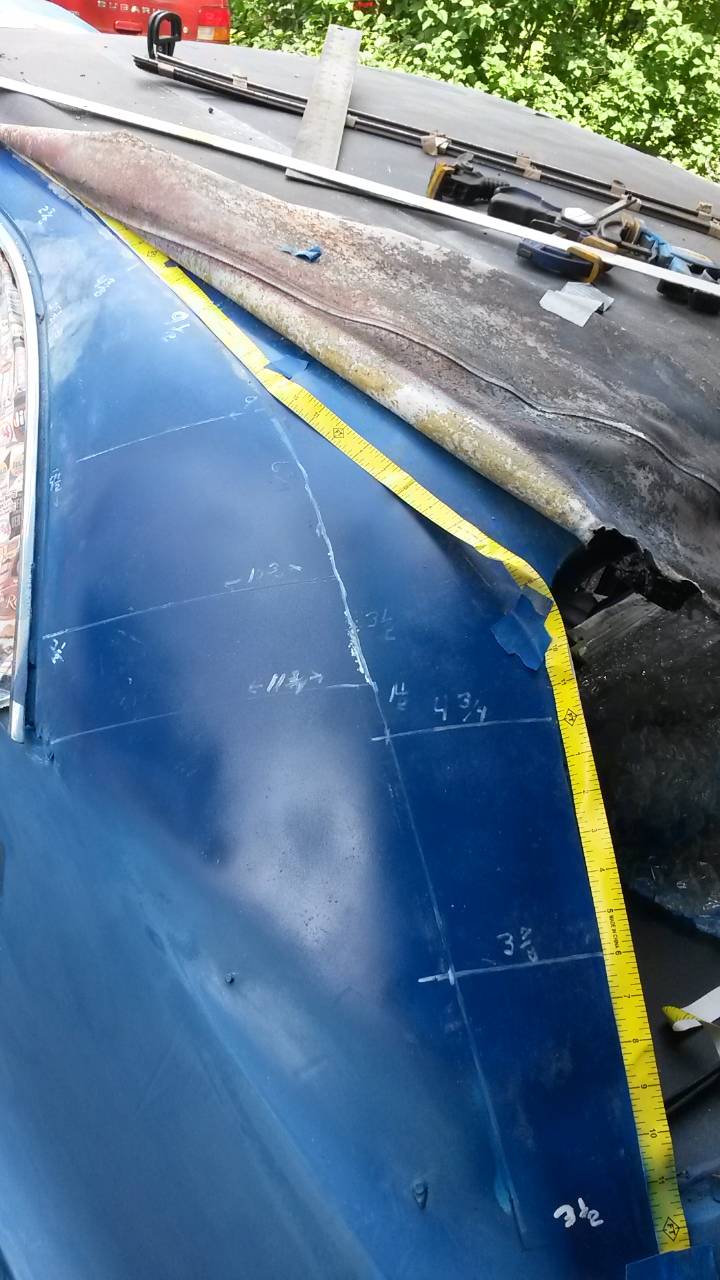

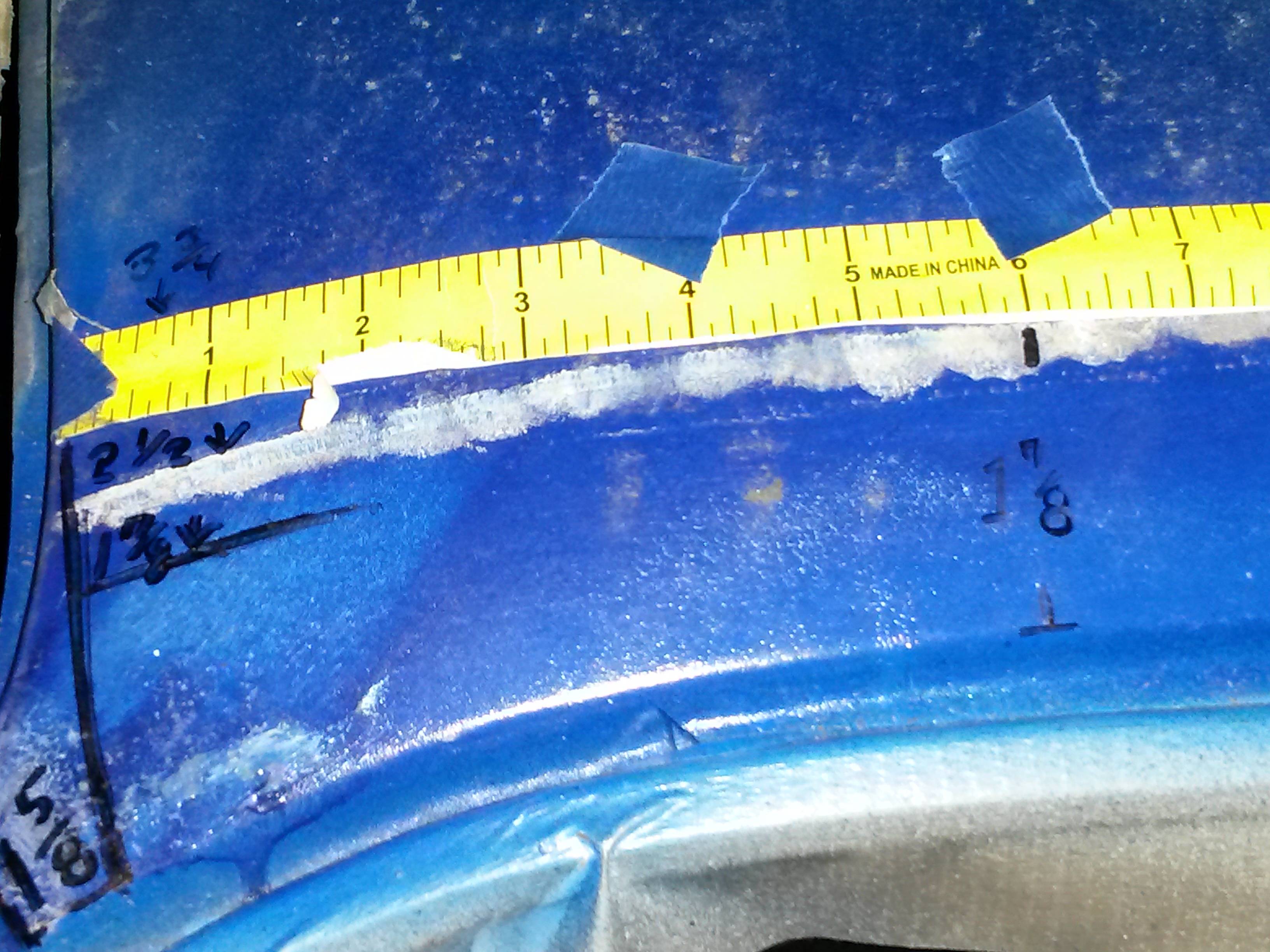

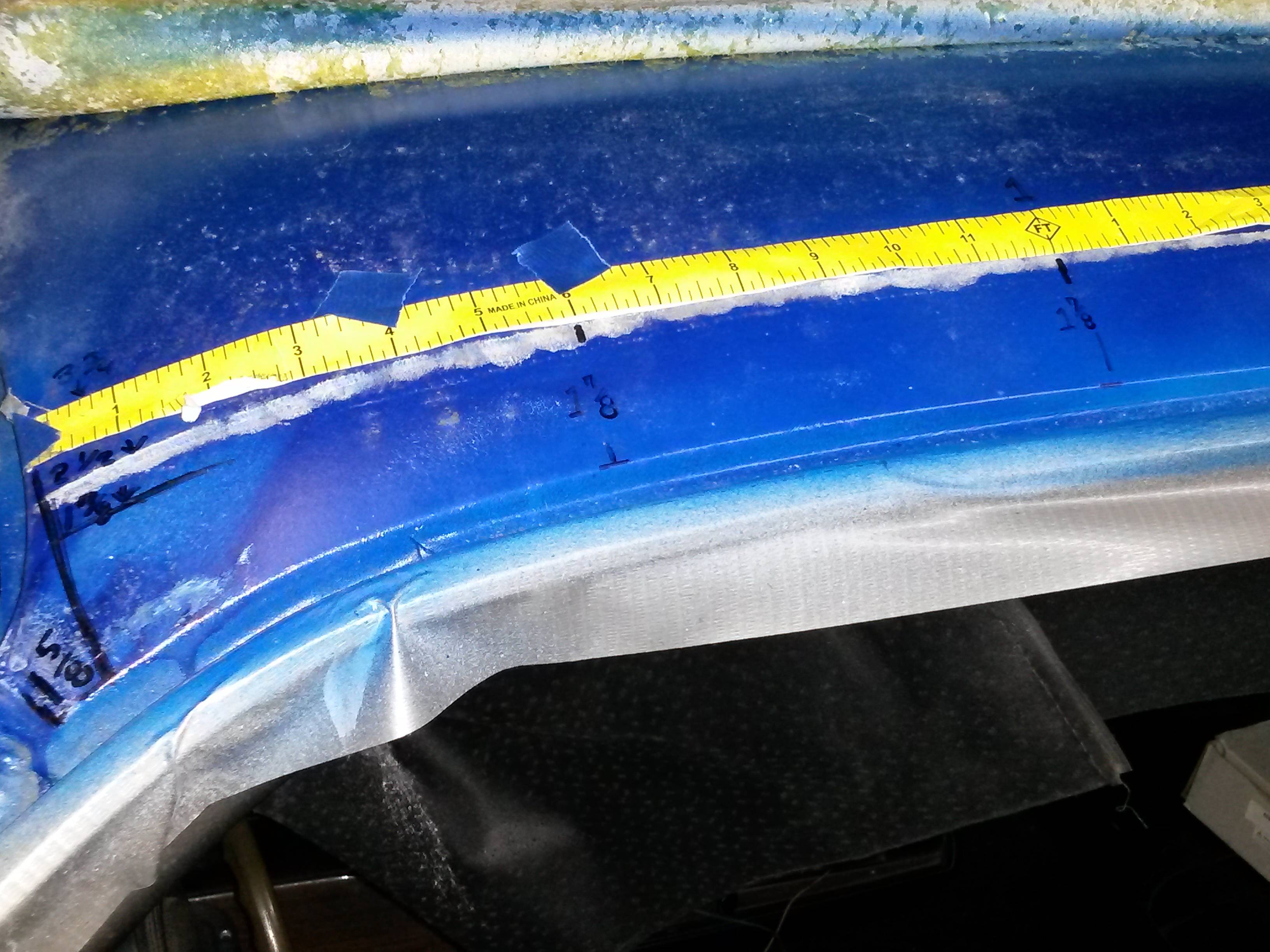

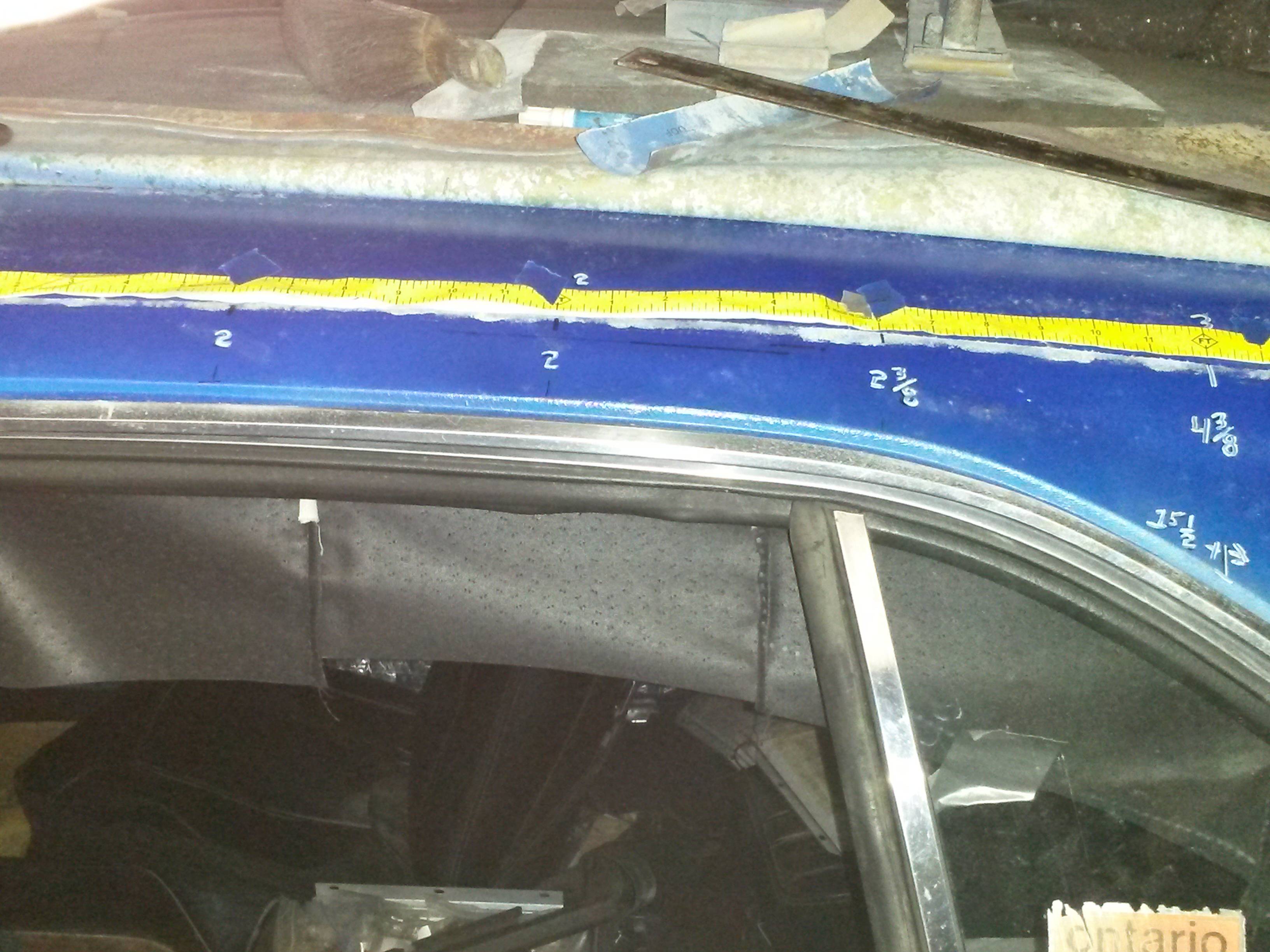

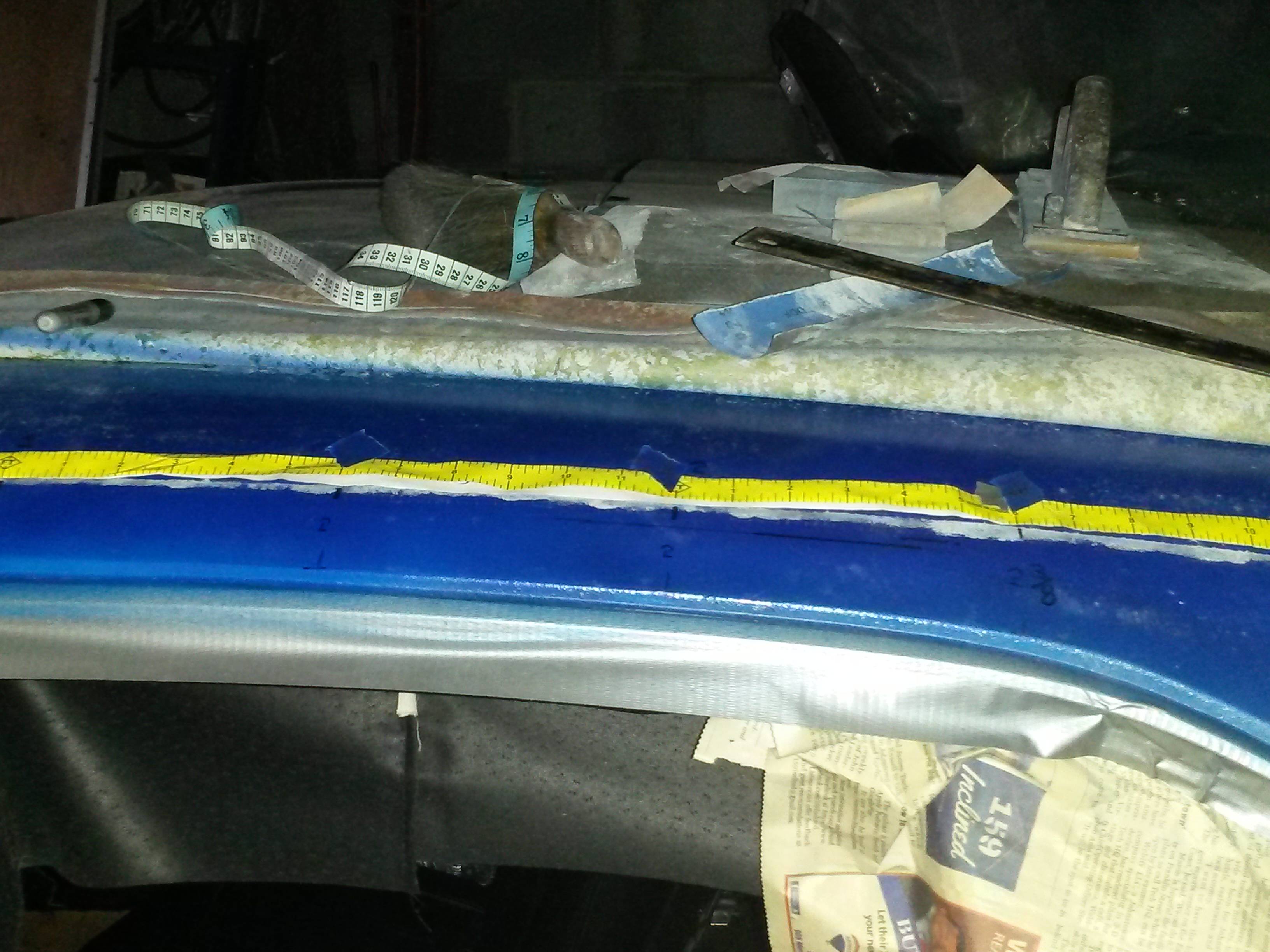

Install vinyl top.Some details and measurements that might help.The inside of the inside of the white line was established with seam on end and drawn. The black line is the outer edge of the seam with the vinyl lifted up and drawn.Used a framing square in drip rail to lay out on sail panel, speed square along inside rear window. Click here: VINYL TOP 2
