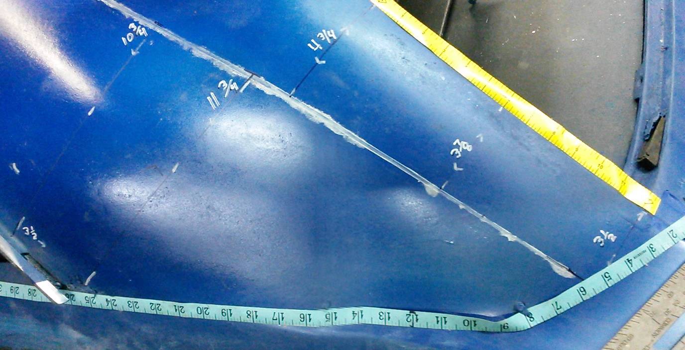

Found a post where you replied to guy in 2018. If you search in trim an search for
Location of Vinyl top trim holes​
It comes up with pictures and measurements of where the holes should be

I originally used measurements from someone on a different site. Several holes were way off. I figured out i had to lay my trim on the car, tape it down in the best position possible and draw along the edges onto the car. I was able to get my holes better placed, but had to weld in several mis-located holes from someone else’s measurements.
