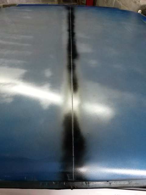

First of get the top out of the box. get the folds out of it.My roof was in good shape. removed some small rust spots on the sail panel and along drip edge area. Treated with SEM Rust Mort. Put a coat of primer and paint on. I used KBS Diamond clear because of the high heat capability. I also had USC 2K spray Max clear. paint a center line. If your roof needs extensive work use a 2k primer and finish off and scuff up.

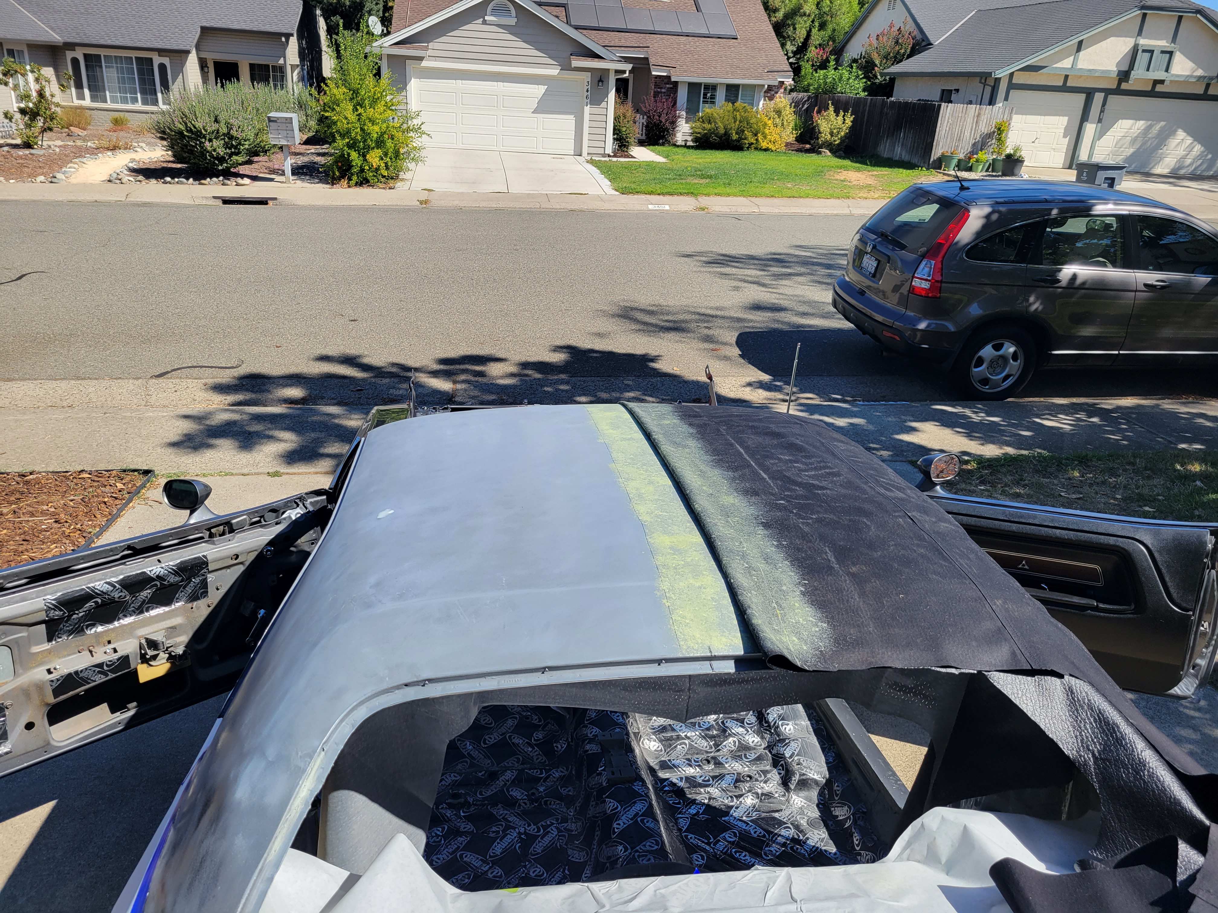

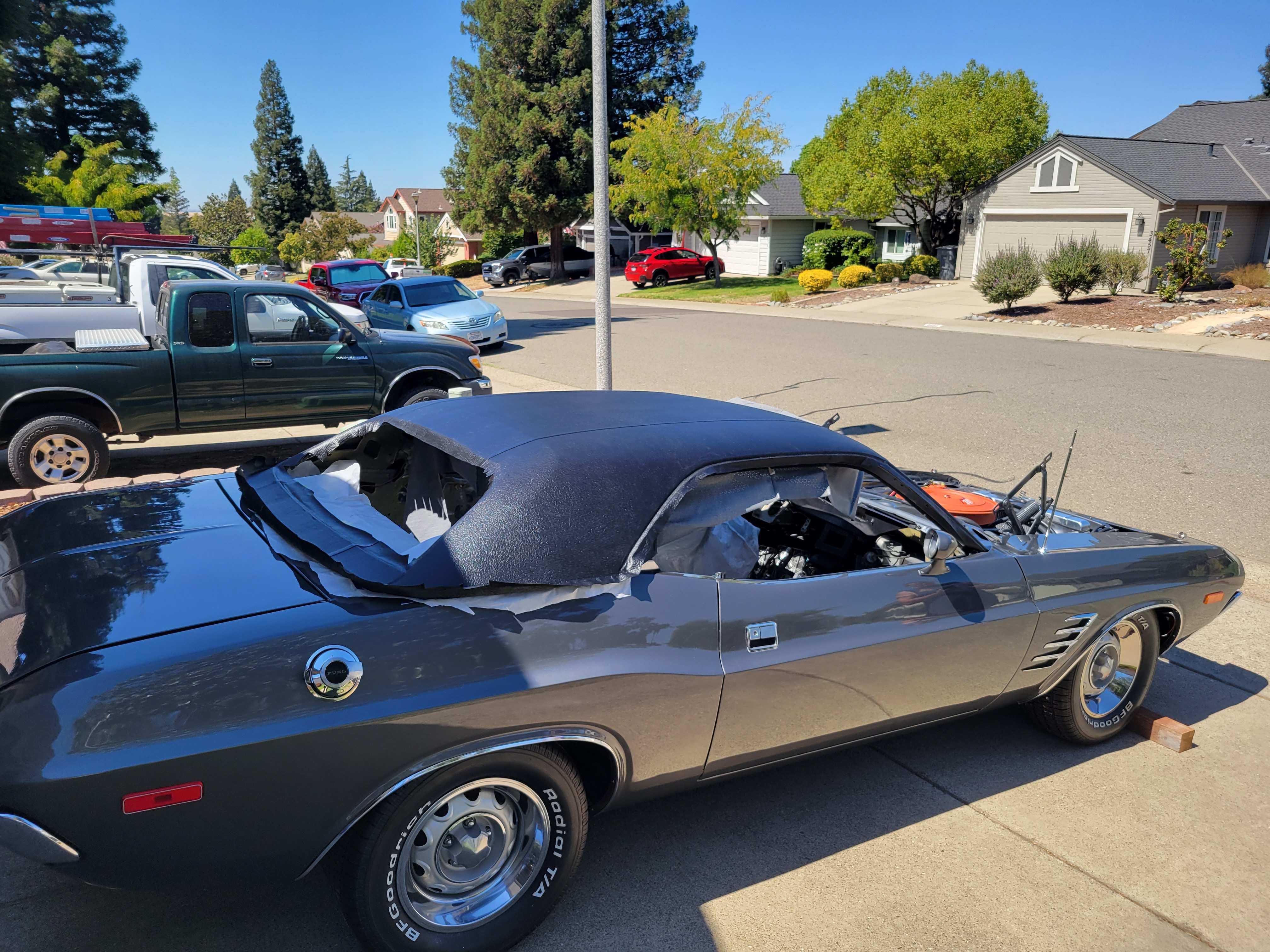

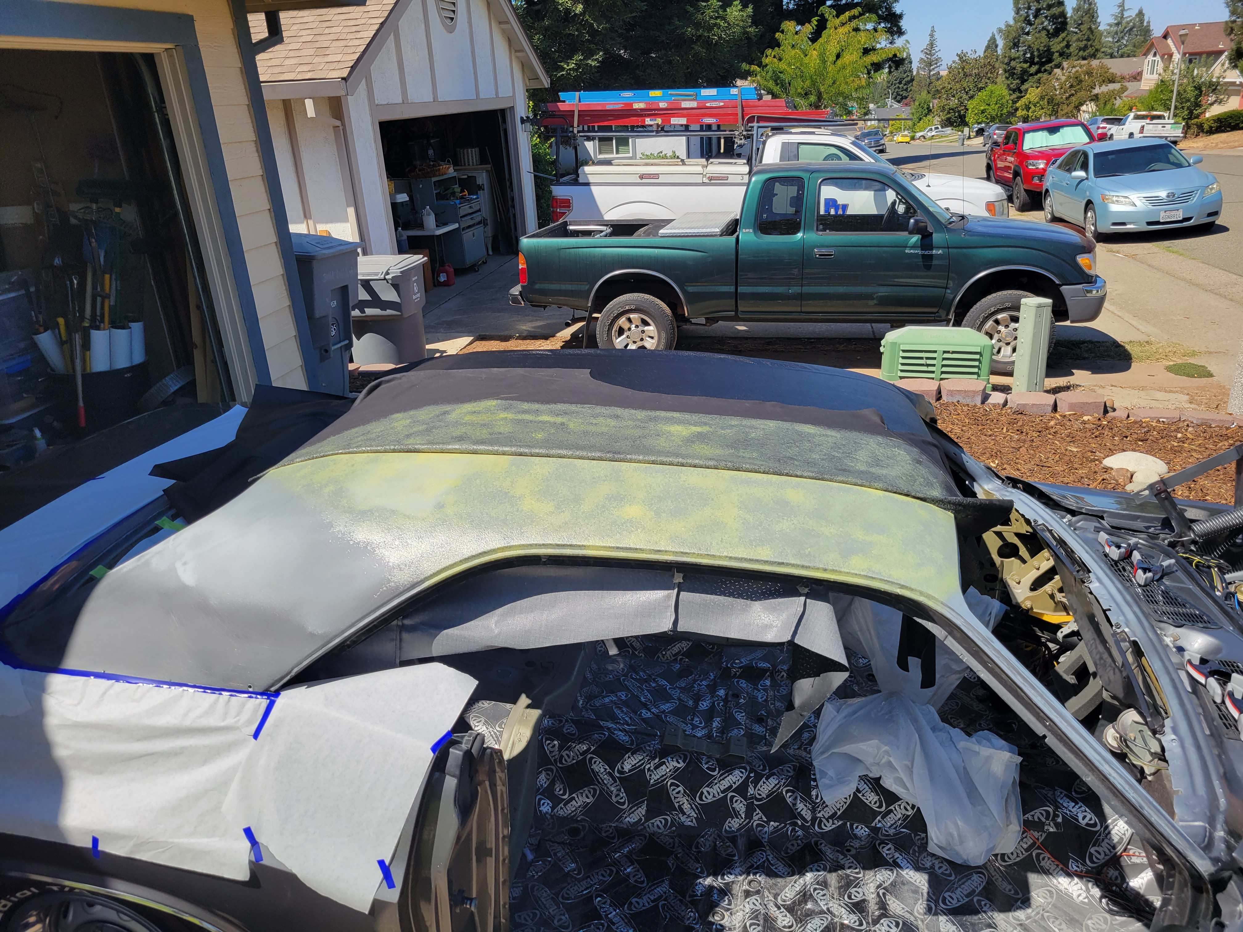

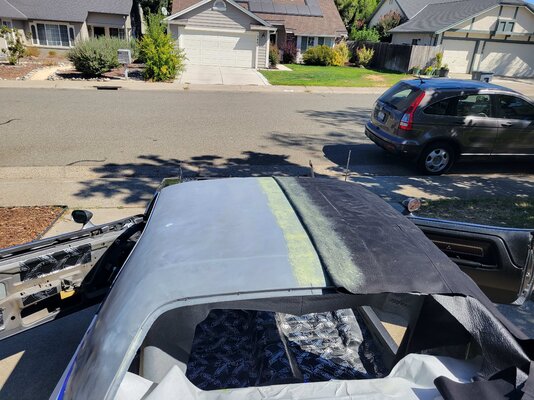

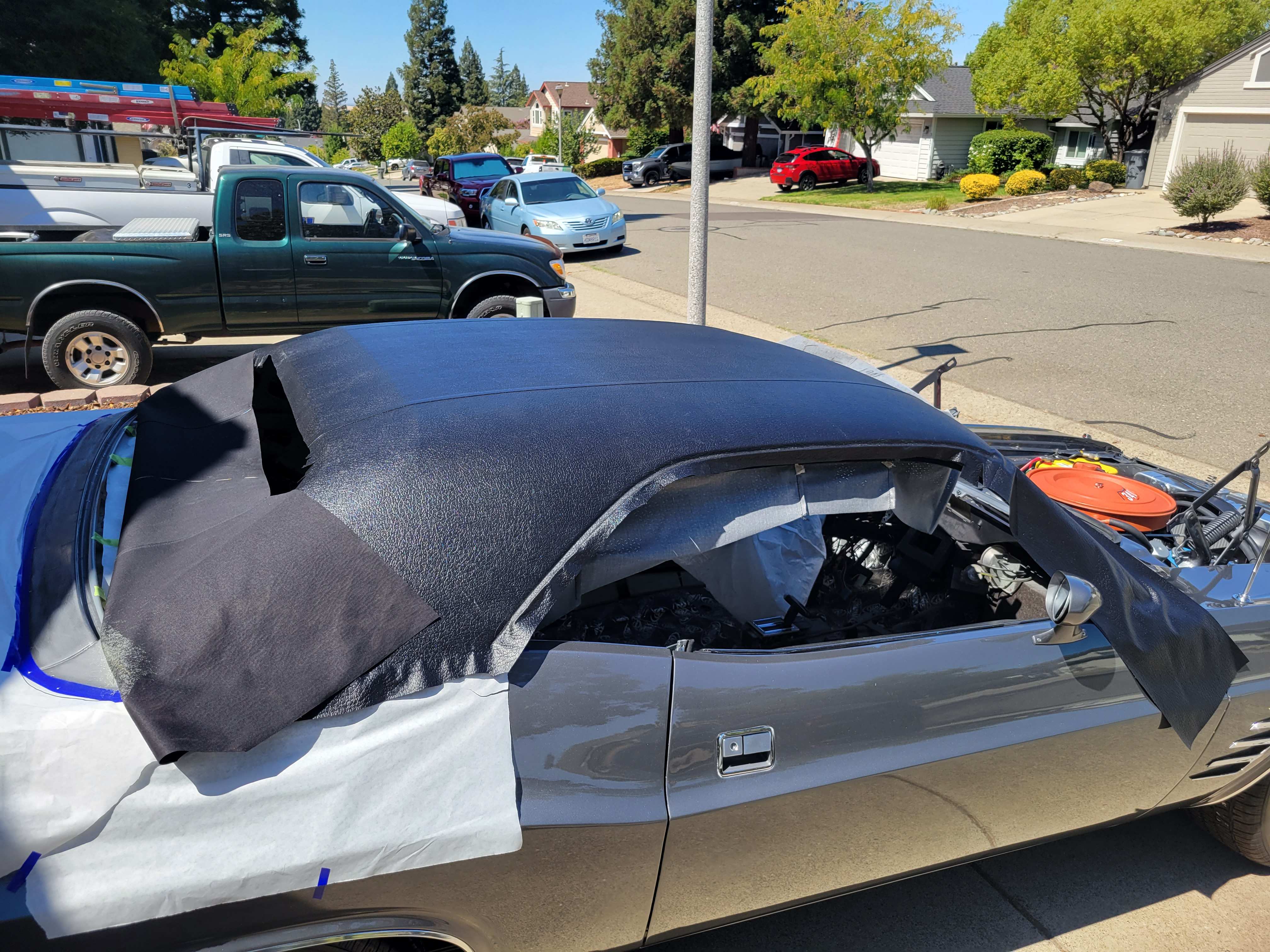

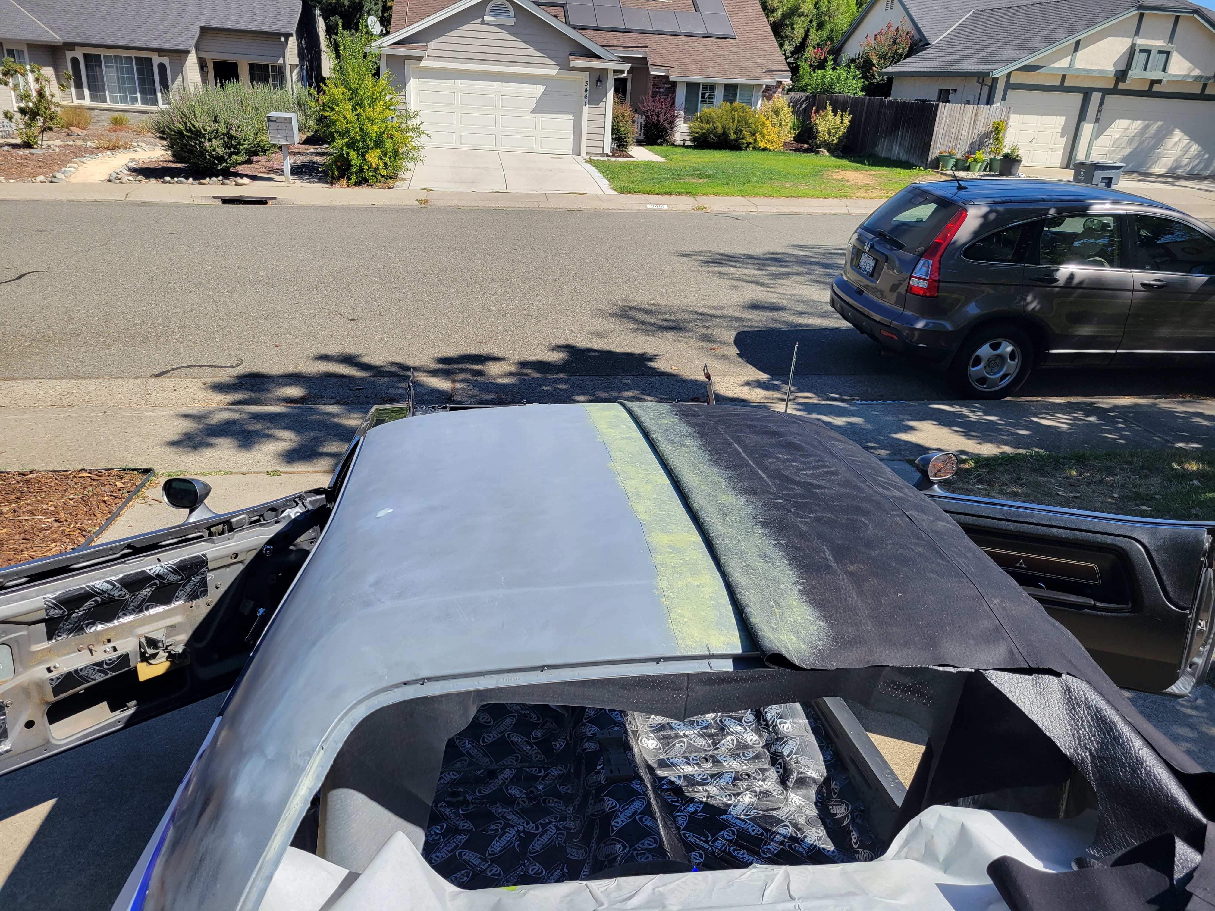

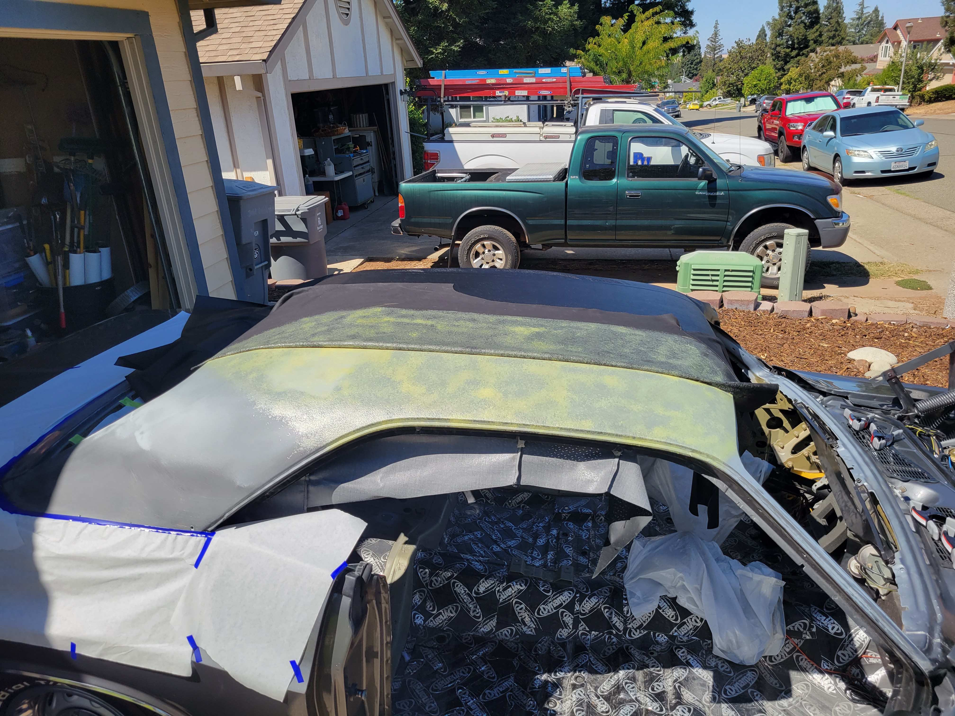

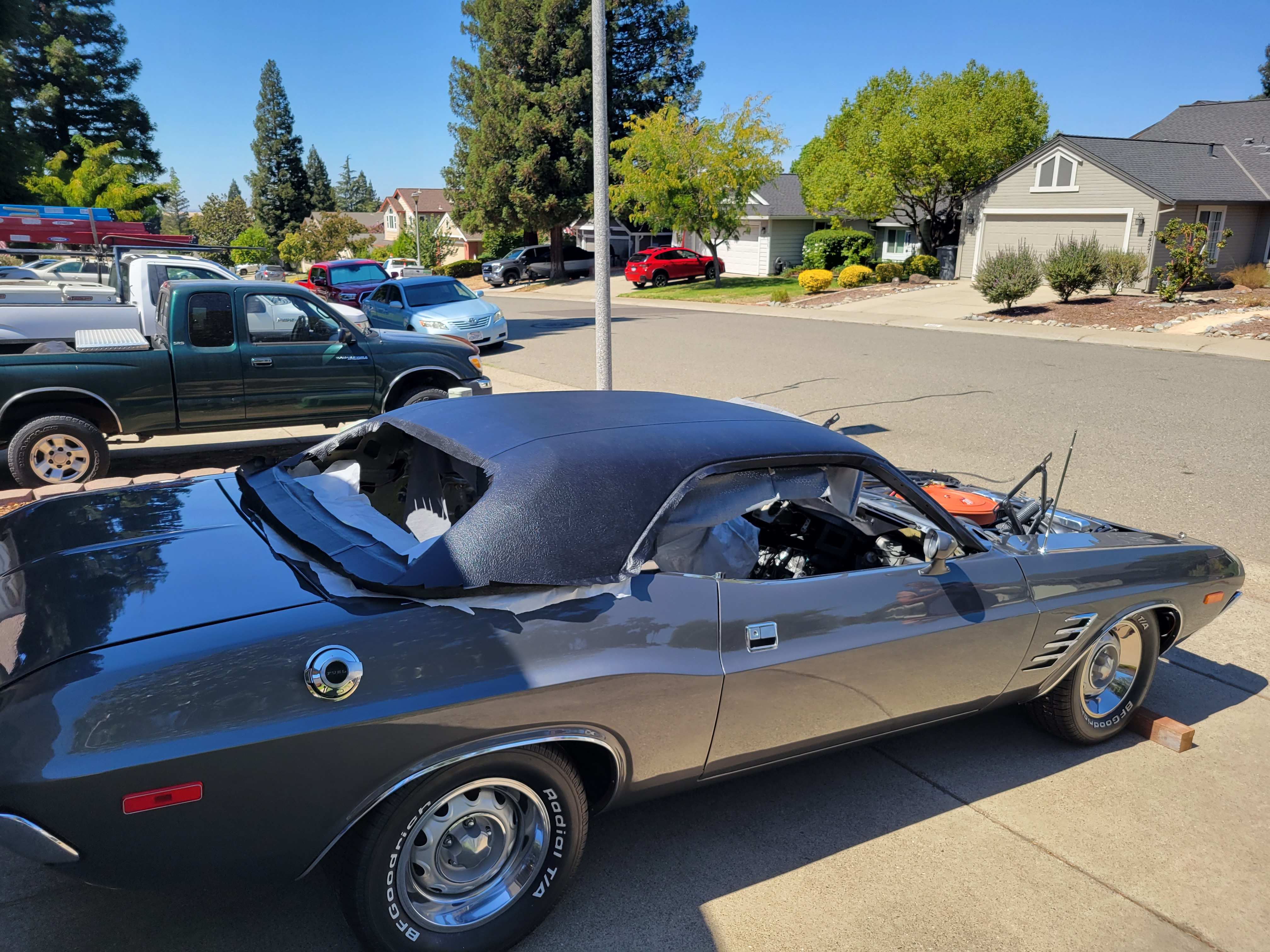

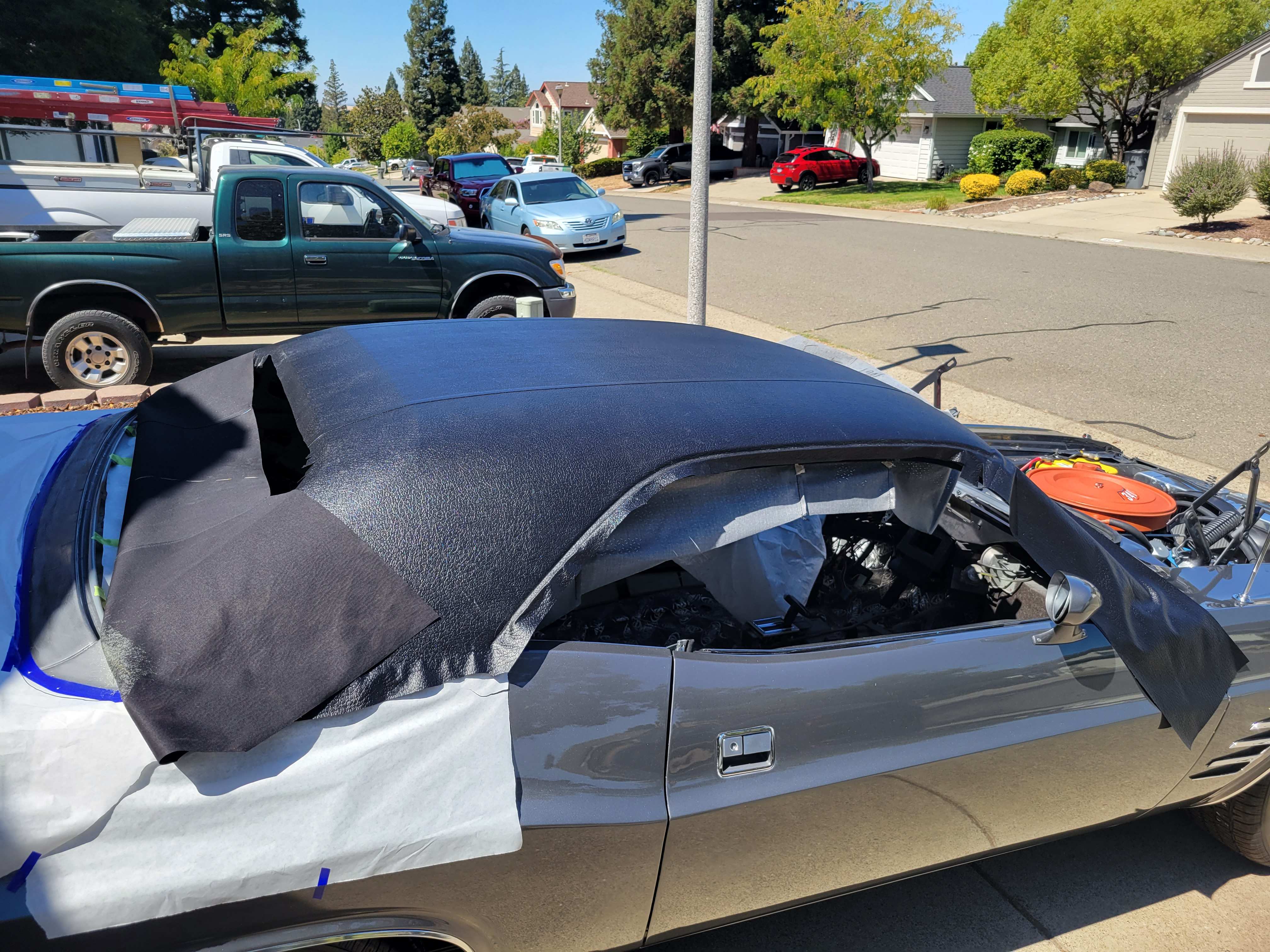

I watched many YT videos on how to install the vinyl top. I taped off the area where the top goes and used a fine sandpaper (forgot the grit) in that area so the glue had something to "bite" too. Determined exact centerline of the vinyl top and the roof for perfect alignment. Then had help from a friend that had the proper spray glue gun. Best to do on a hot day with a lot of sunshine.20220904_111050.jpg20220904_121121.jpg20220904_131214.jpg20220904_134050.jpg
