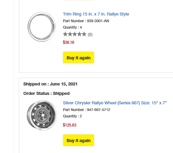

I recently bought a set of US wheel rally rims 15x7 and a matching set of wheel vintiques beauty rings. These rings just do not fit on the rim! I tried tapping it on with a rubber mallet with no sucess. This isnt rocket science what am I doing wrong? Is there a better ring out there I should of gone with? I`ll ditch these rings if there are better quality ones out there.

The rings are not matching. US wheel rim, Wheel Vintiques ring. US wheel doesn't show a 7" ring for the Mopar rally.
Should have got matching brands of rims and rings, like all wheel vintiques rim and ring.

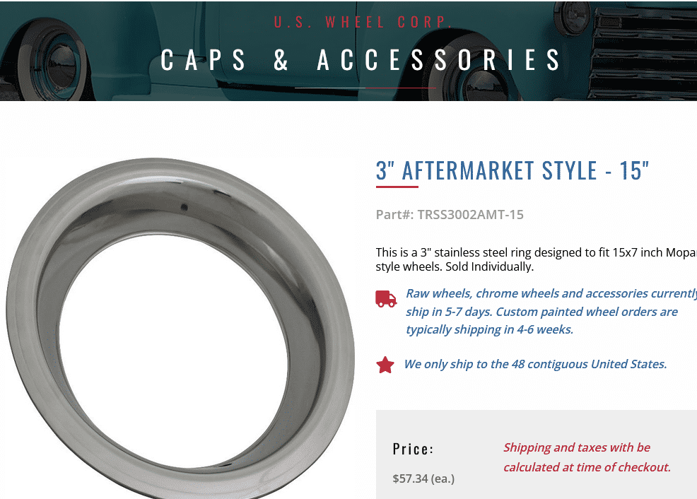

I thought any trim ring would fit so long as the size was right. I did find this on the US wheel site I`ll try one and if the fit is right i`ll get the other three. Oh well live and learn!

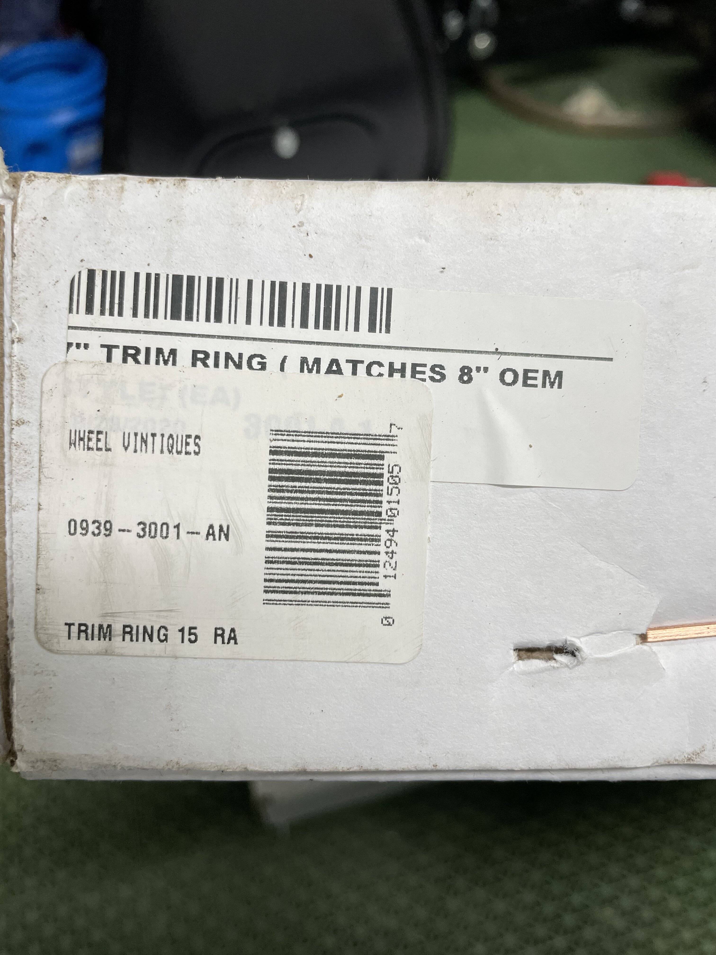

I was messing around in the garage last night on my car & looked at the box the rings came in and noticed the label. It says matches 8” oem? I bought a 15x7 rim, are these rings mislabeled?

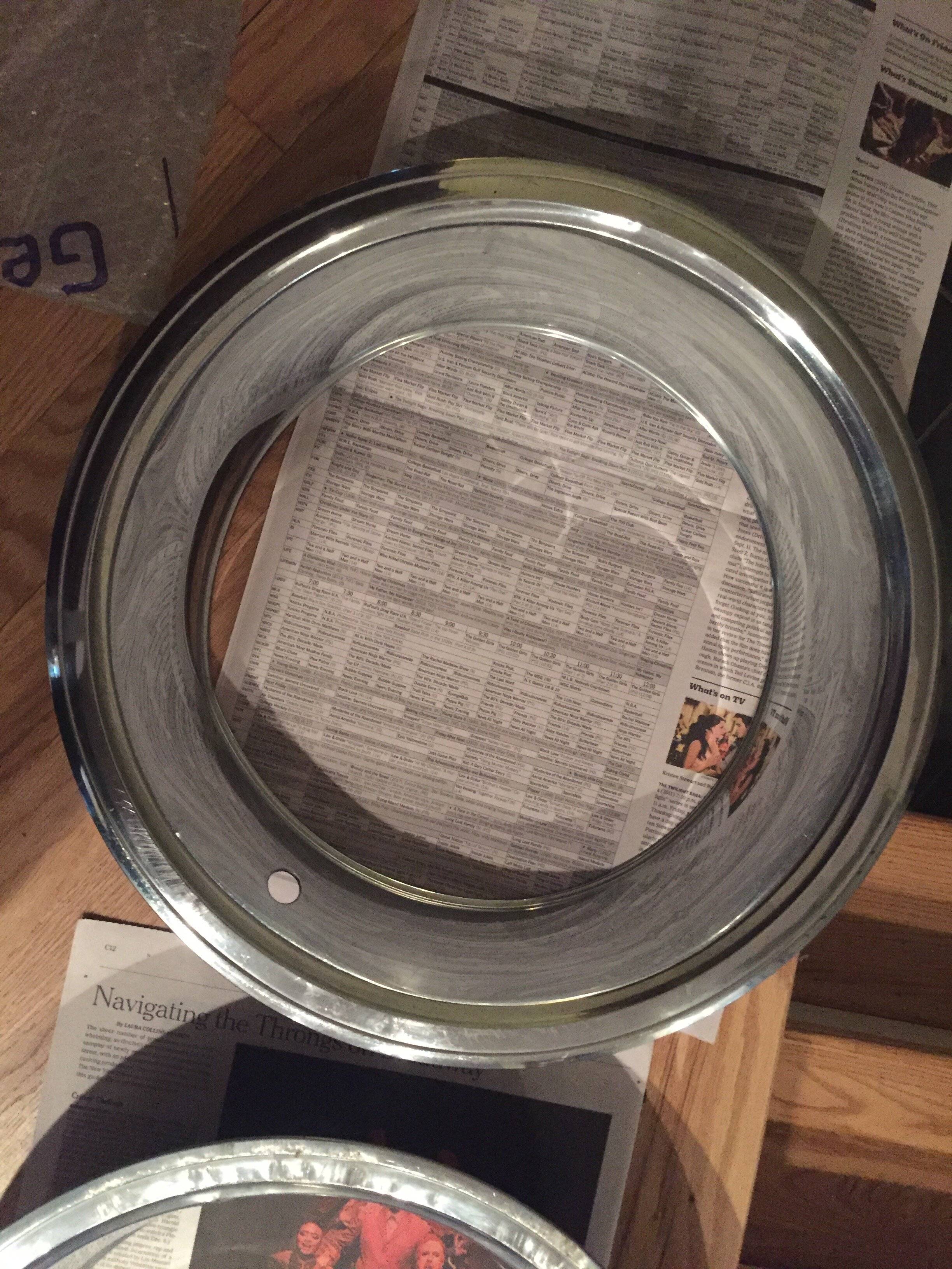

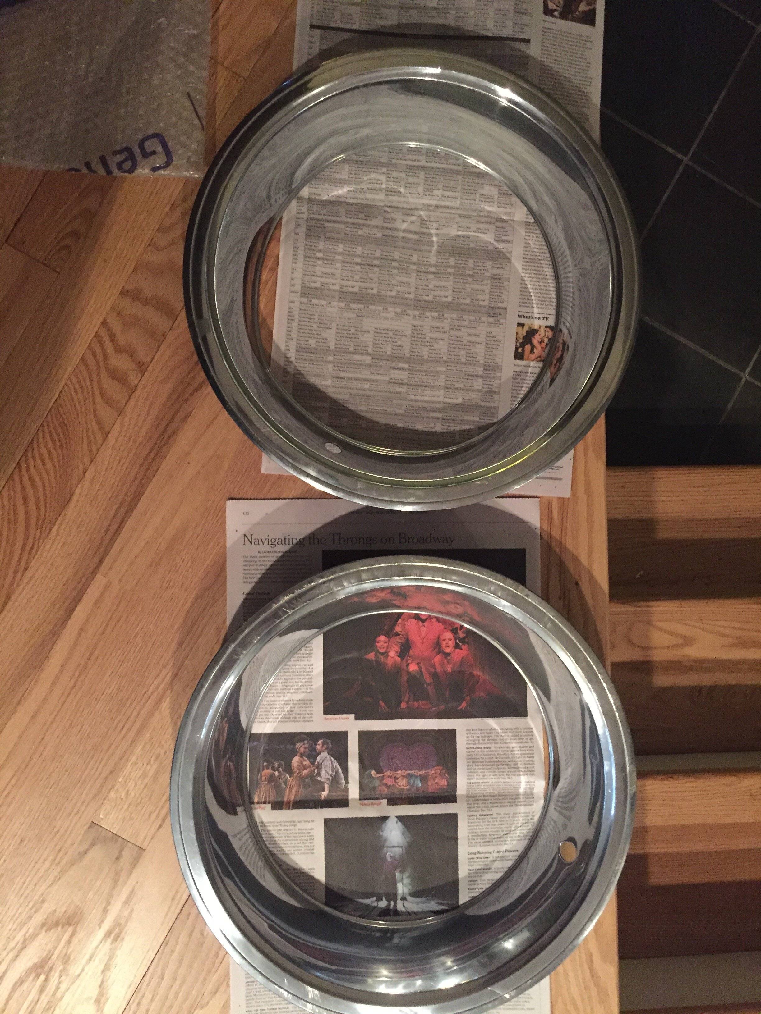

I have my original polished trim rings on my A66 Challenger vert, minus one. I had sold one original over 20 years when I thought I had an NOS set I bought in the 1980's. Looking at my stash later, with the correct part number, I had bought and stored 15x 2 3/4 all those years.
Anyway, I started looking for clean originals a few years ago and came across some decent rings that I purchased and could be eventually restored to like new. Paid on or around $100 per ring at the time. Just my thoughts on this!
