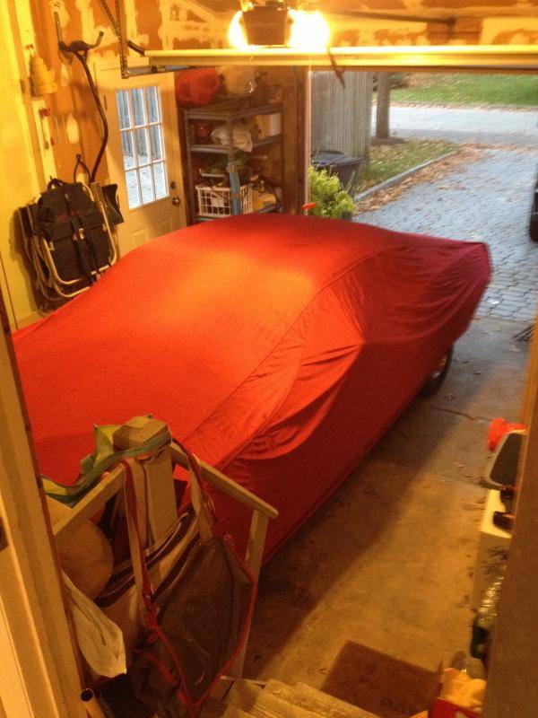

now she's sleeping til spring.
How did you prep her for storage ? Empty fuel tank and carb ? Jack stands to take the weight off of the tires ?etc...
no, I filled the tank with super, my garage does not get below freezing, so as with my previous cars, I start them at least 1x week during the winter to operating temps...and from various mopar sites I added dryer sheets to the interior and trunk has an open bottle of cat litter.
STA-BIL makes very good additives. Several to choose from depending on fuel types, ethanol etc... Also if you use a battery trickler remove the battery from the car, put in a well ventilated area. Besides just starting the car, If up on jack stands, you can work the steering wheel back and forth, if automatic place in neutral to allow the fluid to flow through the transmission. Put it in drive to lubricate the trans output shaft seal. U-joint bearings, gears. Apply brakes off and on to keep wheel cylinders and disc pistons flexible and conditioned. If on the ground try to drive it a little and turn air conditioner on for a while and the heater. Etc... What you are trying to do that you don't do just by starting the engine is to lubricate and bearings and seals that are normally lubricated by regular driving. Other wise you will get leaks and drips in the spring when you take her out of storage. Waxing the car before covering with a high quality dust cover. and many more things. great time to recheck all fluid levels, air pressure, before you put her to sleep.
I was using the Lucas brand, tried Sta-bil and then found some good chatter on FCBO about using two cycle engine oil that's TC-W3 rated. 1 oz per 5 gallons of gas every fill up. Ethanol absorbs moisture which will rust the metal parts and it also reacts with the rubber hose that we commonly use on our classics. Buy a new Edelbrock carb and it even tells you that it is not recommended that ethanol of any percentage is used. I think you can even say goodbye to your warranty iirc.
You would think it would be to the manufacturers advantage to use gaskets and seal that are resistant to ethanol since a lot of gasoline is sold during certain parts of the year contains it. Maybe we should all, just in case modernize our fuel systems as much as we can since we have no control over what the gas companies are selling us. Most manufacturers will tell you if their product is compatible with ethanol.

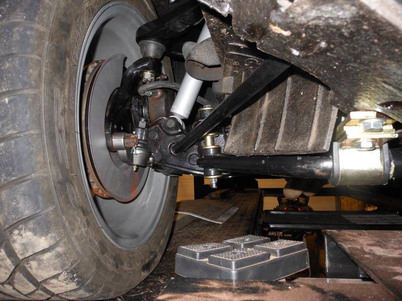

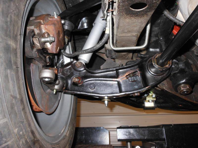

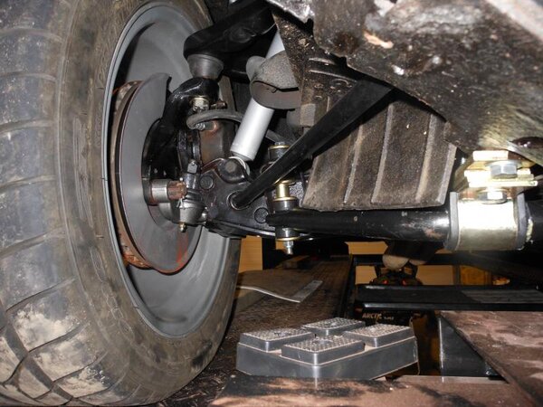

just finished putting in a new front end kit from PST, and new torsion bars from mopar perf. I left the center link out cause i'm going to tackle the rear main seal tomorrow.
Nice work! I don't envy you having to do the rear main while in the engine is in the car. Best of luck with it.
