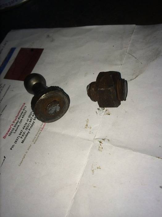

What is the name of this broken part??
Shut
Jan 20, 2016
87
FL
I broke this part, I need to buy it
Thanks in advance
Shut
Jan 20, 2016
87
FL
Thank you very much DetMatt1

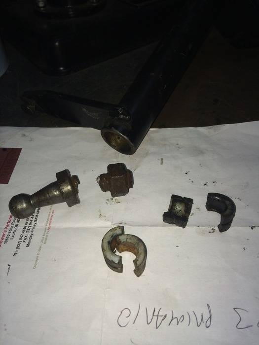

You are also going to want to replace the plastic bushings and the o-rings that hold them together.

Yes I think moparlee. Right?

I need the BS765B or BS766F??
moparlee
Jul 25, 2011
3,050
1,310
Mid Michigan
BS765B bolts directly to the bellhousing and BS766F bolts to the frame rail. Check the bellhousing one for wear as you may need that one also. The shoulder diameter is different for each one.
convdart440
Oct 15, 2013
40
10
they are all correct. the assembly is the torque shaft, with 2 ball studs 1 on the bell housing the other on the frame (body) (yes I know uni body cars no frame) , nylon washers and seals. Everything is available at brewers performance very affordable. I also bought the throw out bearing kit from MP. That came with the bearing,fork ,adjustable rod with the spring c clip and washers. Check the pivot joint bracket where the fork pivots, and the bracket where the ball stud attaches to the bell housing for being straight. I went thru 3 clutches before It snapped one day. If you can afford it replace whatever you can, it will save you time, money and aggravation later on. Good luck
