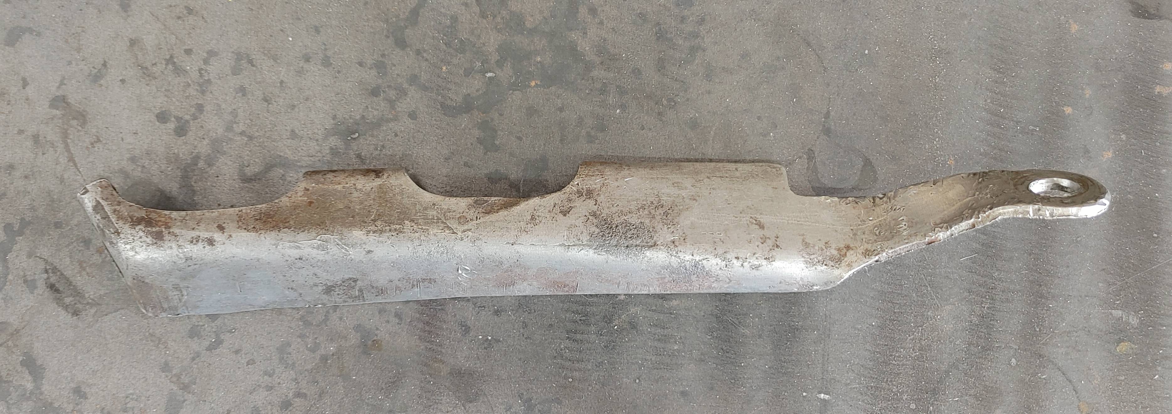

Lookey here what I found in an old box.
I presume that these were bare metal? I doubt they were painted on the engine. Does anyone know?

Sorry I was working on a handheld and I guess the picture did not upload. I just fixed it.
It is a picture of my wayward "Transmission support bracket".
Are they supposed to be bare steel, black, or engine color?
