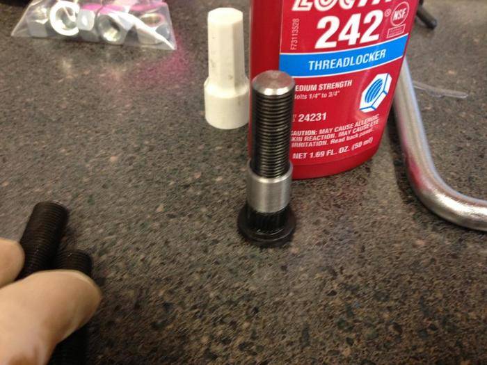

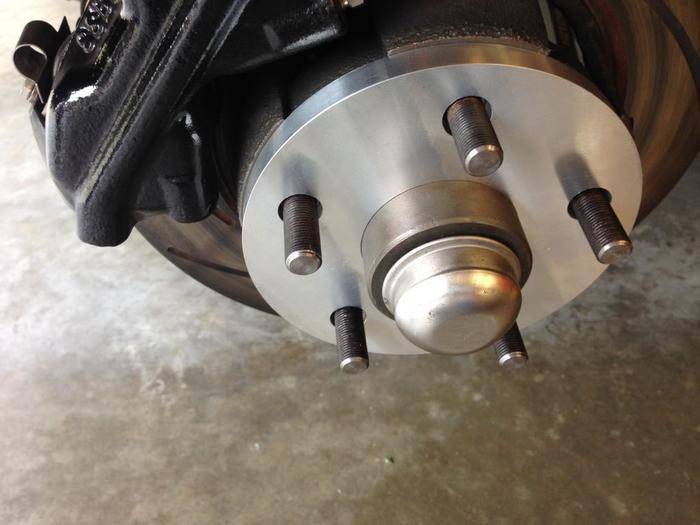

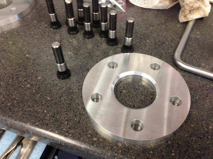

offset by fab'ing some spacers...and reworking the studs!! So....Here's what I did...For my set-up...a 14mm-20mm Offset works best for clearances

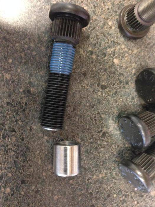

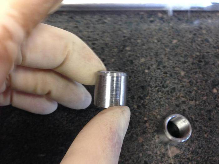

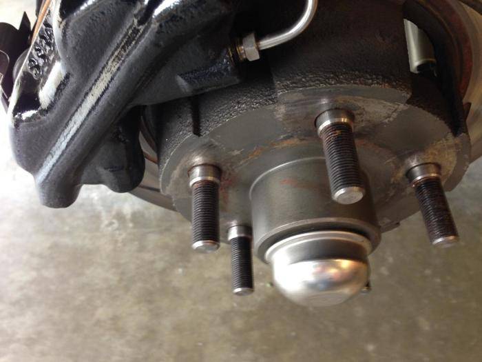

So I fab'ed up a .500 Hub-centric spacer with .010 clearance on the stud shanks...giving me about 17mm offset.Ordered the Moroso 190KSI 3" studs

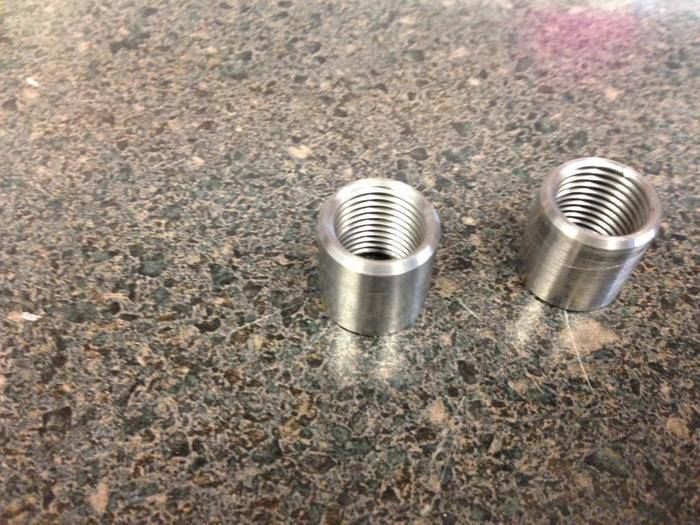

Cut them to 2.3" in length. The factory studs had a longer shoulder that just came thru the spindle and I wanted shoulders to come out about .100 short

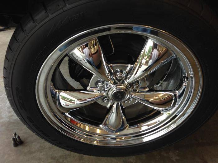

of the spacer parting plane...so I had a little more fab work to make my own shoulders. Once I was done....I put everything together...the wheels fit perfectly!!
Now...I have a little measureing and math to do for the rears...to calculate my possible spacers to build...to get a 305/315 under the fenders on the back!
Here's some pics!
