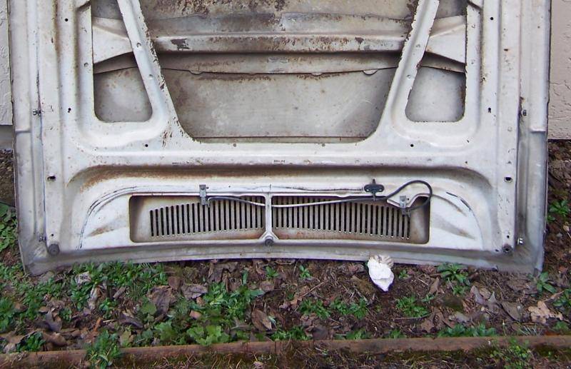

where do the hood bumpers go on a 72 challenger?
the hood on my wifes 72 challenger shakes going down the road so I ordered a new hood bumper kit, the wedges towards the rear and the front hood adj bolt rubbers were a no brainer but I have 4 round bumbers left, all look like they go in a small round hole-1/4" or less. I have been looking at pics and it looks like 2 may go at the rear of the hood, on the hood, and one pic looked like it had a single one in the center rear of the hood? any help would be appreciated, thanks guys!

I have a 73 with the hood scoops. Across the back of the hood it has 3 of the smaller round rubber buttons. I don't know if all the hood styles have them in the same place. Body Hood 01a.jpg
