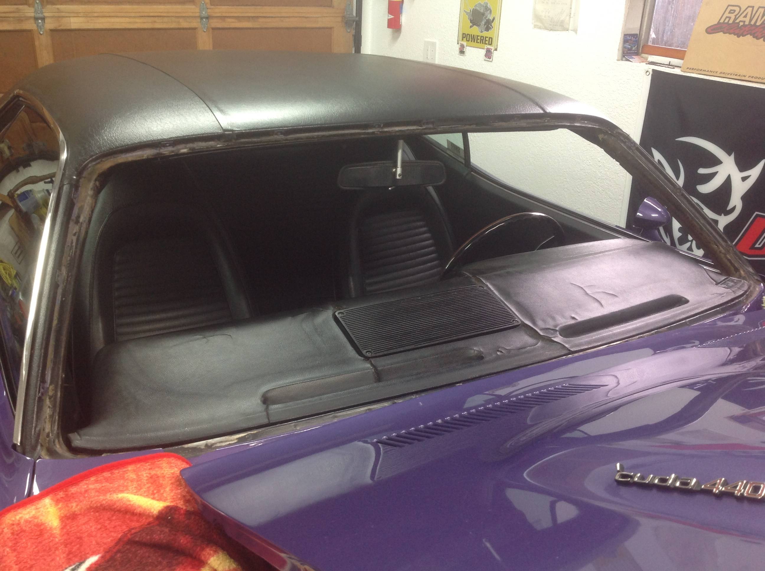

Where should you start the Butle Tape when installing a New Windshield in a 70 Cuda
