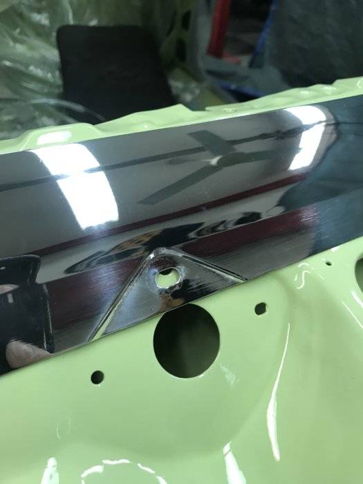

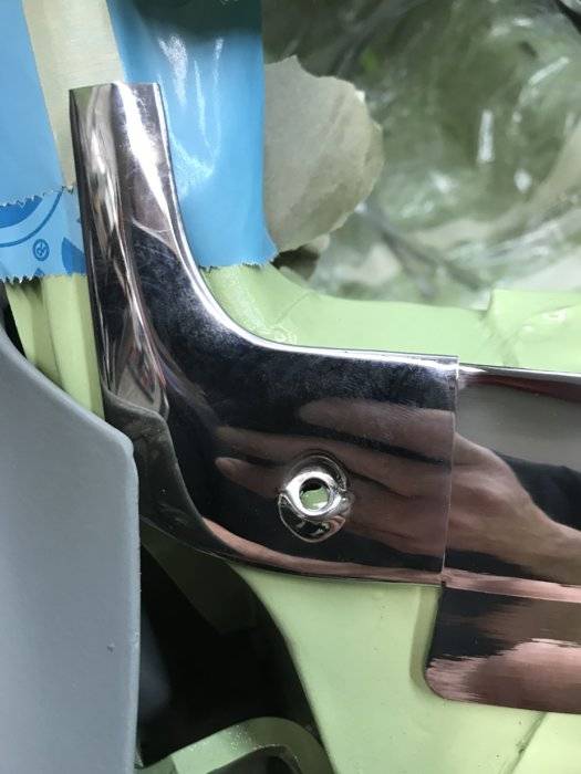

Hi, I am having the hardest time trying to figure out how the bottom trim of the windshield attaches. I have tried looking up some pictures, but they are all covered by they hood. I was wondering if anyone had a good picture of that. I am also trying to figure out how far down the vinyl top goes on the A-Pillar. And how it is terminated. I have a 1970 Cuda. Thanks!!!!

The trim is held on by screws. 1 on each wiper pivot and it also slides into the bottom end corner pieces that screw on. The vinyl trim goes down the A pillar and there should be a small trim piece on the bottom to finish it off.

Corner piece attaches to the side windshield trim and bottom piece. Second photo shows the trim is attached to the top wiper pivot bolt. 2 other holes just screw into the cowl. They do sell a screw kit for this also.
