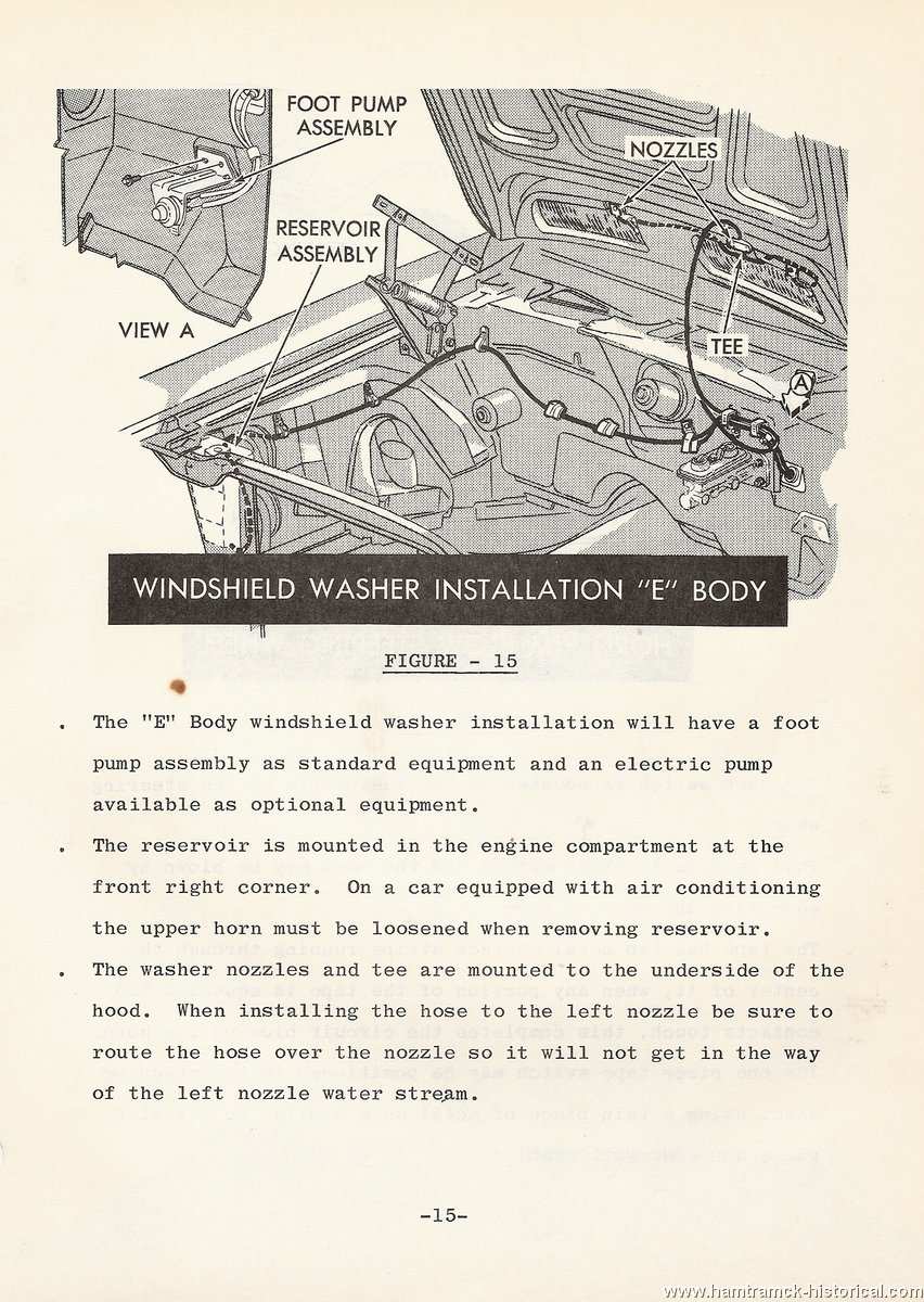

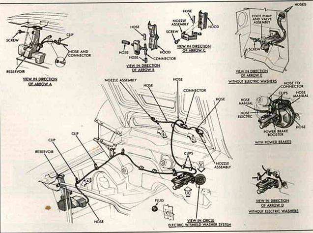

Im putting this car together and wanna do it right. How is the windshield washer hose that comes from the floor foot pump suppose to be routed. When you get to the heater hoses should the washer hose go through the plastic strap with the heater hoses or lay under it ive seen both ways

Washer hose routing diagram from a Technical Service Bulletin and the Factory Service Manual.
