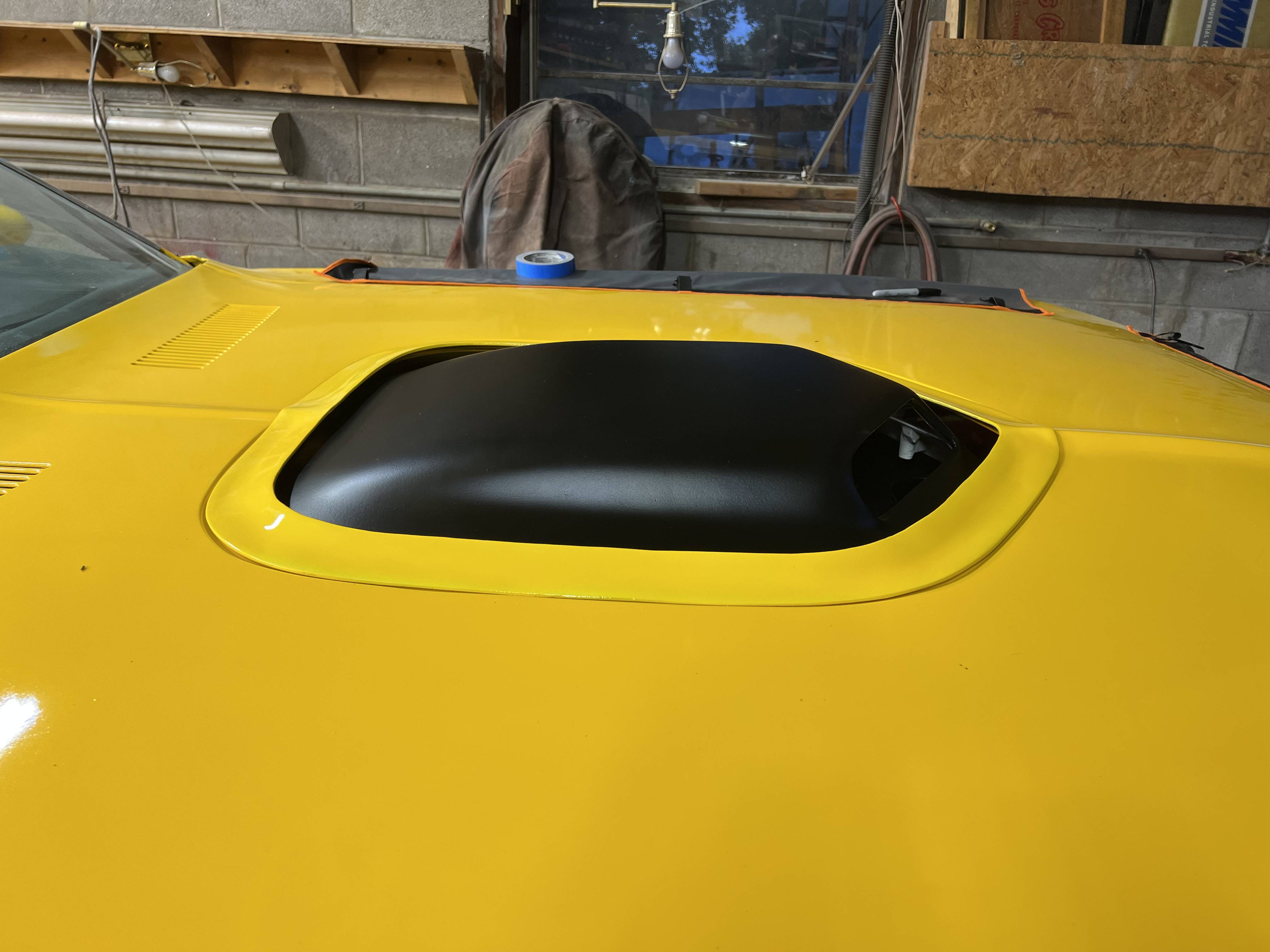

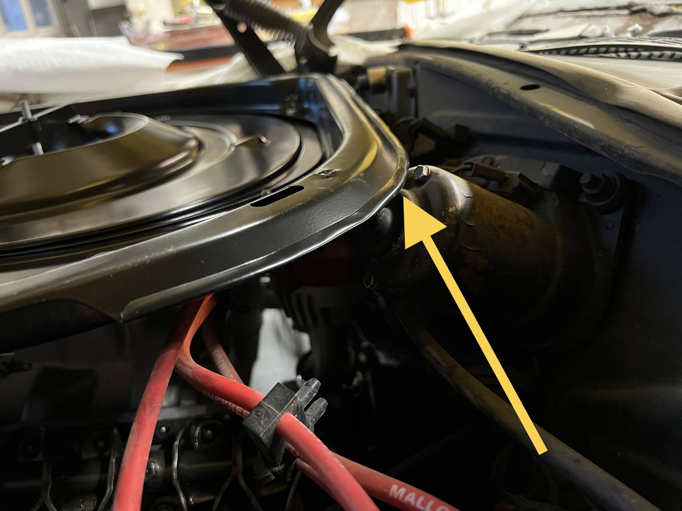

1971 barracuda clone into cuda
340 shaker hood install
I am converting to shaker hood, bought shaker parts from Tommy the Chiro. The pan is hitting on my 2 speed wiper motor. So I am converting to 3 speed motor.
Question about getting the wiper motor crank and arms.
I understand I need the Crank #: 2822289 & Link #: 2822293 and I can use my existing wiper arms.
Below is a link to an ebay listing, can someone please help me verify this set up is what I need? The link says 2822293 on it, but the other parts don’t jive. So basically I would be paying $300 for just the 2822293 arm. Can you help me figure out if this is what I need?
70 71 72 73 74 Cuda Challenger 3 speed / variable wiper linkage arms and pivot | eBay
