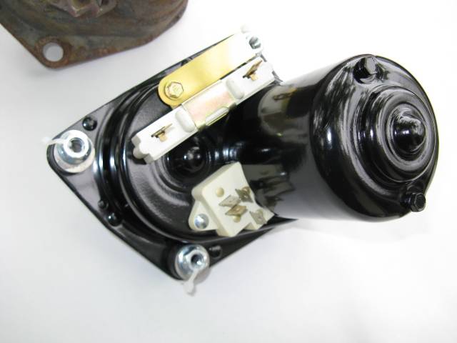

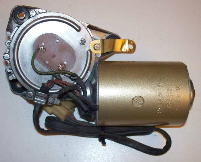

Mopar 2 to 3 Speed Mopar Wiper Motor Conversion

If you buy the 2 speed and use the 3sp switch it will not park and it will only have 1 speed.
I can restore your motor contact me if you would like
