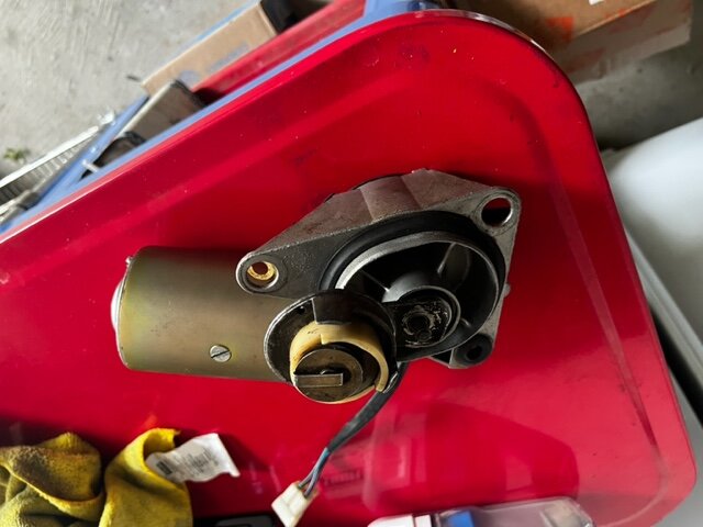

Hello everyone, need a little help.
A while ago I had my wiper motor repaired on my car. received it, loved it installed without testing. mFast forward a few years, seems like the bottom bearing caked up. Can anyone suggest a good place to have it looked at? Exterior is fine, need it to work.
Thank you in advance

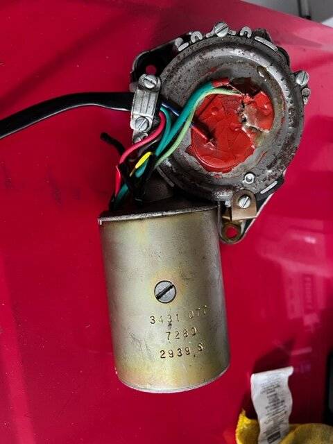

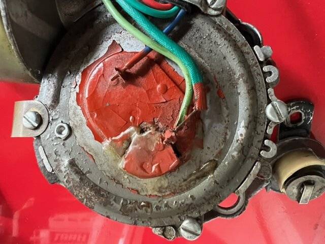

This is my motor, I think someone may have broken the seal. I had a Bench test instructions but neither positions worked

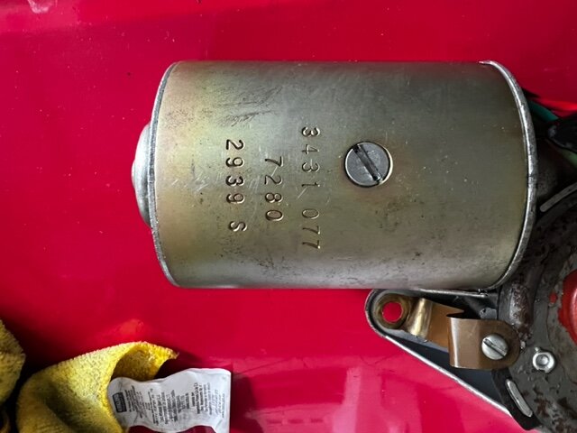

I am also dealing with wiper motor issues. I have a 3 speed switch, I have had multiple motors in the past and don't know if what I have today is a 2 speed or 3 speed. My 2 motors I have today generally looks like this one, but in another thread on this site, the part number 3431077, was listed as the 2 speed motor.
Question:
Is there a visual difference between the 2 speed and 3 speed motors?
Is the 3431077 part number for the 2 speed or 3 speed?
I also have a 2587697 part number motor, is that a 2 or 3 speed?
If anyone knows, thank you.
EW1BH27
Dec 31, 2021
571
295
Canada

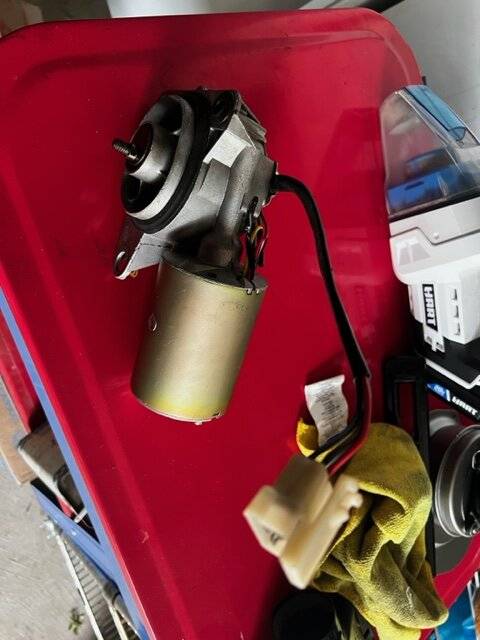

The visual difference is extremely noticeable. The 3431077 is 100% a 3 speed/variable speed motor. Note how the goldish housing is “ horizontal” . Two speed motor housings point outward towards the front of the engine and are black
2587697 is also a 3 speed, earlier B body
Mike73Dodge
Oct 8, 2013
58
29
Bellevue WA
Thanks. That makes sense. I think the only confusion was in a previous thread where the 3431077 part number was listed as a 2 speed rather than 3. Thanks.
