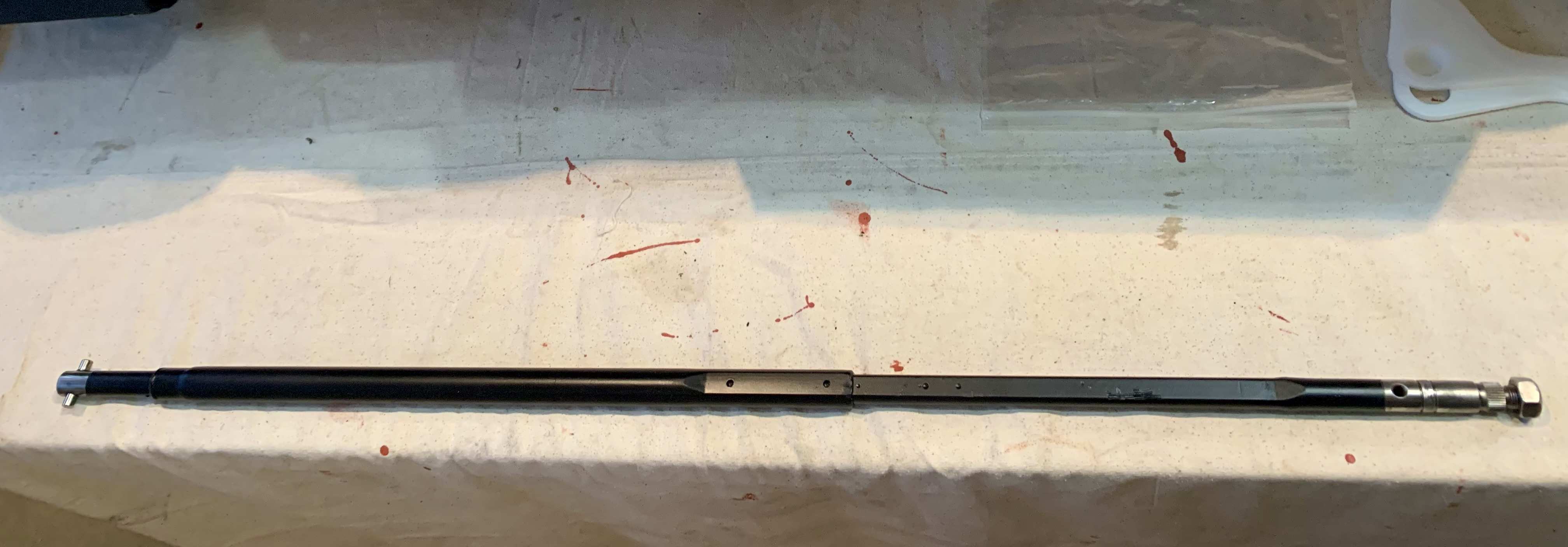

Looking for the inner steering shaft to convert a manual column to a PS column with the longer shaft for a factory setup.
Thanks
EV2RTSE
Dec 13, 2013
393
255

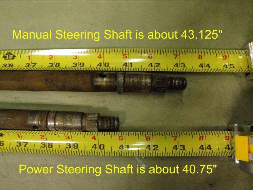

The manual steering shaft is longer than the power steering shaft.
I've got one out of a power steering column that I could sell you (below), but you should be able to just tap on one end of the manual shaft to bring it down to the power steering shaft length. Then get a power steering coupler body, which is readily available new or used, and you're good to go. I probably have an extra power steering coupler if you need to locate one.
