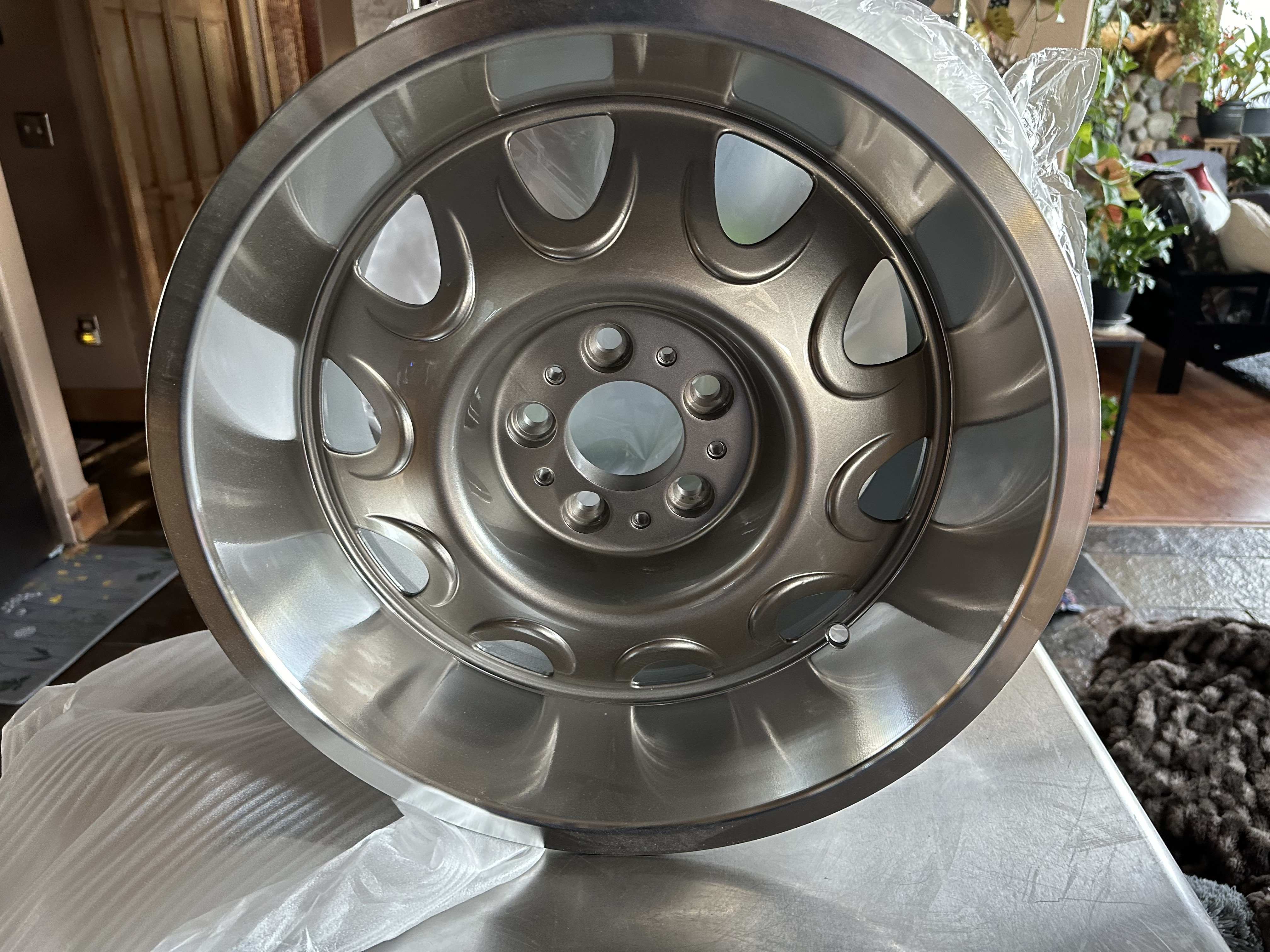

After years of drooling over them, I pulled the trigger and ordered a set. I remember in the past that YO had a tire fitment recommendation on the website, but alas I can not seem to find it. Have emailed and left a message with them, but yet to get anything back. I'm hoping that someone here would be willing to offer some advice on tire sizes and maybe brand too. The car is not driven that hard, so don't need a real performance tire per se. I got the staggered set of 8" and 9" for the rears. Found a tire shop that some of the old school hot rod guys recommended, so need some info before contacting them!! Have only opened the one, but wow they are nice... Thanks in advance!!!

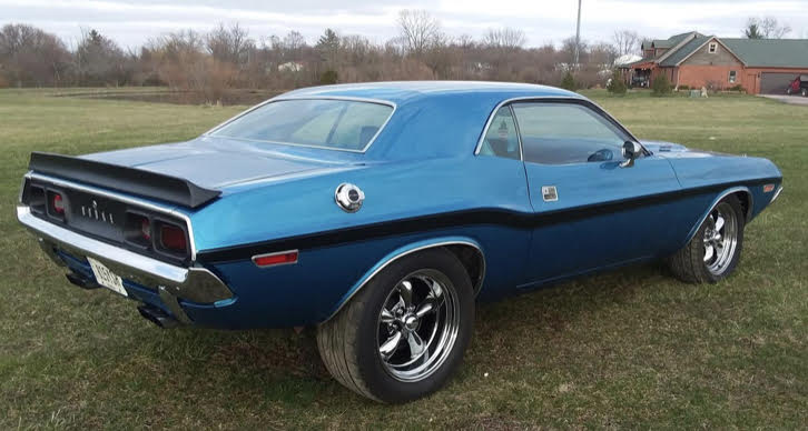

I put those same wheels on my 72 Challenger, and they look great. The rallye style is my personal favorite. I got Nitto 255/50R17 for the back and 225 for the front. The Nitto's have much better traction. I have a Dana 60 w/3.23 rear gearset but can still spin the tires if I nail the gas at 40mph.

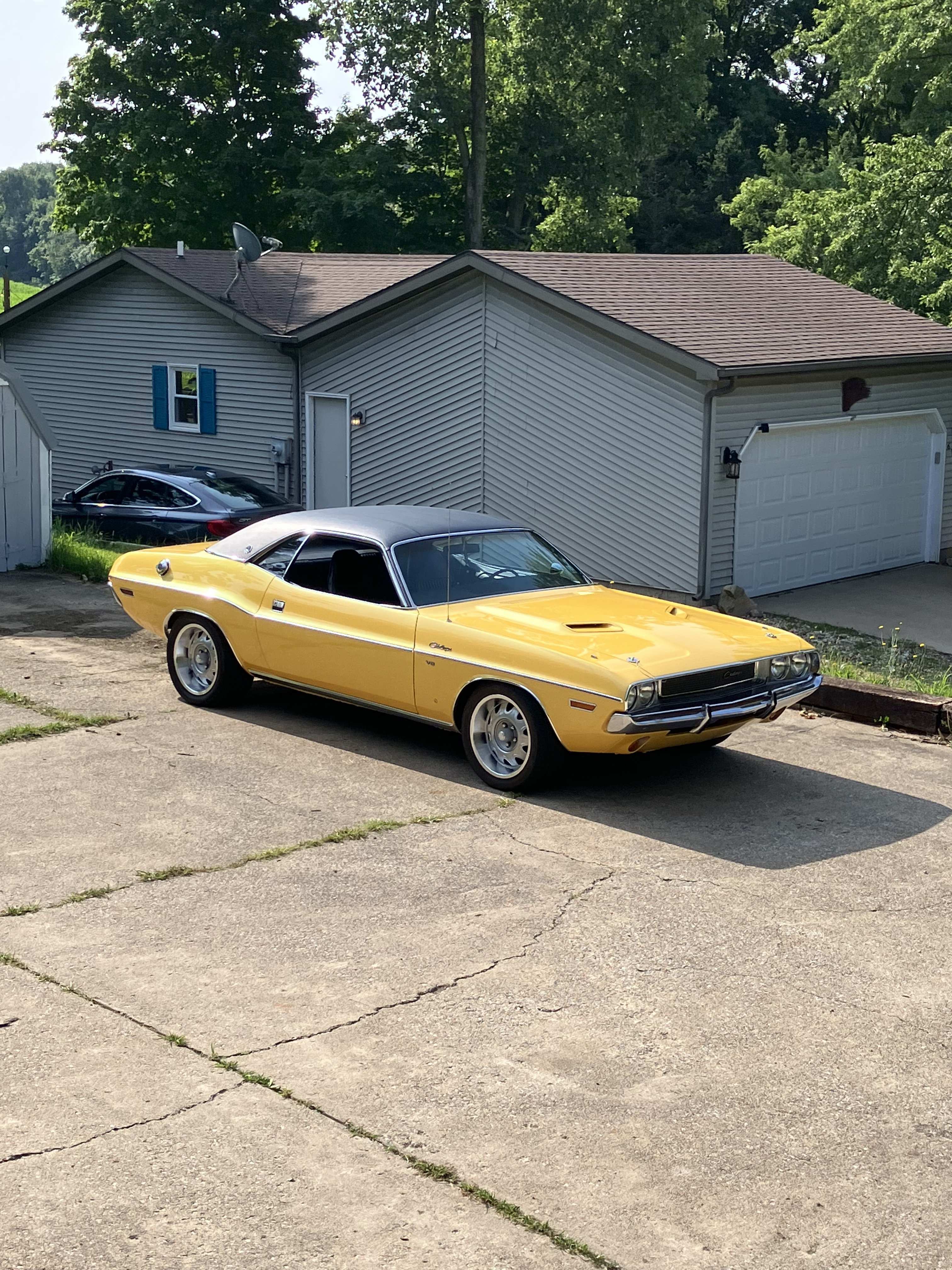

I like mine, but at stock ride height, the front wheels rub just barely. Moparleo is right, I dodge pot holes with those short sidewalls - if your looking for decent roads, Michigan isn’t the answer.
