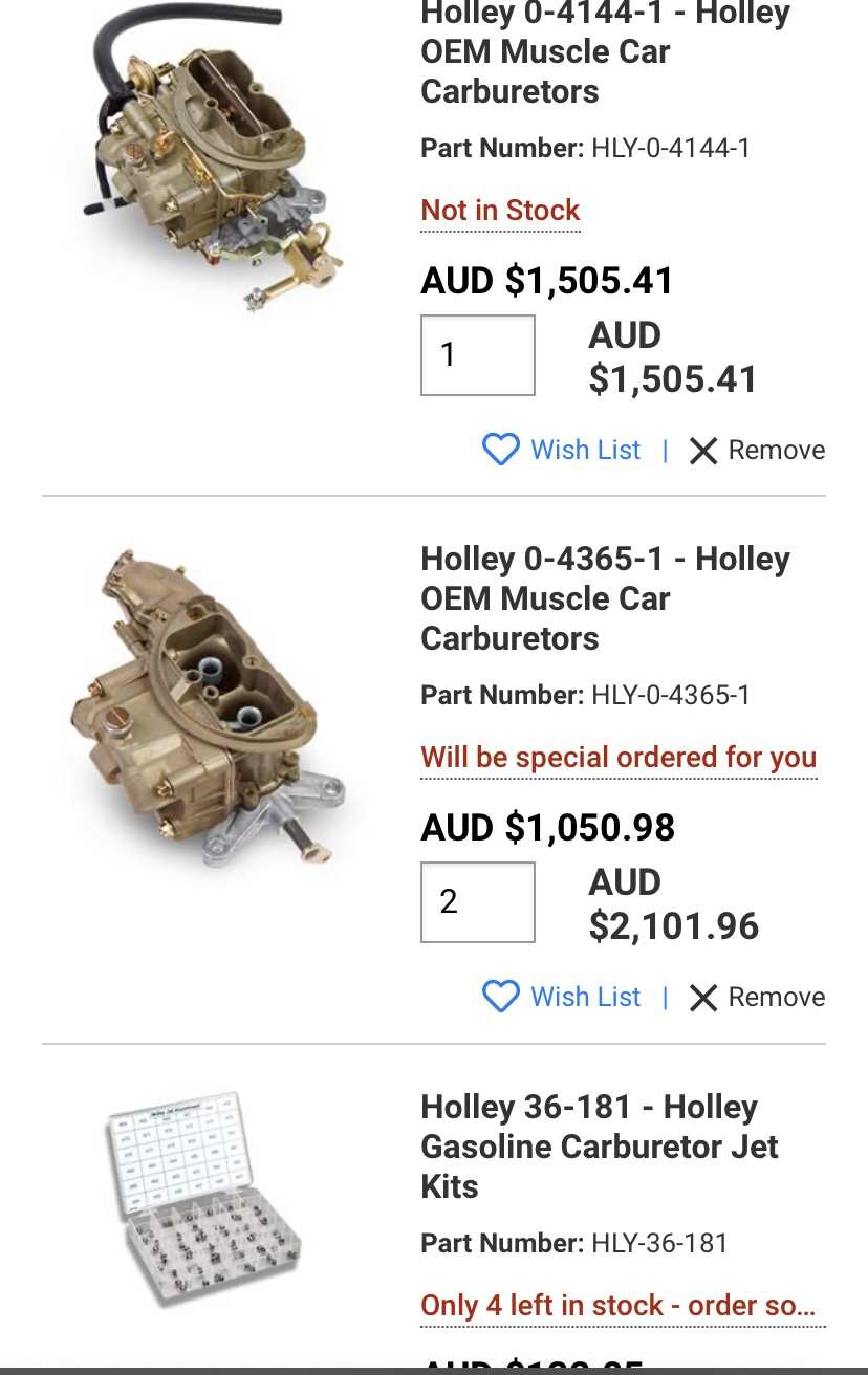

1. I am looking at Holley 4144 and 4360. My question is: there’s a there a difference between this and the P4349235 mopar performance Holley six pack carb?

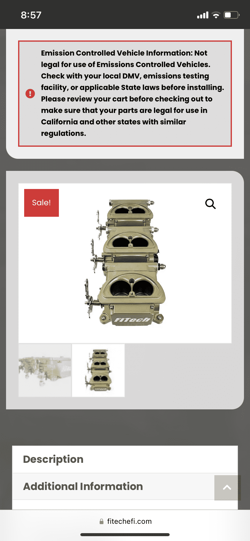

2. Has anyone got experience with the Fitech fi Six pack system and would they reccomend it as an option for someone who just wants a daily driver for fun?

the 4144 can be usd as the center carb , the 4360 is a small 4 bbl & will not work
4365 is what you need

Thanks! All makes sense! Do you have any reccomendations for FI systems out there? I don’t want to start a debate on the pros and cons of FI but I feel like there are limited options for six pack EFI outside of the Fitech system… but I am happy to be corrected 😎

I have not looked but FITech had Jensen at one show I was at with a 440 6 pak FI system , friggin cool !

These are my two choices narrowed down- to be honest last time I messed with a Holley sniper it was ‘ok’ but never felt trustworthy!

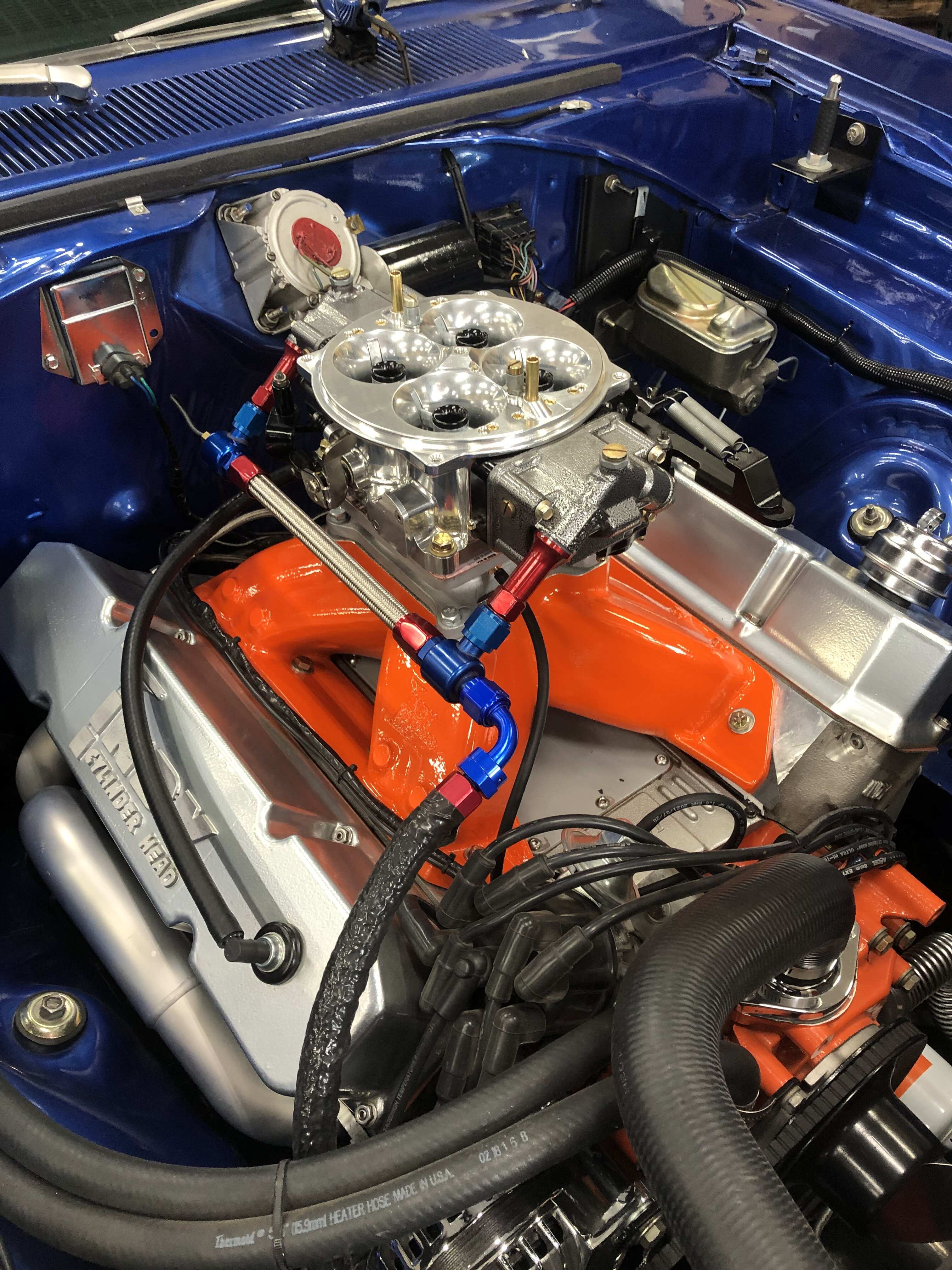

I built a Multiport system for a customer & sourced everything separately from various suppliers , it was friggin awesome , I used a Victor 4 bbl intake drilled for injectors with rails supplied , Bosch 85 lb / hr injectors , Accufab 1200 CFM T body that was 1/2 as tall as a carb , a separate Walbro fuel pump to each rail feeding only 4 cylinders , set up a crank trigger & used a Computer that was Aircraft rated from SDS EFI . EFI i snot cheap but not that far out of line if the carbs are over 4K !
