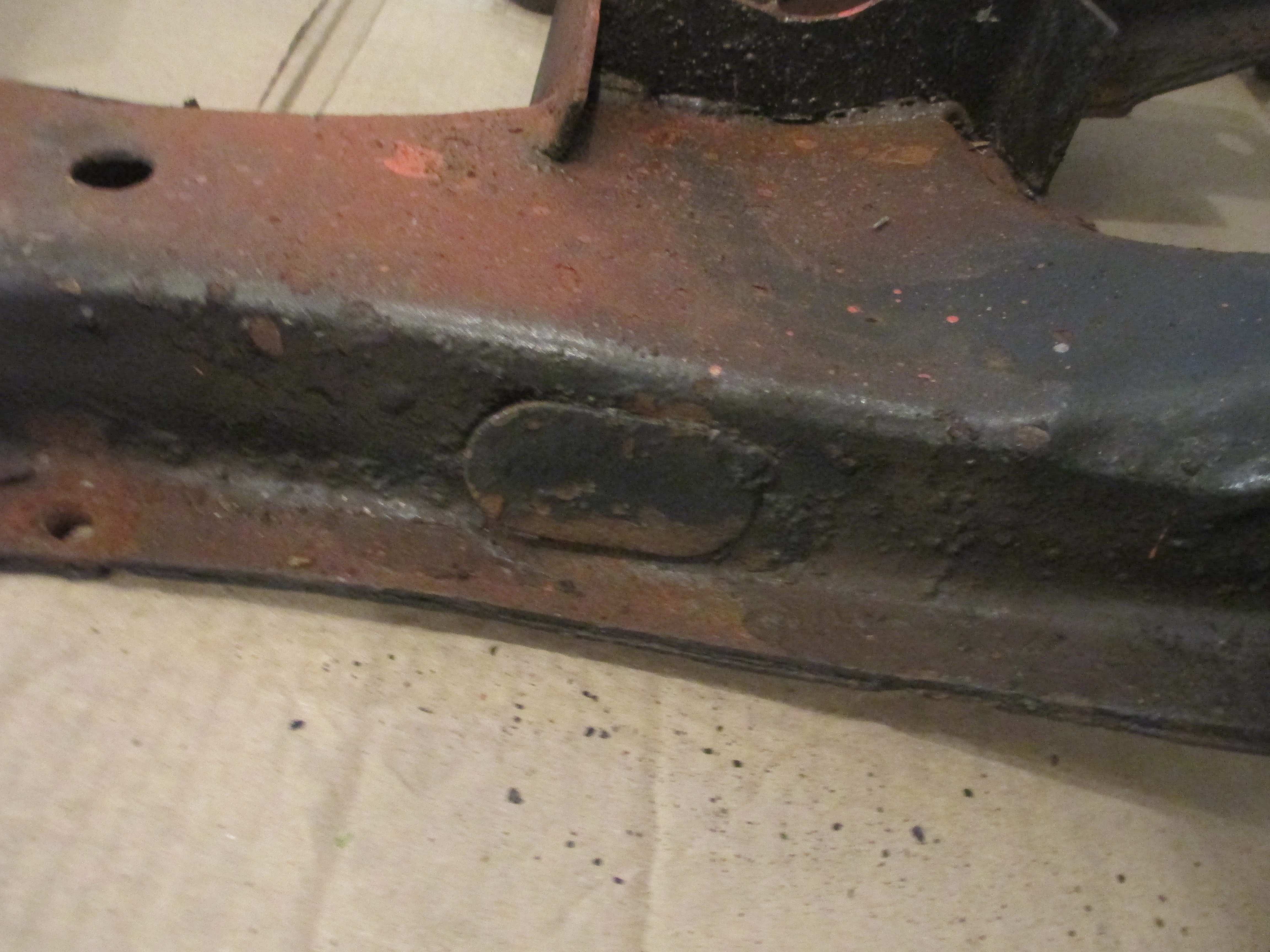

Great thanks I have a oval piece of metal attached to the front of my K frame I was told this was another way to identify a AAR or a TA is that true? I haven't stripped it yet is there any numbers on it? what was its purpose

That oval piece should have two digits which are the last two digits of the PN. For a 340 it should be "76" or "12". I'll let AAR and T/A owners comment on which of the two is correct. Maybe both?

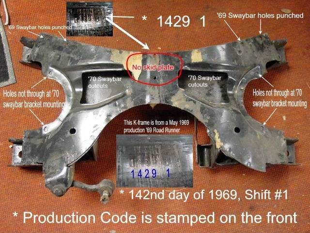

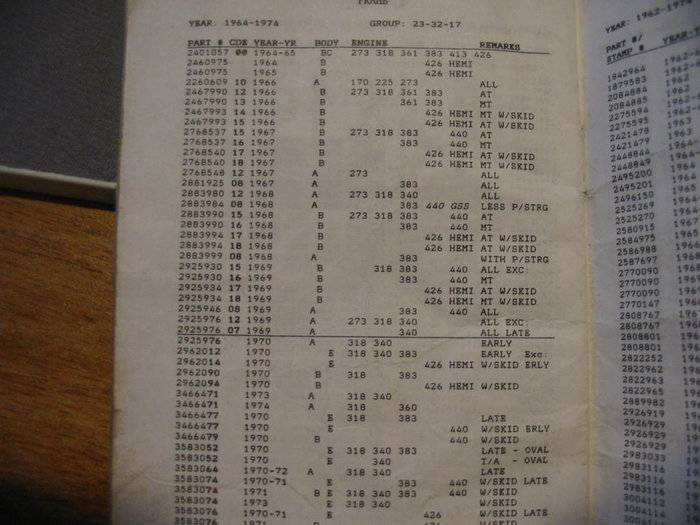

K frame part numbers (last two numbers of the the k frame usually on the "coin" and the K frame description picture

There were "coins" welded to K-members that have two stamped numbers on them, they are the last two digits of the part numbers. Mostly on 70 and up cars.
Example: '70 e-body K-frame numbers
**** *10 - /6 early
2962 012 - 314/340/383 early
2962 014 - HEMI early
3466 477 - 440 early
3583 052 - T/A
**** *70 - /6 late
3583 072 - 318/340/383 late
3583 074 - 440 late
3583 076 - HEMI late
some b'cast sheets indicate 3583 052 - on late (post T/A) 340 4bbl & 383 4bbl cars

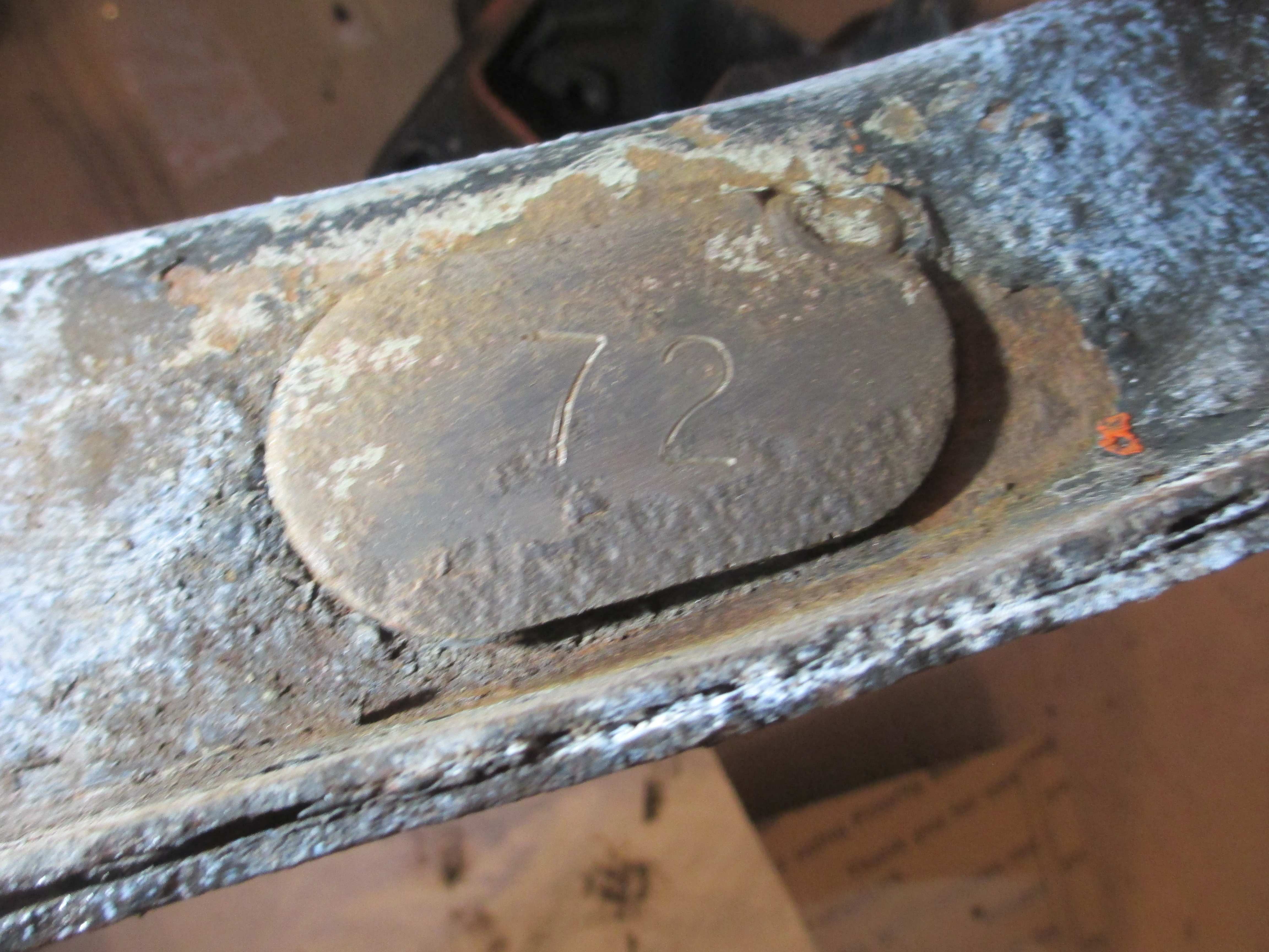

KennyCuda
Aug 3, 2020
296
33
My car was built April 13th so a TA should have a 52? I know my car has the original K Frame in it but says 72 would that still indicate a TA
