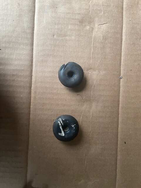

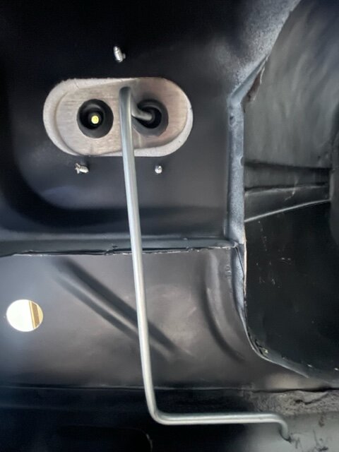

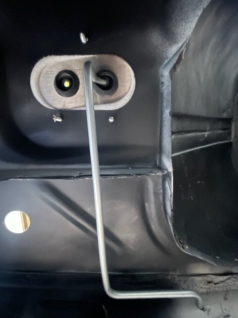

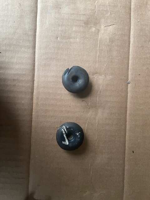

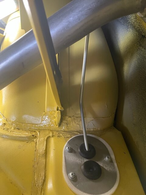

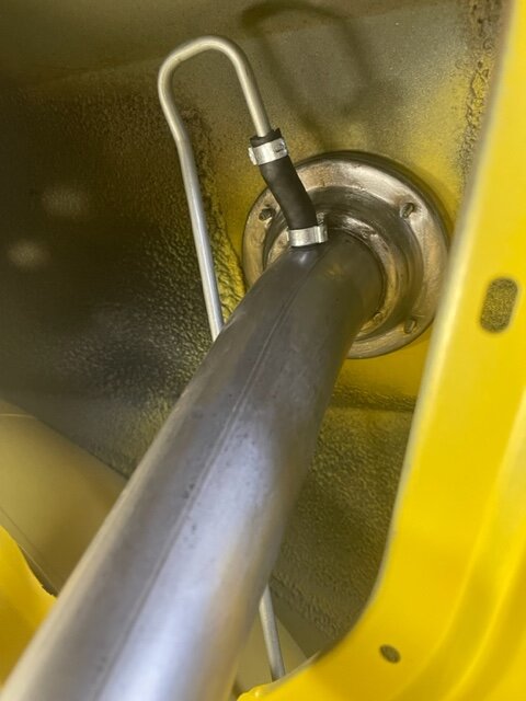

Is that a check mark?, it is a small but an important part !Installed gas tank vent 1970 non emissions. the grommets were a tight fit. The original grommet had a white factory mark still on it!
When I cleaned the grommets up, the mark was there. They were the originals under the original mat since I bought the car in 1979. I think the mark is a factory mark made after the factory install?Is that a check mark?, it is a small but an important part !

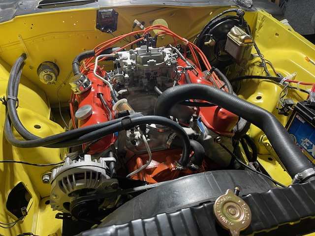

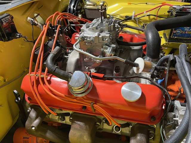

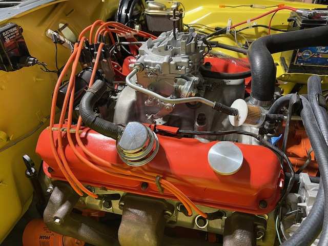

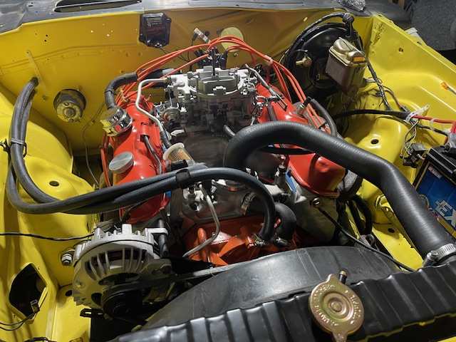

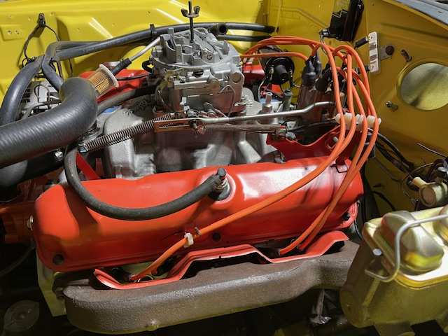

Congrats for getting to this point Phil! Let's hear itRebuilt A66 Engine is ready to finally start!
If I didn't know, I would say, these pictures are out of a car magazine !Rebuilt A66 Engine is ready to finally start!
Thanks BudaIf I didn't know, I would say, these pictures are out of a car magazine !
The best thing about this engine is that its "principaly" done right ;
Very nice
Sure looks great! So how does she run??Thanks Buda

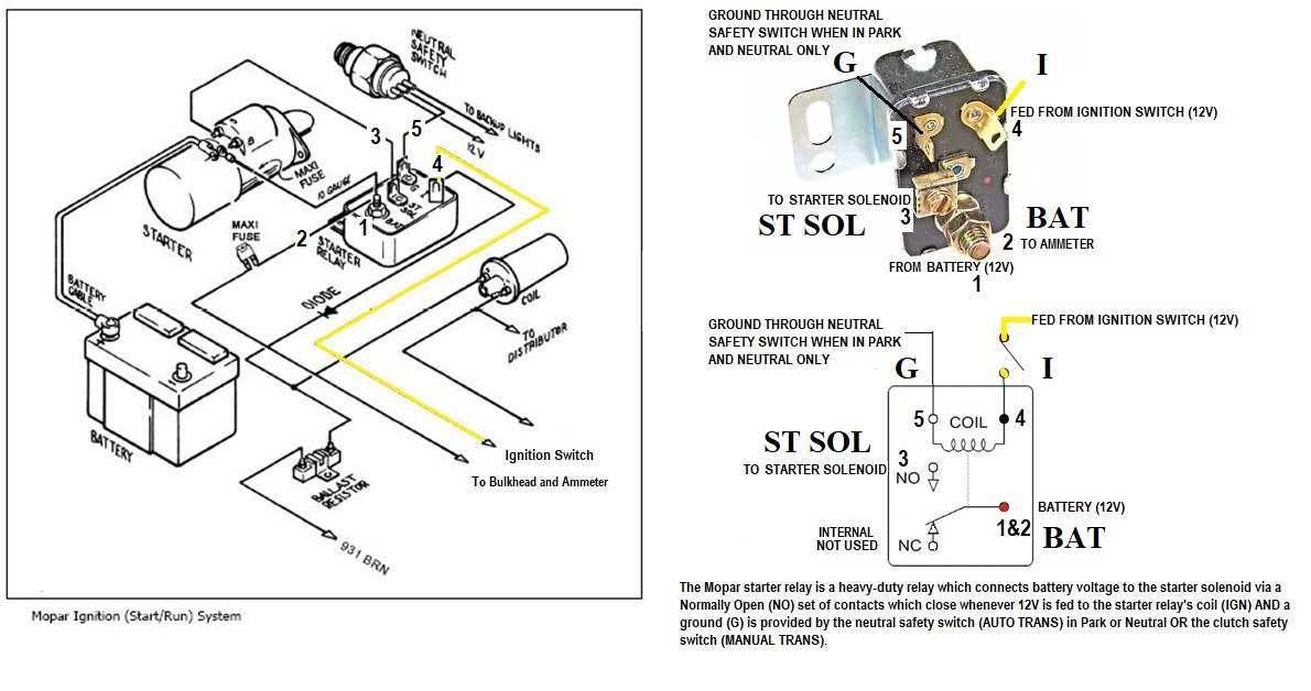

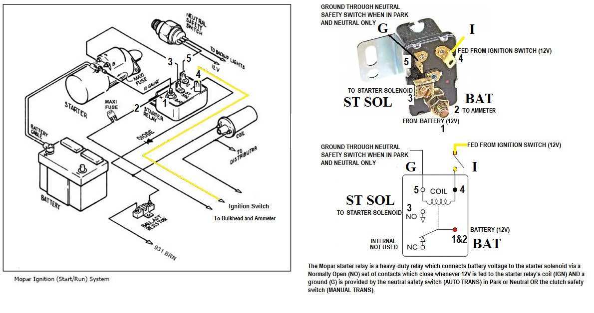

Thank you for your thoughts and the diagram; appreciated.Remember as you probably know, the starter relay needs a ground through the mounting screw or automatic neutral sw. This is not your problem as of yet. View attachment 123000
You have to find out if the problem is in the connector bulkhead or column or the ignition sw. Could be a wire.
While plugs connected. And the ing sw in the start position. Try to probe the yellow wire at the column plug then at the bulkhead connector. That will help narrow it down. While fiddling with it, it might self correct loose connection.
Also have a factory fusible link to the power stud on the starter relay! Thanks again!There should be a usable link by the battery. If not now you good with the fuse.
