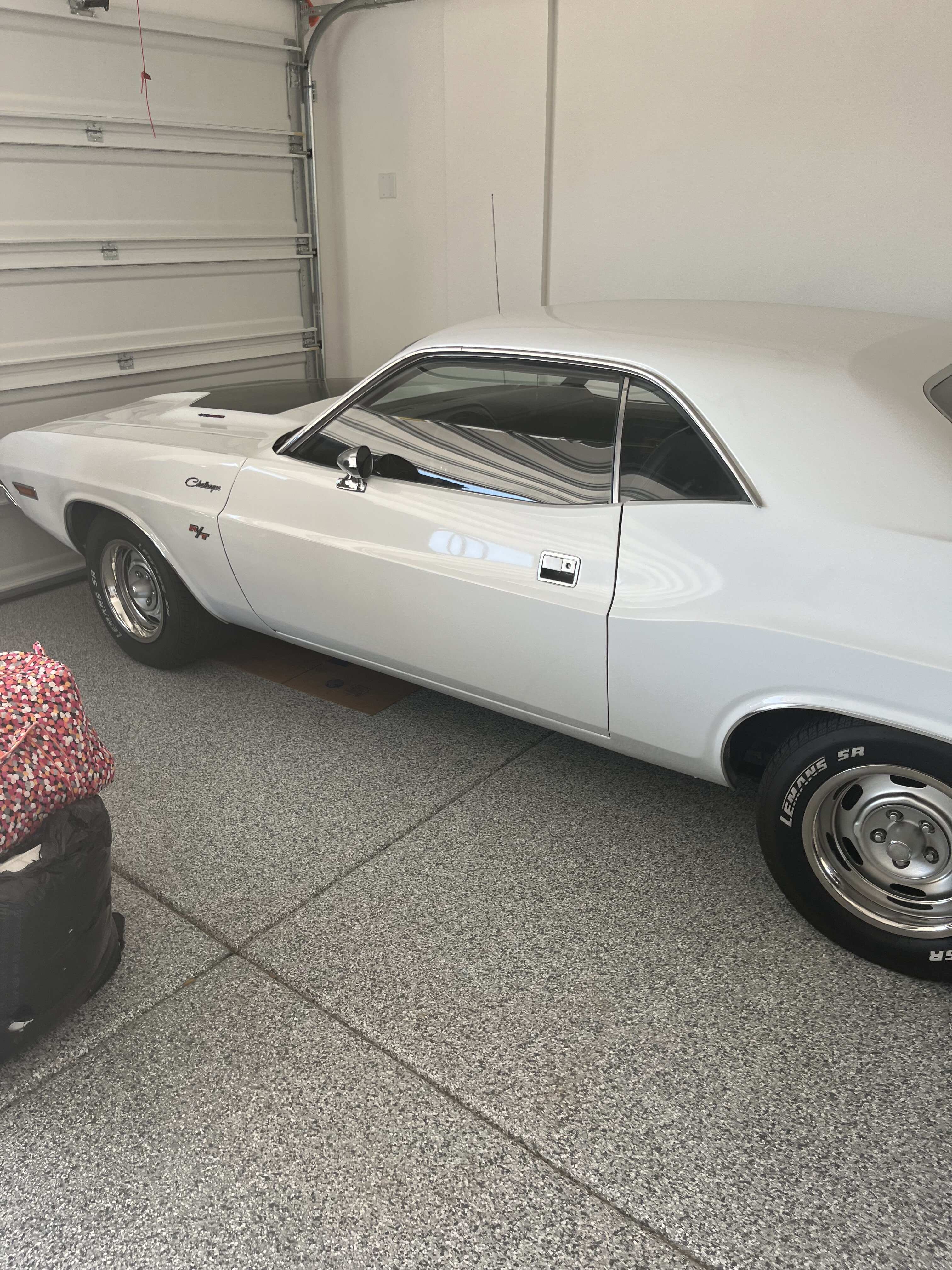

Hello,
New to the site.
I’m looking to convert my 1970 Challenger to a 4-speed.
Any recommendations of a reputable company who does great work.
I appreciate the help.
