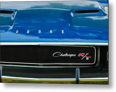

Newbie question here, I've got a 1970 Challenger R/T SE and a bag of various emblems/badges etc for the panels. Per the build sheet, mine had the R/T side stripes deleted, but had the Bumble bee transverse stripes on the rear.
I've got the Challenger R/T on the front grill. It's a 383 Magnum engine, so I figure the 383 Magnum badges go on the sides of the hood scoops. I know there's a "DODGE" badge that goes across the front of the hood and I'm pretty sure the SE badges go on the sail pillars.

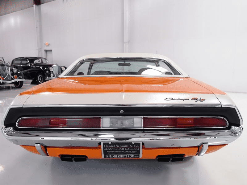

What goes on the front guards? Is it just the "Challenger" badges or "Challenger" with "R/T" below? Does the trunk lid have "Challenger" only or "Challenger R/T" on it.

Front fenders & trunk lid have Challenger & R/T badges , in line on the trunk & below on the fenders

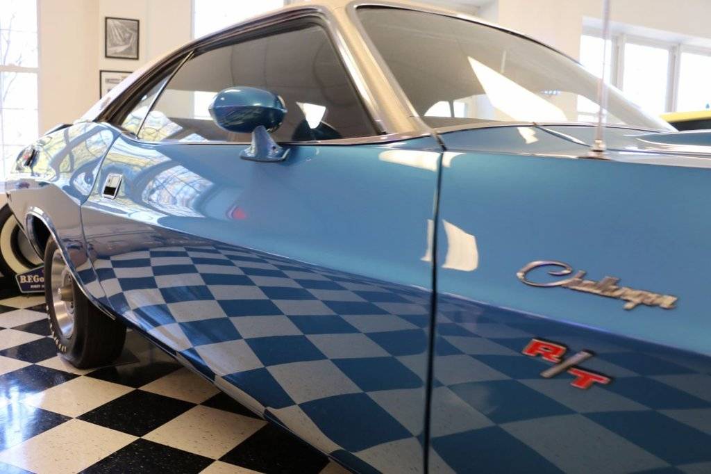

Pic of the fender emblems for 1970 RT
