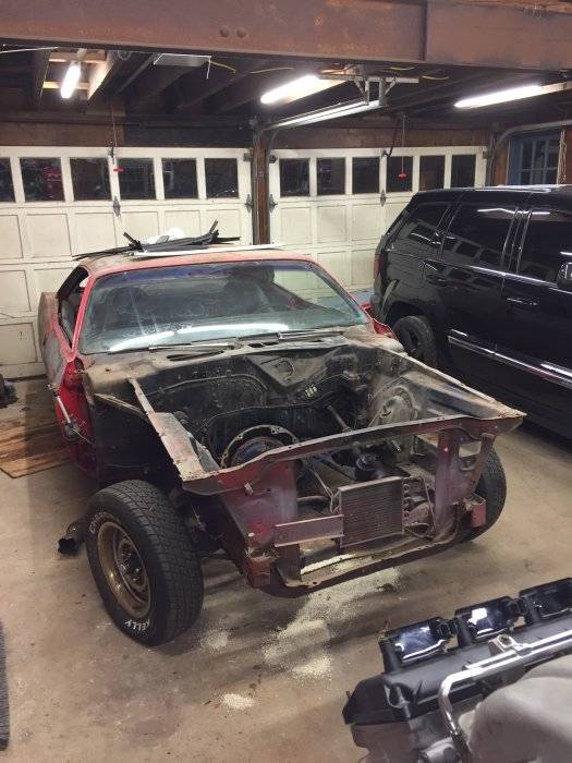

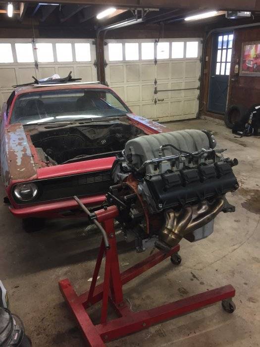

hi everyone! im just starting my project and have lots to do. I have never done a hemi swap so I might have to rely on some of you who have done it to help out along the way. I have a 1970 318 barracuda that im putting a 2008 6.1 hemi into. I plan on using the 904 trans that came in the car. I have a 7-1/4 rear end in the car now but I picked up a 8-3/4 with a 742 center section. I plan on going coil over in the front and disc all the way around. the car is torn down to a bare body right now. I may or may not put it on a rotisserie. it depends if I can find one or not. I will try to keep updates as I get farther along. I have two young kids and a wife that says I don't have a lot of time to work on it, but I try to get out there as much as I can.
