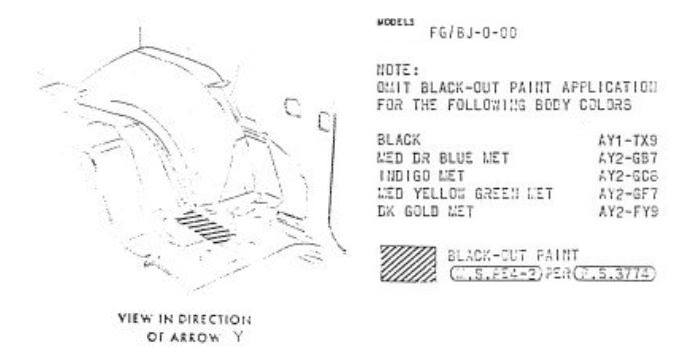

1) Was there any blackout under the rear seat so you did not see body color through the seat cracks? If yes can someone please post a picture of what it should look like - preferably from an unrestored car?

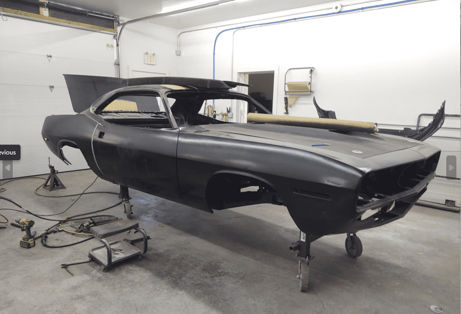

2) On the A Pillar/Windshield blackout - did it extend along the bottom so body color is not visible in front of the dash pad?

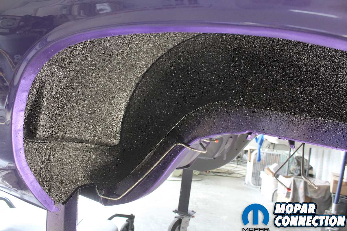

3) Can someone post a picture of the extent of rear wheel undercoating?

@anlauto may be able to provide some guidance on Question 1 but the drawing below shows blackout was used at the rear seat floorplan.
Some seriously good info on blackout HERE and undercoating HERE to answer Questions 2 and 3.
