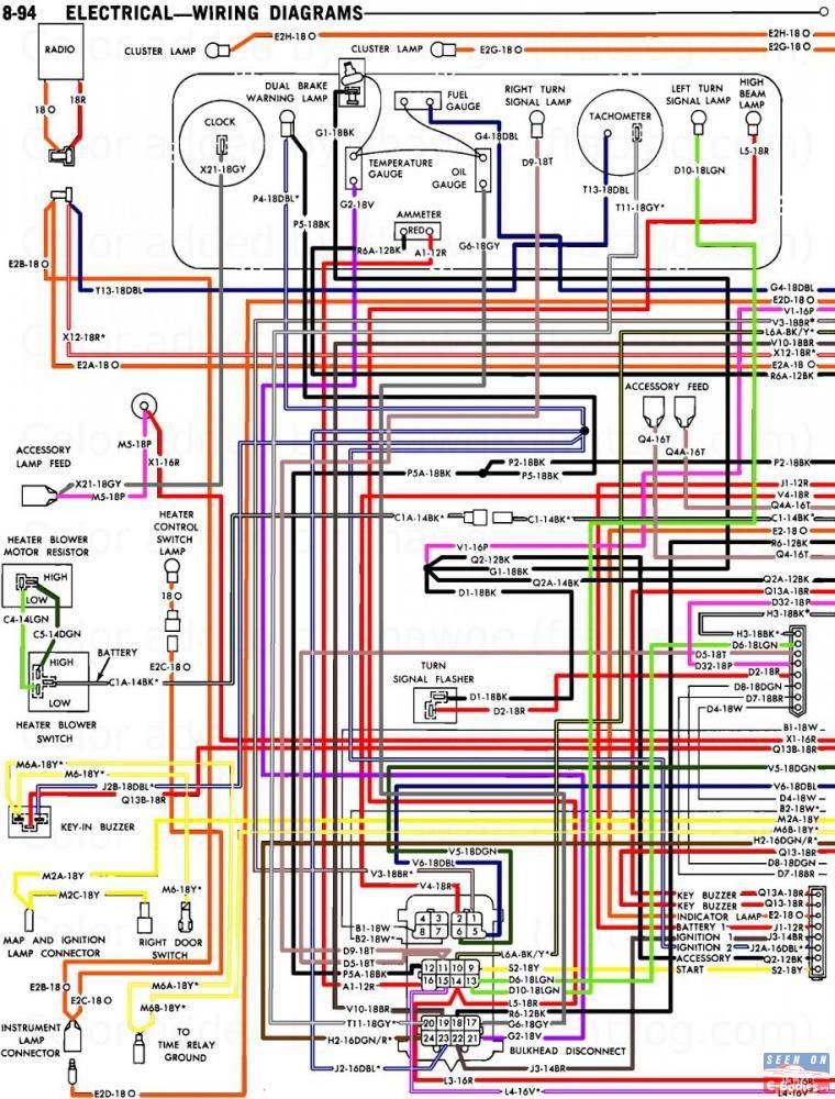

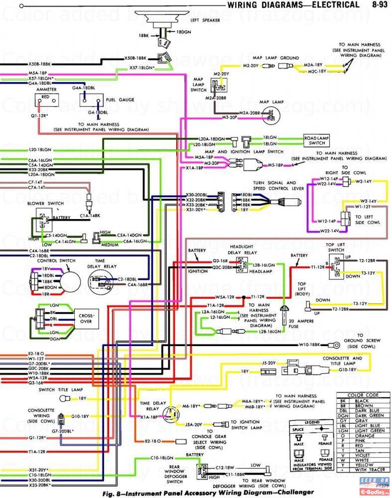

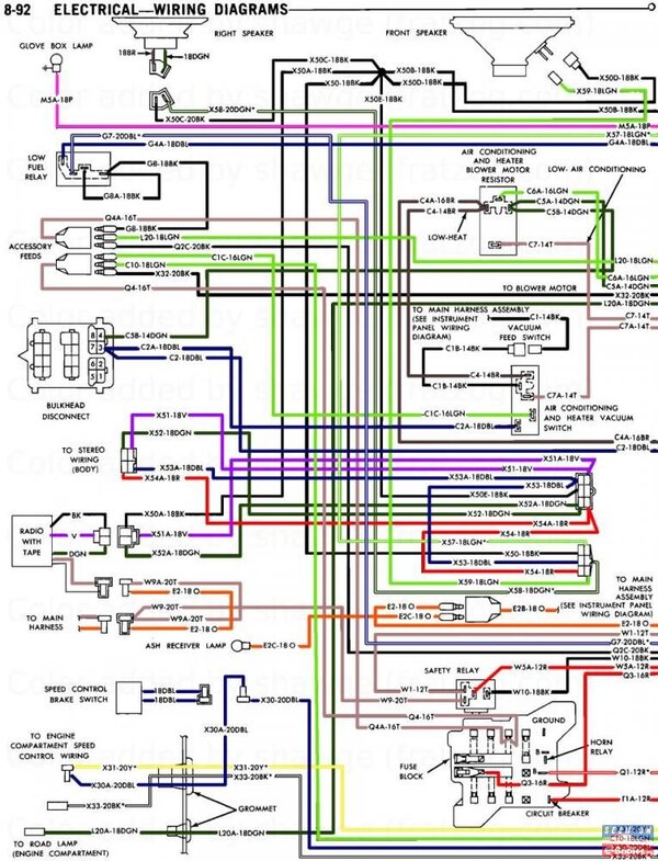

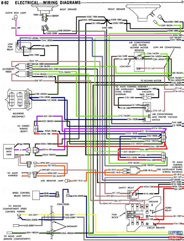

Here's a start.

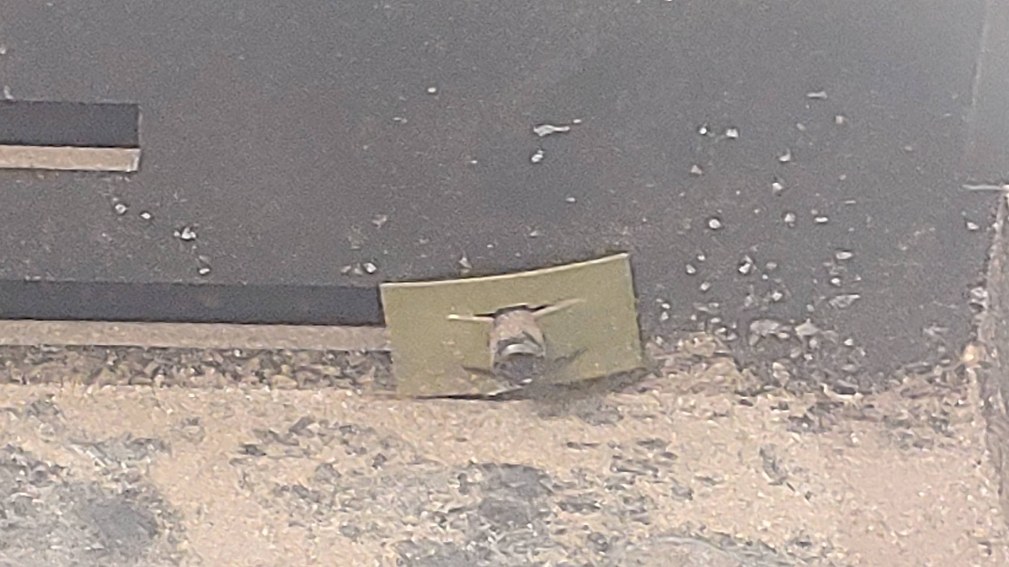

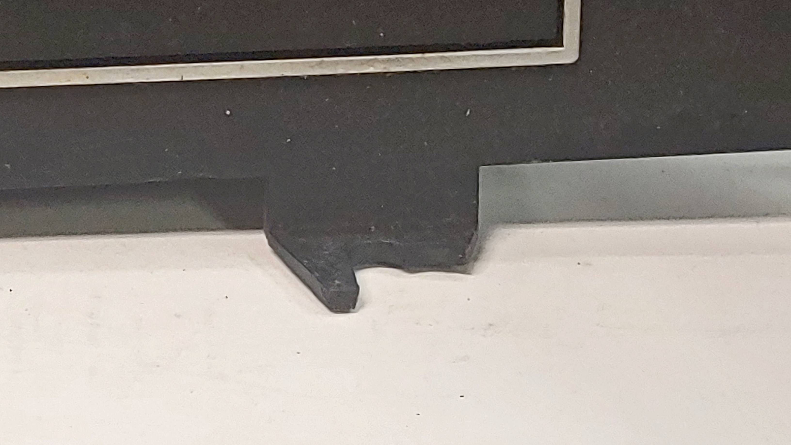

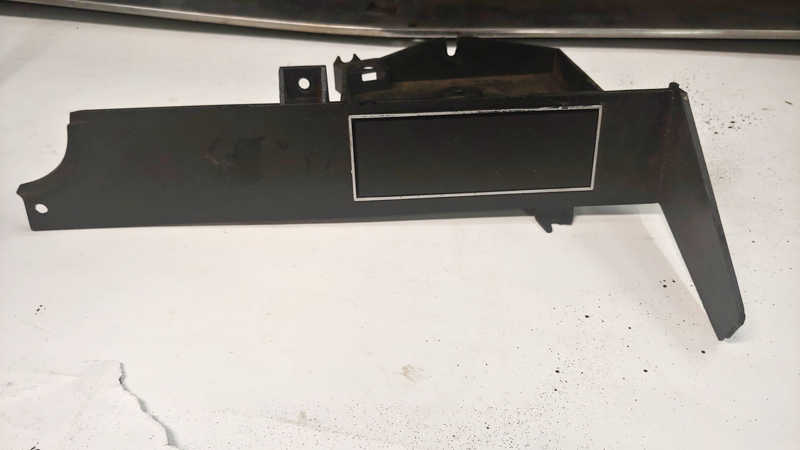

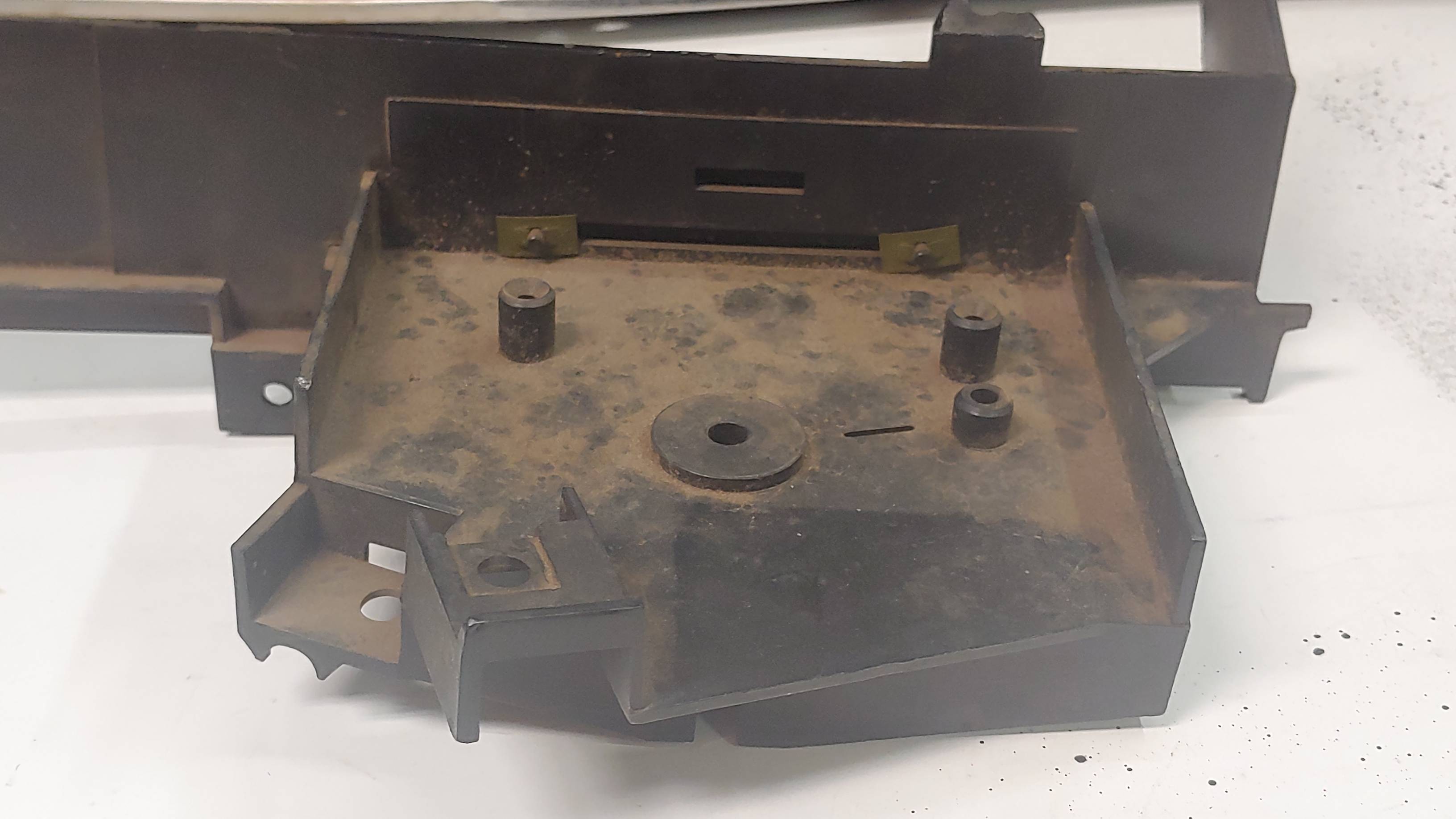

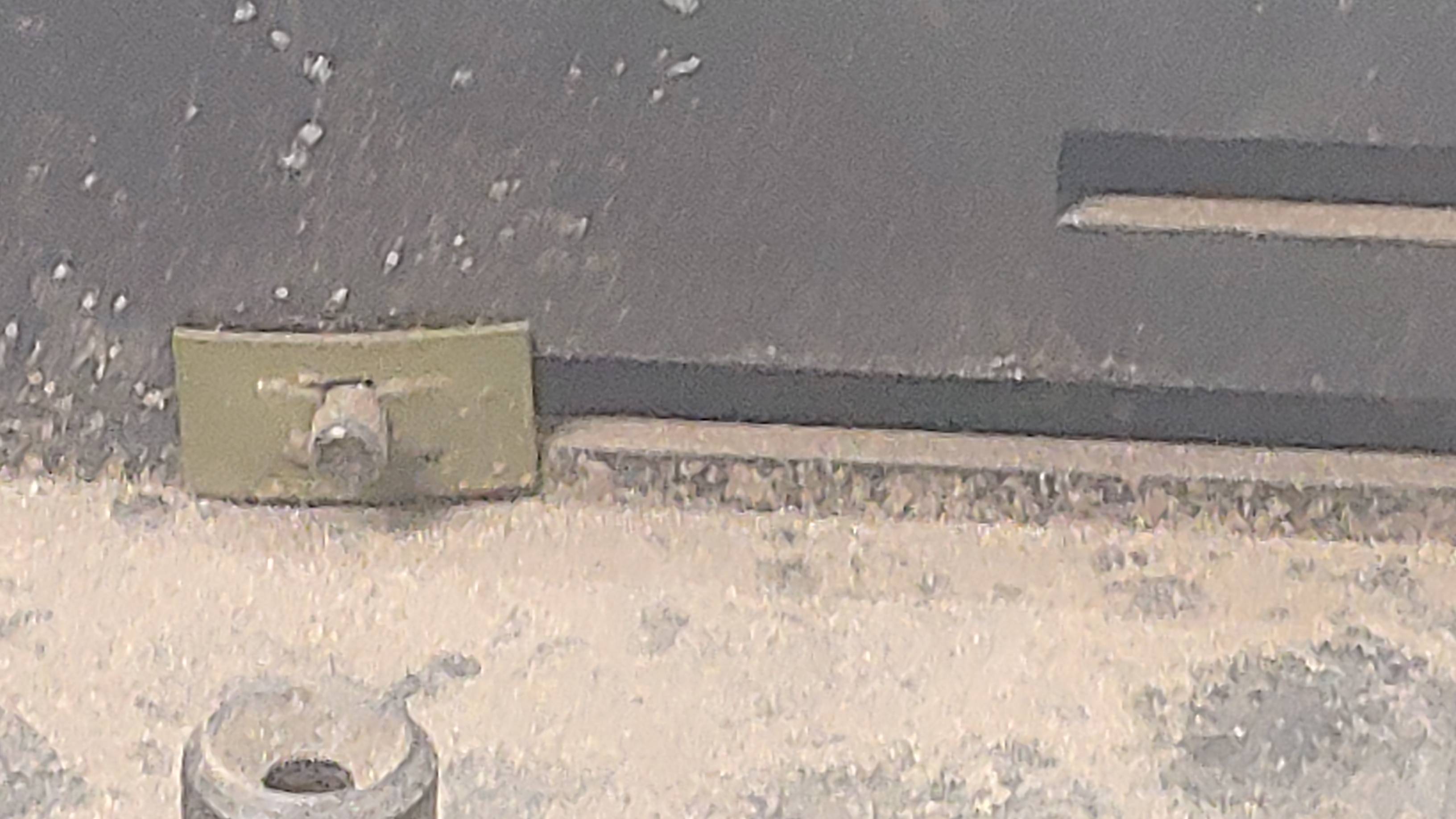

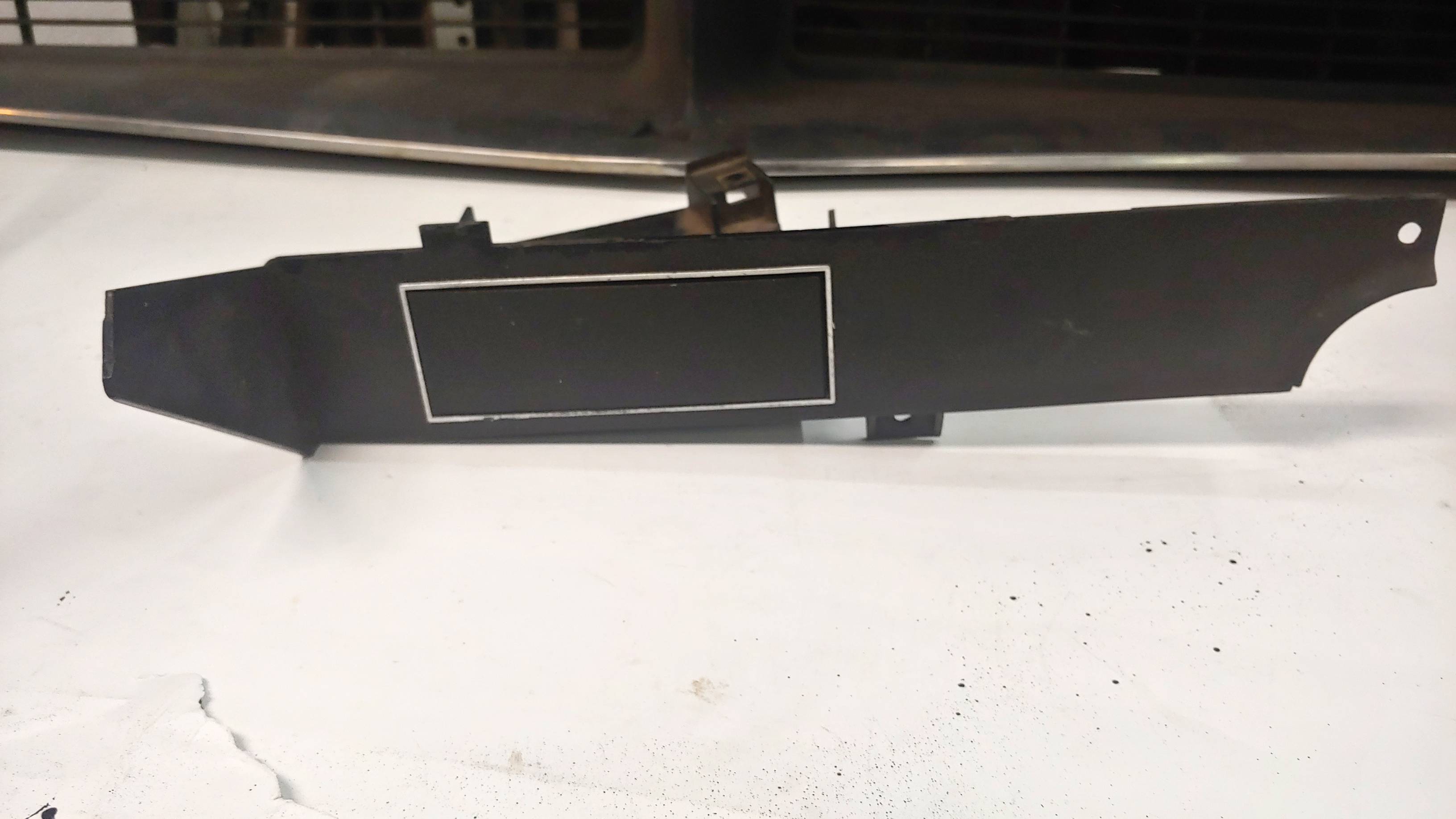

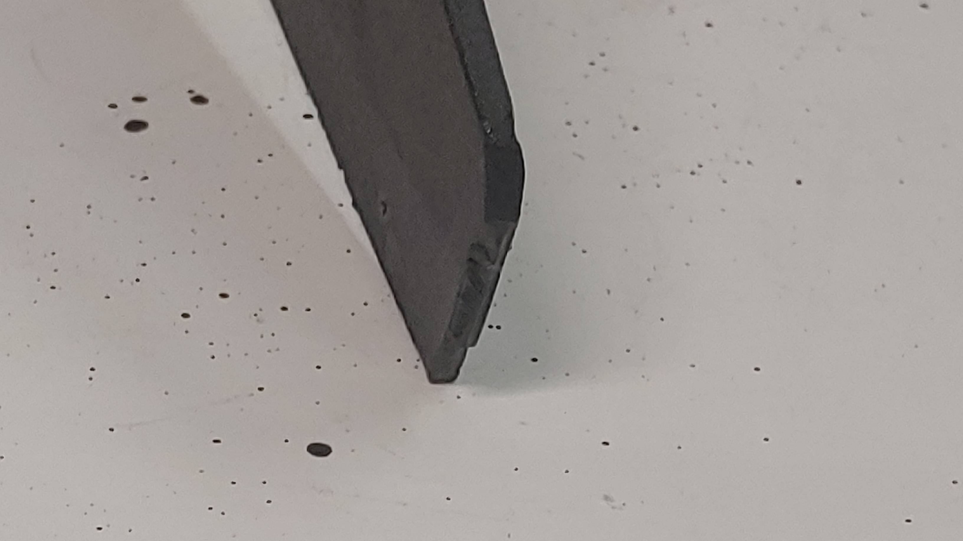

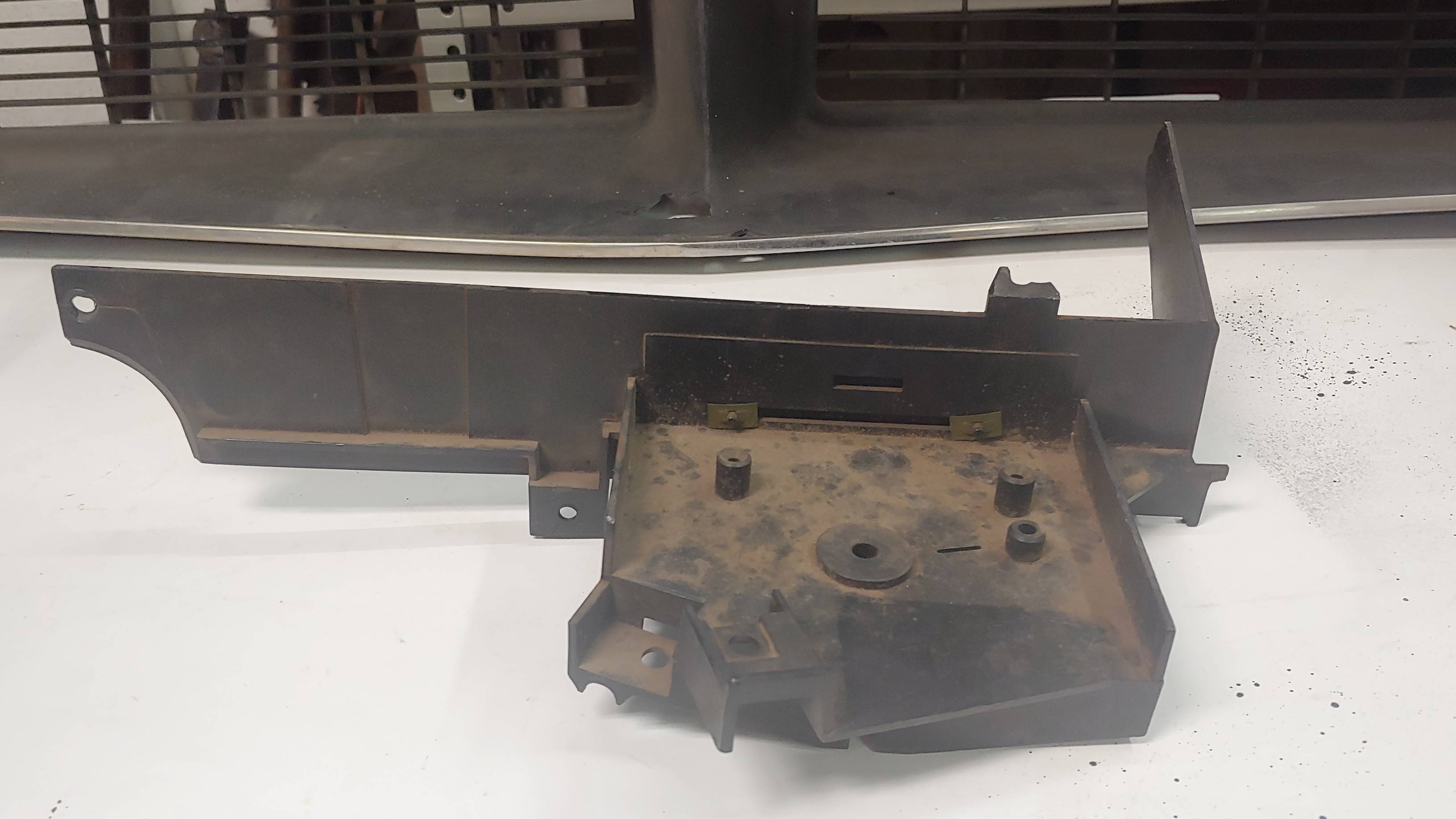

Heater delete trim will be ultra difficult to find. I finally found one this year at carlisle nationals. Paid 400 for the one little part.
The radio delete is easier to find the trim part but will cost you around 300. Don't get me wrong. Your going to look for years before you find this piece (most likely).

Challenger RTA
Oct 28, 2018
2,755
1,373
PA Flood city
