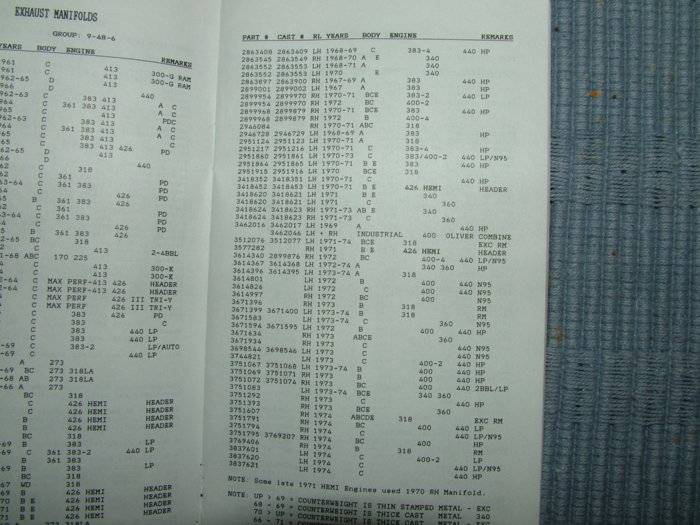

I have a 70 barracuda. I'm installing a 1974 360 without exhaust manifolds or headers. I want to install exhaust manifolds. Are the exhaust manifolds for a 340 or 360 the same for 1970 to 1974? I found a pair on Ebay. The driver side casting is 3416621, Pass side 3418623. The ad said it's from a 72. When I check the references online it says the right should be 2863549 for an e body. Thanks in advance.

Here is a complete listing.

While all 70-74 E body small block exhaust manifolds will interchange, 70 manifolds are completely different. They look and flow better, but naturally are way more expensive than the later ones.
