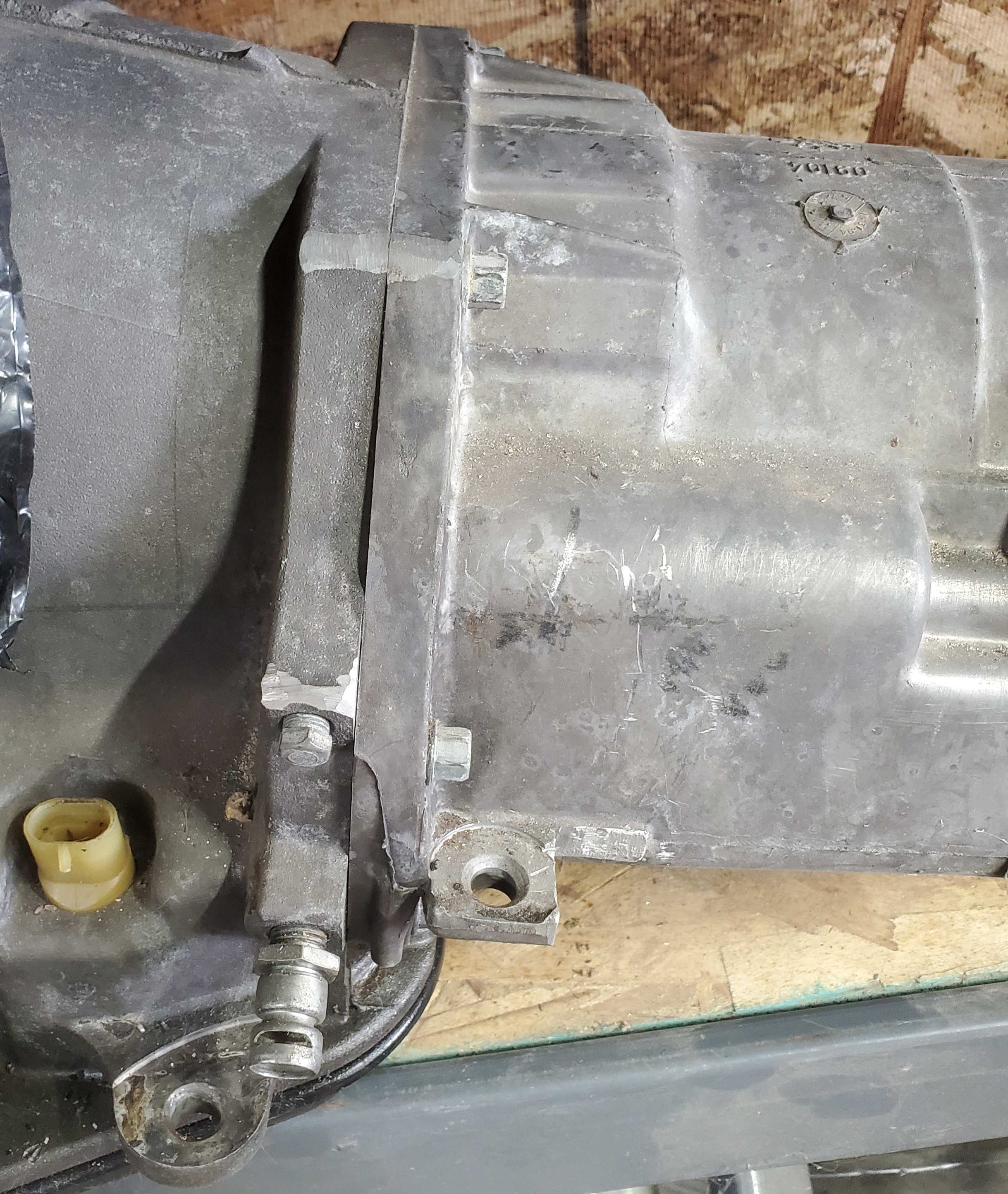

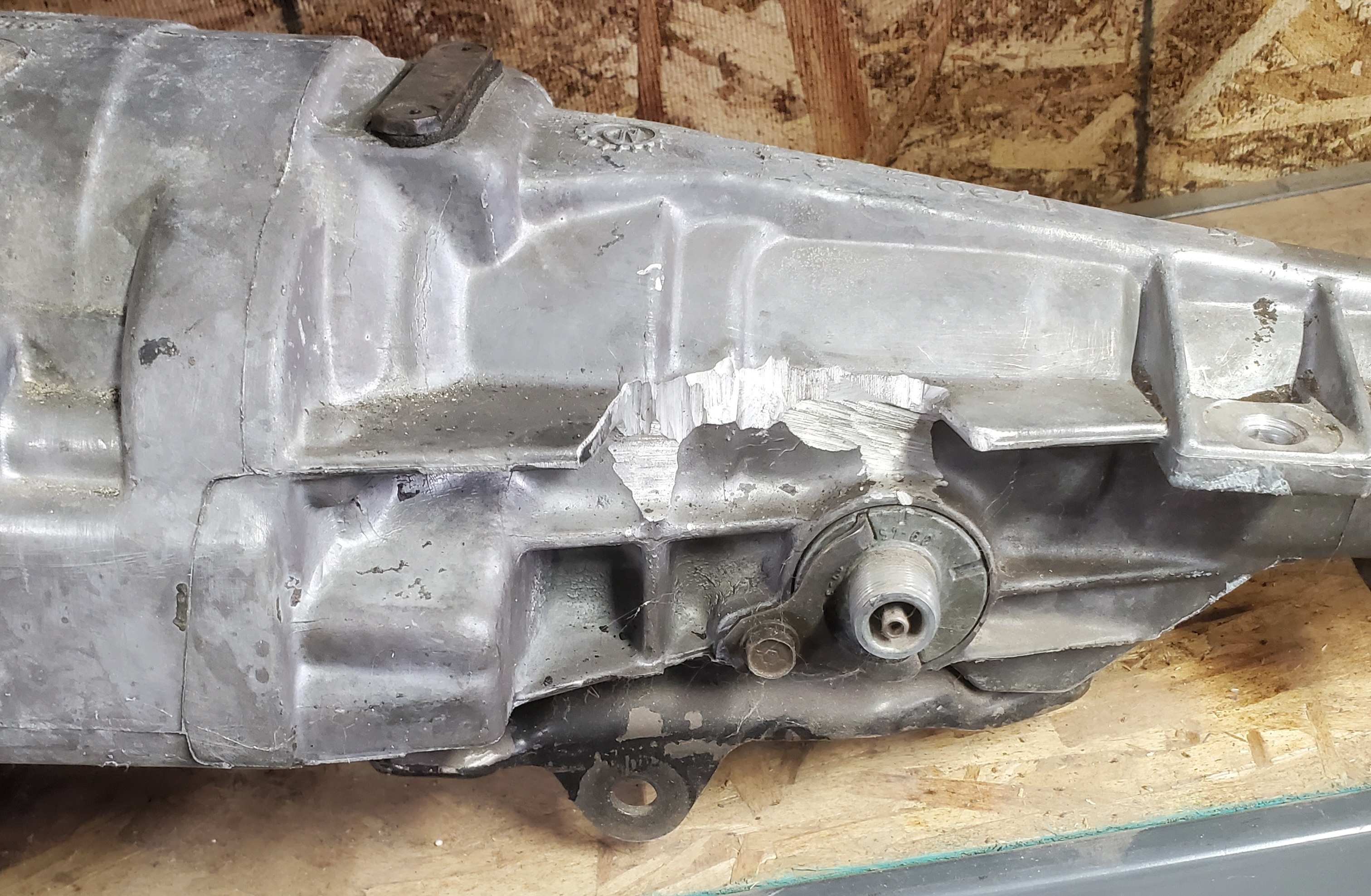

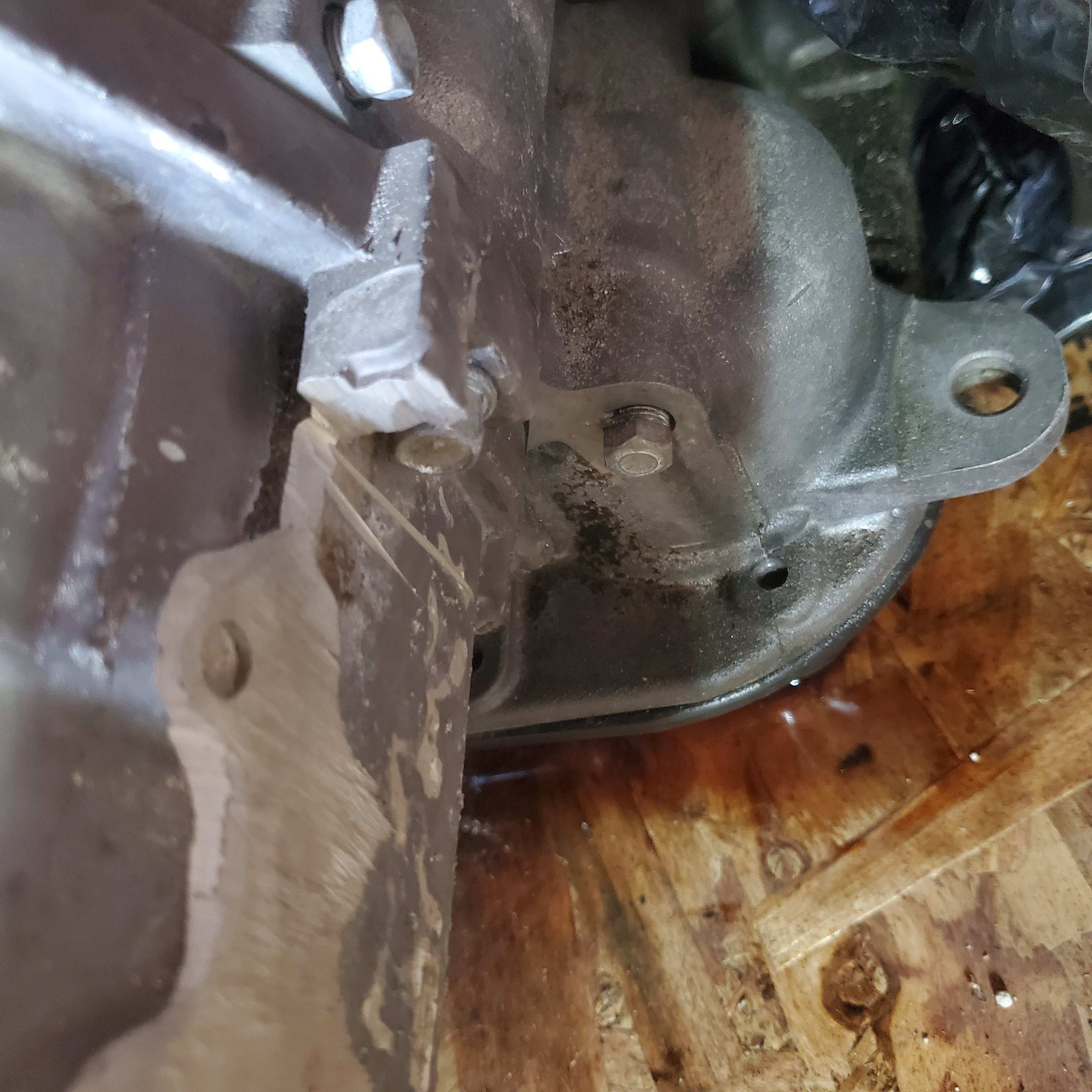

Do a little research on the OD ratios of a Chrysler 46RH (518) vs the 4L60 or 4L80. If the ratio is close to the same, a 46RH would be a lot less expensive. None of them will be a simple bolt in, but a 46RH can be installed into an E body without hacking up the torsion bar crossmember. You just need to trim some of the extra ribs off the transmission.

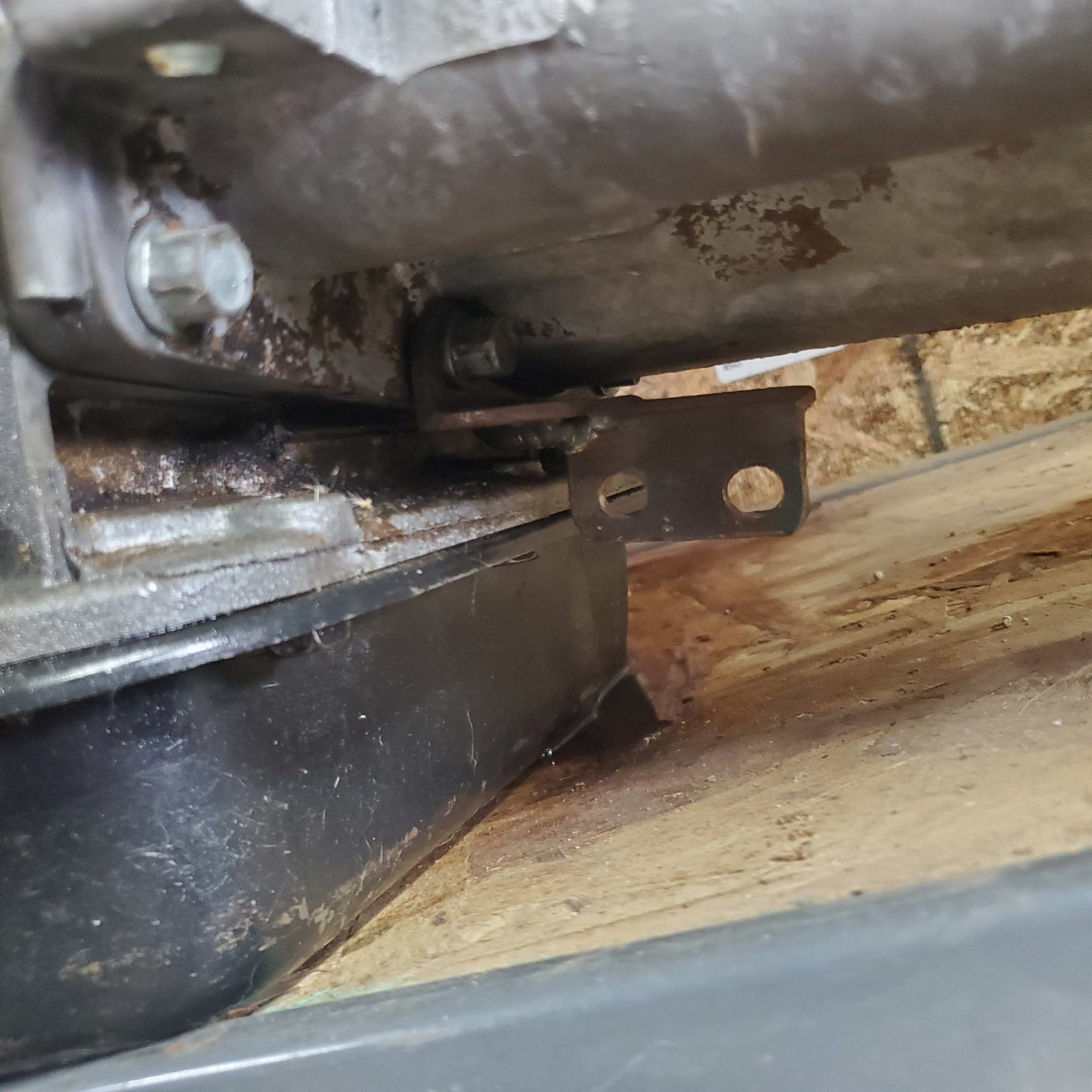

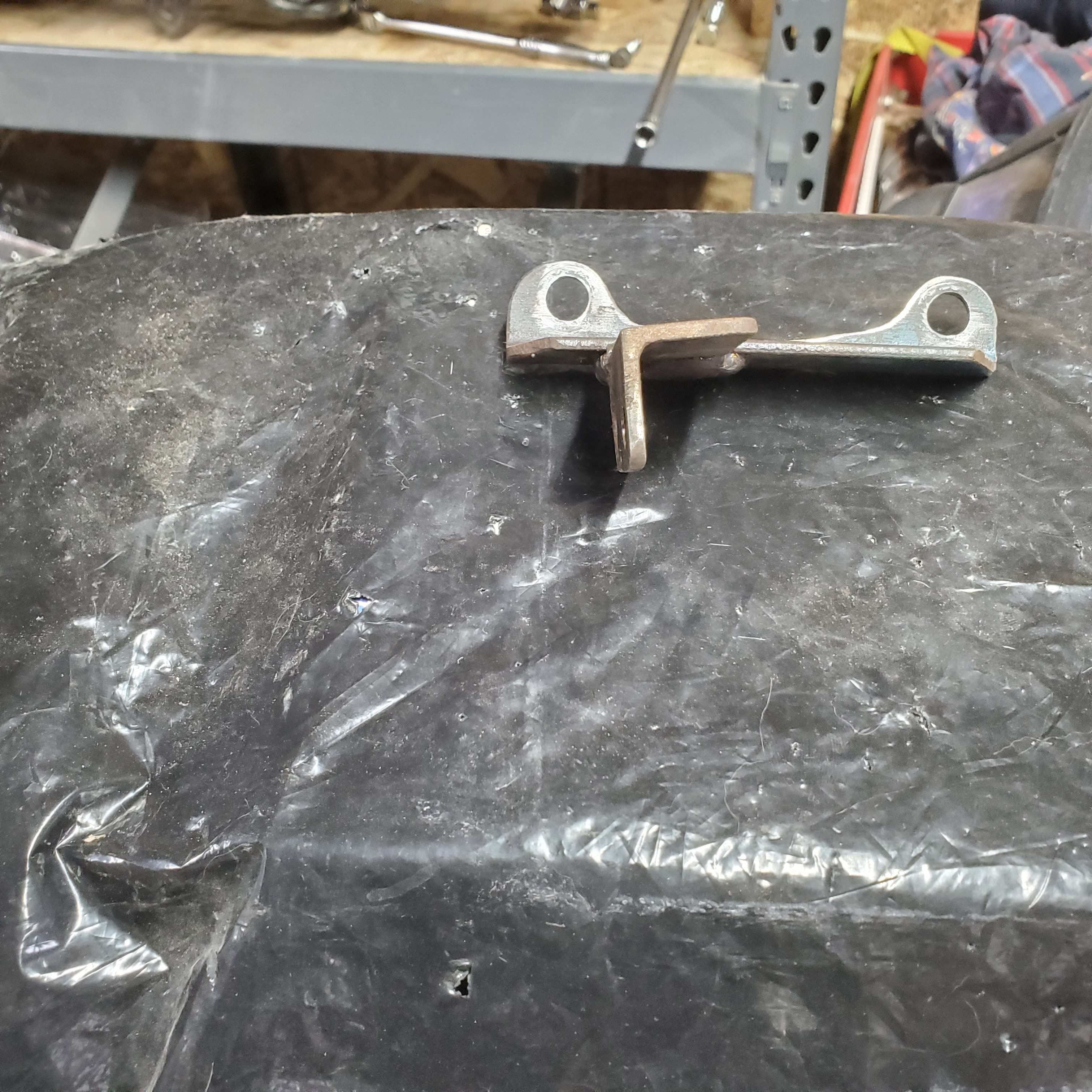

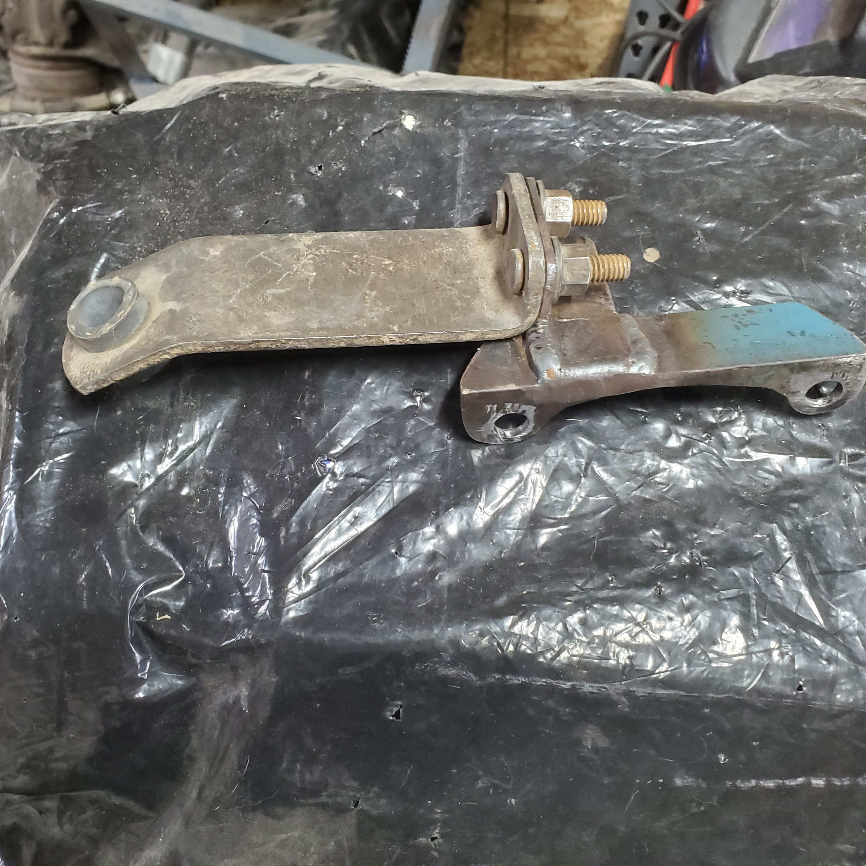

Here's some pictures of what needs to be done for the 518 (46rh) install in an E-Body. It's really easy.

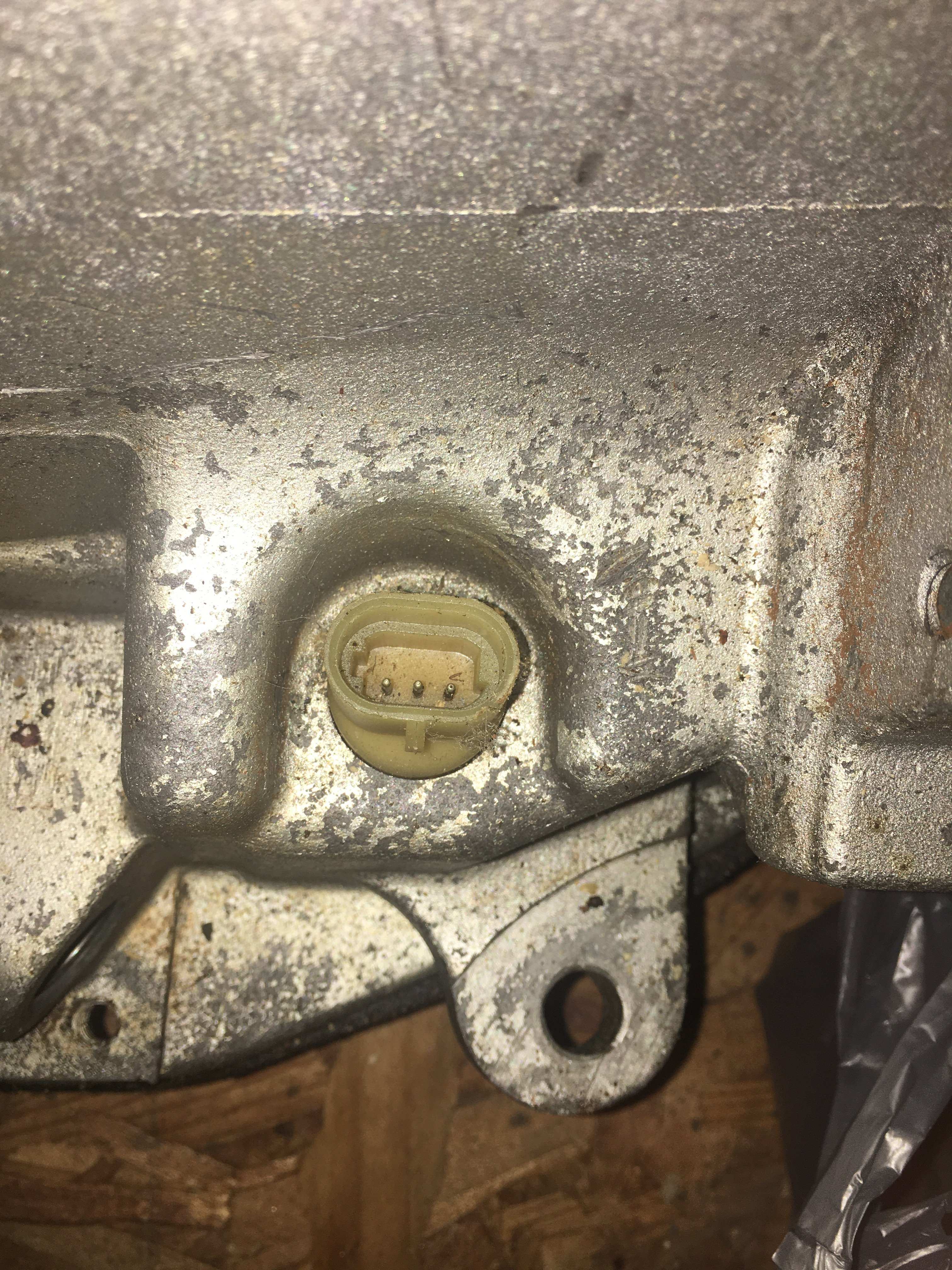

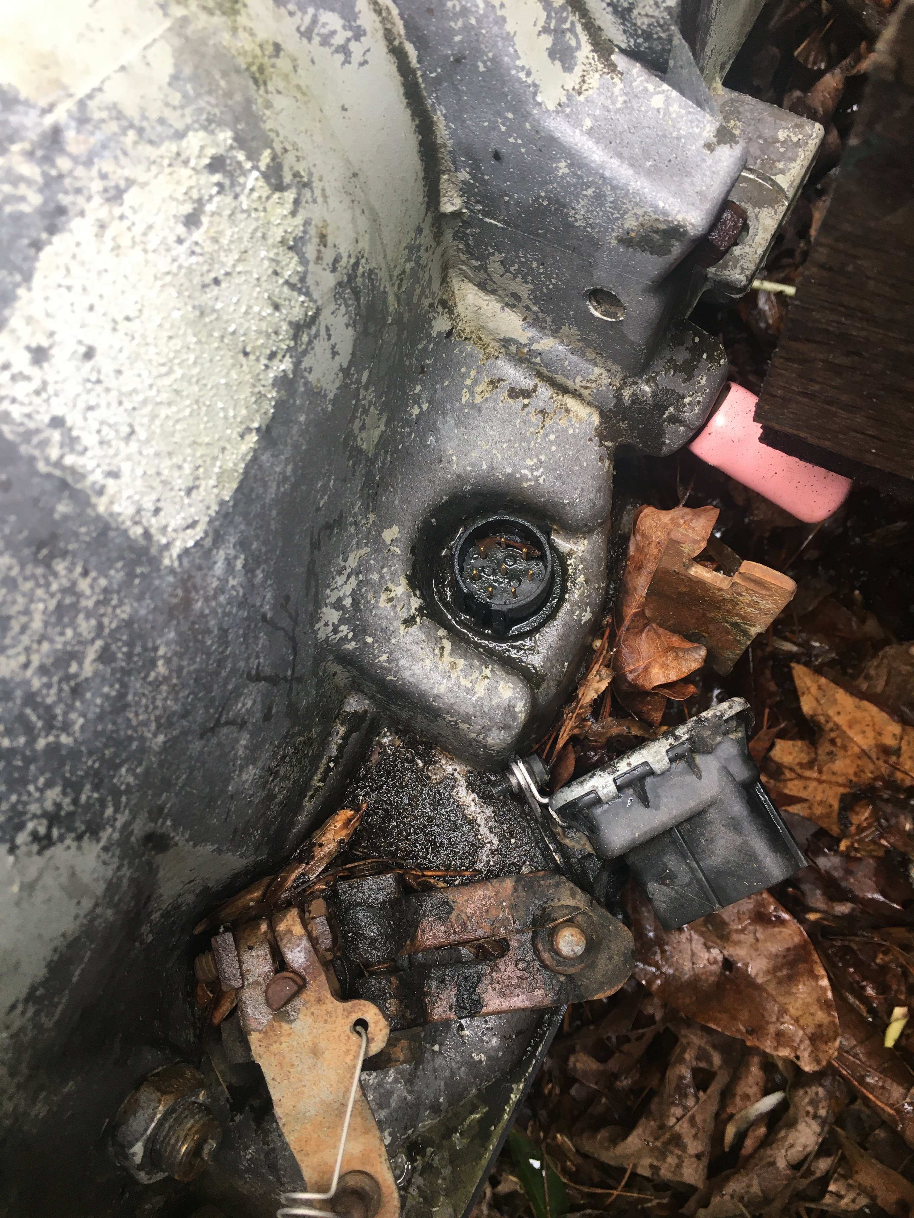

If it is in a 95 van, you may get lucky and it will be the older version that does not need stand alone electronics. If it is an RH, it will have an electrical fitting on the drivers side, up behind where the shift and kickdown levers are. Typically, a white plug that has 3 prongs in it. Not to be confused with the neutral safety switch that screws in diagonally on the rear drivers side corner, just above where the pan bolts on. I will go out to the shop later on, and get you pics of the plug on both an RH and RE.
BSG
Sep 26, 2018
345
72
Great I’ll do pics of mine
