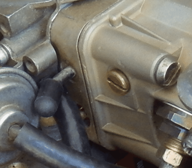

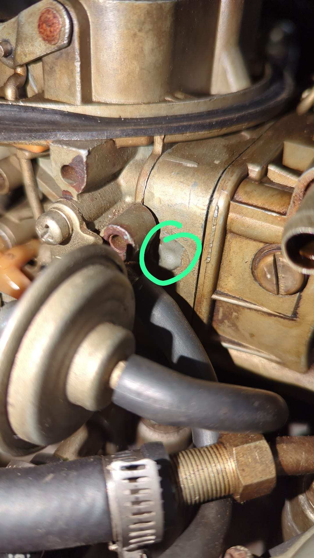

So I noticed the vacuum advance was disconnected when I got my car.. I wanted to reconnect it and found out that someone had blocked off the connector on the carb with epoxy or something like that (pic attached).
Is it possible to just put a T-piece in the line below and connect the vacuum advance there? They are called "vacuum diaphragm supply tube" I think... Or can I get it somewhere else? I am not looking for power gain, I just want it to be as stock as possible.

The opening for the vacuum advance tube is located above the throttle blades so there is no vacuum to that port at idle. The tube you're contemplating teeing into has vacuum all the time. I'm thinking you're going to need to replace that metering block to fix your vacuum advance port. Others with more knowledge of six packs may have an alternative solution. But your are wise that you need vacuum advance for decent street driving.

The vacuum advance port is delayed. Running manifold vacuum to the distributor vacuum advance will cause it to engage at idle and change your timing, increase your idle speed and use more fuel. You really need the blocked off port fixed. It could be as easy as removing that metering block, drilling out the epoxy and soldering in a new tube.

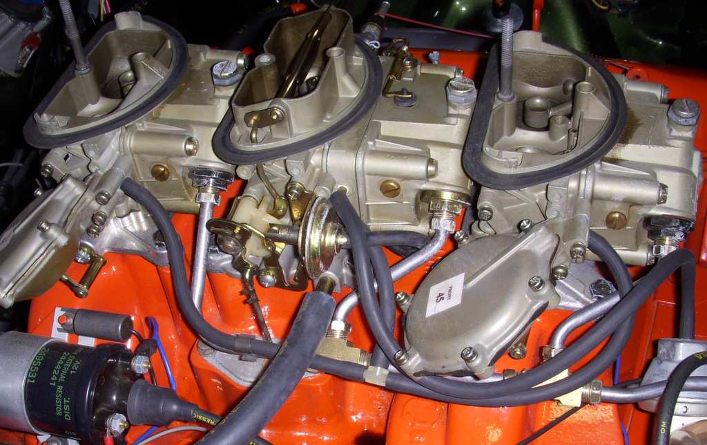

Guessing that epoxy or ? would be easy to remove with a pick without removing anything. Clean /vacuum it and the nipple that goes in there is a light press fit so I used a dab of sealer and works great. Then you have a stock setup like this.

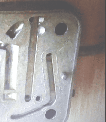

Normally one would cap the port. Maybe it had broken off?
Maybe just rebuild the carb and repair while apart. I wouldn't think it would be too difficult drill out and install a new tube.
The backside of a 6020 block..........

I had a similar situation, I epoxied a short section of brake line into the hole making sure to not plug the vacuum port up. When the hose was attached, you could not tell the difference.
