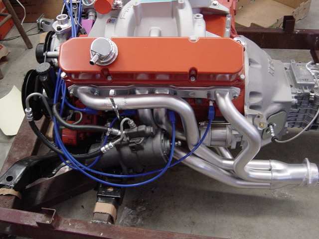

I have a Tremec 5 spd behind a 440 and it fit great (Original 340/4 spd Challenger) No cutting or other issues, and the shifter came up dead center in the original shifter hole. I used Kiesler bellhousing and a hydraulic clutch for simplicity. The eng/trans sits on factory style eng mounts and trans cross member.

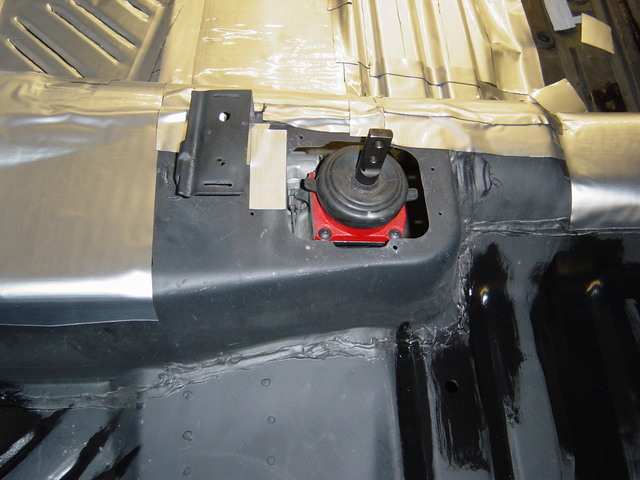

Yes. They said I had to use a console with a factory offset shifter. Only then would the shifter be in the stock location. Years ago I drove a 70 RR with a aftermarket 5sp and could not get used to the “new” shifter location after driving Mopar four speeds for 35 yrs
Mopar Nut
Aug 10, 2014
1,390
1,070

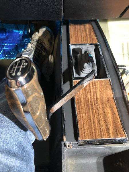

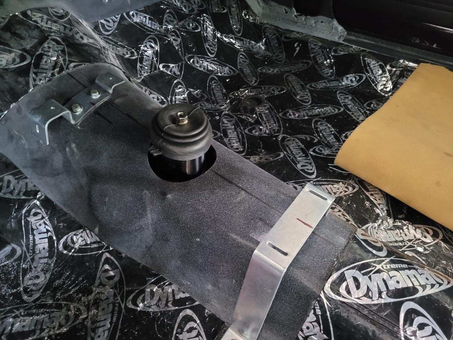

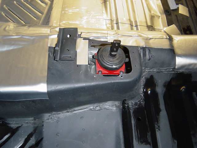

Yes. This is a console application - I have no console- non console from the factory
Sounds like you need the console and brackets that can be easily bought. Something like these below.
