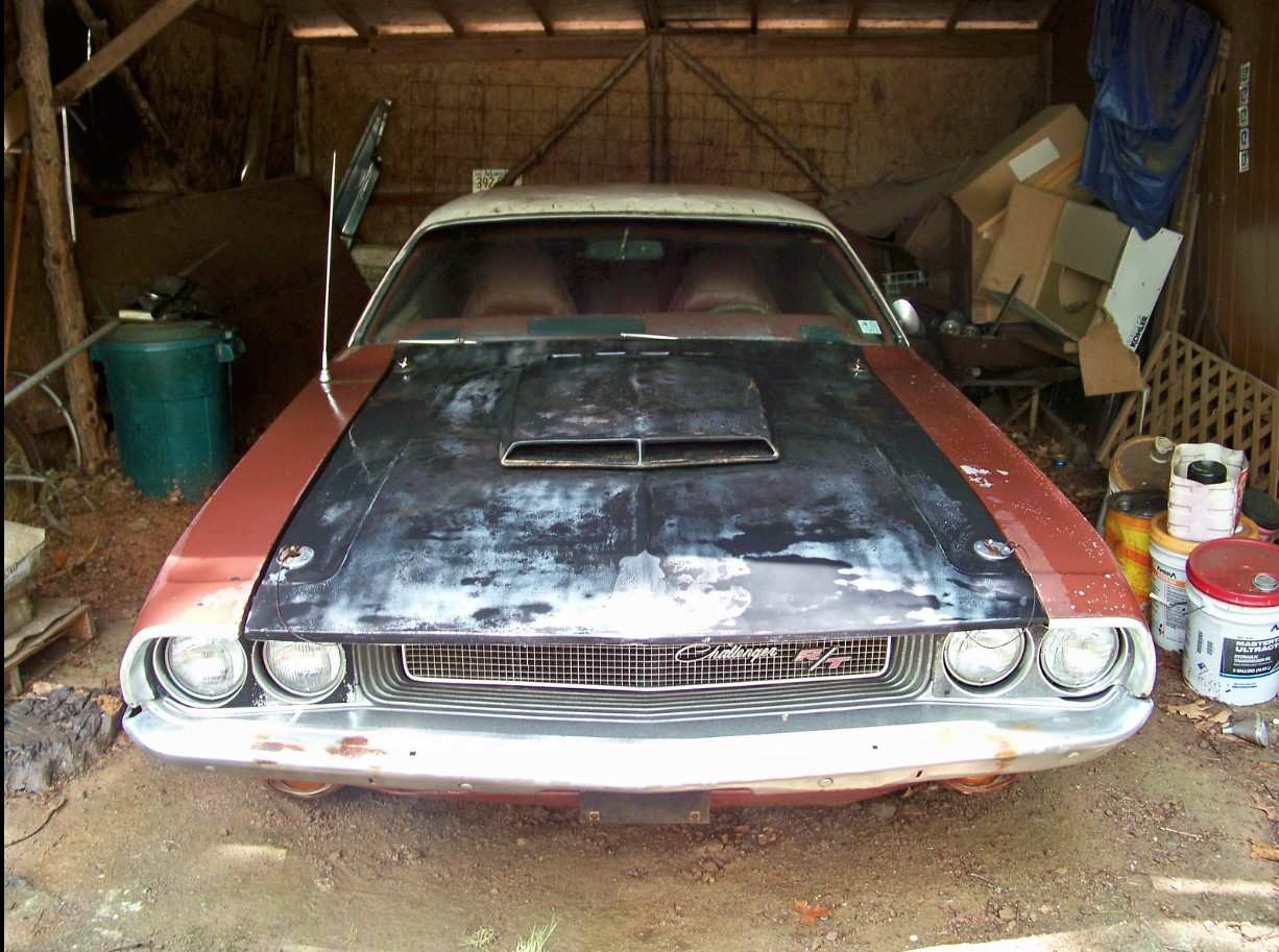

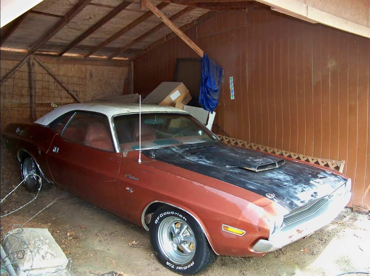

I am looking at a 1970 challenger about to come up at an estate auction and would like to use your collective and vast knowledge. After contacting the auction house and asking they sent me photos of the rust . fenders are rusted thru, rockers need replaced, floor pan on drivers side rusted thru and with the water staining in the carpet i assume all floor plans are gone, the car was washed sitting in the lean to shed and has water s leaking into the back seat where they washed it and it is a vinyl top car that is gonna need the roof skin replaced. I could not see inside the trunk but assume the trunk area is no better. This car is a 318 car with a six pac engine aand hood and T/A badges installed. And to top it off the car came from 12 years of New York salt according to the title. I know the body is mostly rust in the shape of a beautiful car but what would it be worth for what is there? would the engine and hood bring anything now?is it worth me trying to buy it and save the parts i can ? or are the cars getting where even saving the car is a viable option? thanks in advance for all of your helpful input

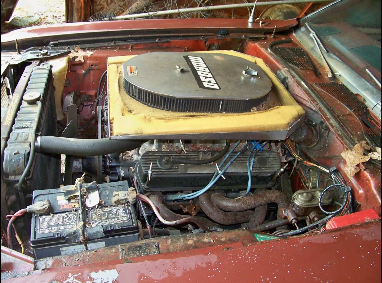

If the hood is a real T/A hood and the motor checks out to be a real T/A motor and not just a six pak on top of a standard 340 then you could make some return money on that. T/A motors bring between 4K and 14K it seems and the hood, 2K to 4K depending on how condition.

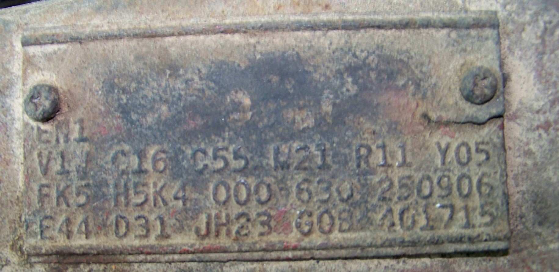

Can you post the fender tag readout? That would help with an assessment of worth. It might be a parts car.

Is the 5th letter in the vin a G or J ?
G is just a 318 car
J is a T/A with the engine replaced & is valuable .

Think of it this way, price of car plus half the value of parts you need to put into it is the net worth when it's done. Your labor, unfortunately, adds no value to the car. Need to make sure it's not a 318 with a six pack intake and carbs. And as Cuda Hunter mentioned, 340 six pack motors had a different beefier block than standard 340 blocks.

Fenders have TA badges not the hood. No lettering at all on the hood just the scoops and looks to be Fiberglas but that remains to be seen

6 i conuldn't confirm a TA block just a 340 block (header tube in the way)
7 sixpax was aftrmarket and stuck from sitting
8 TA hood was good and possibly original

12 verified it was a 318 car with badges ( still had the 318 stickers under the hood)

For posterity. JH23G0B401715
It appears the hood was clear coated and is now peeling? Or is that aftermarket fiberglass, white, showing through?
Apparently missing it's vin tag on the dash.

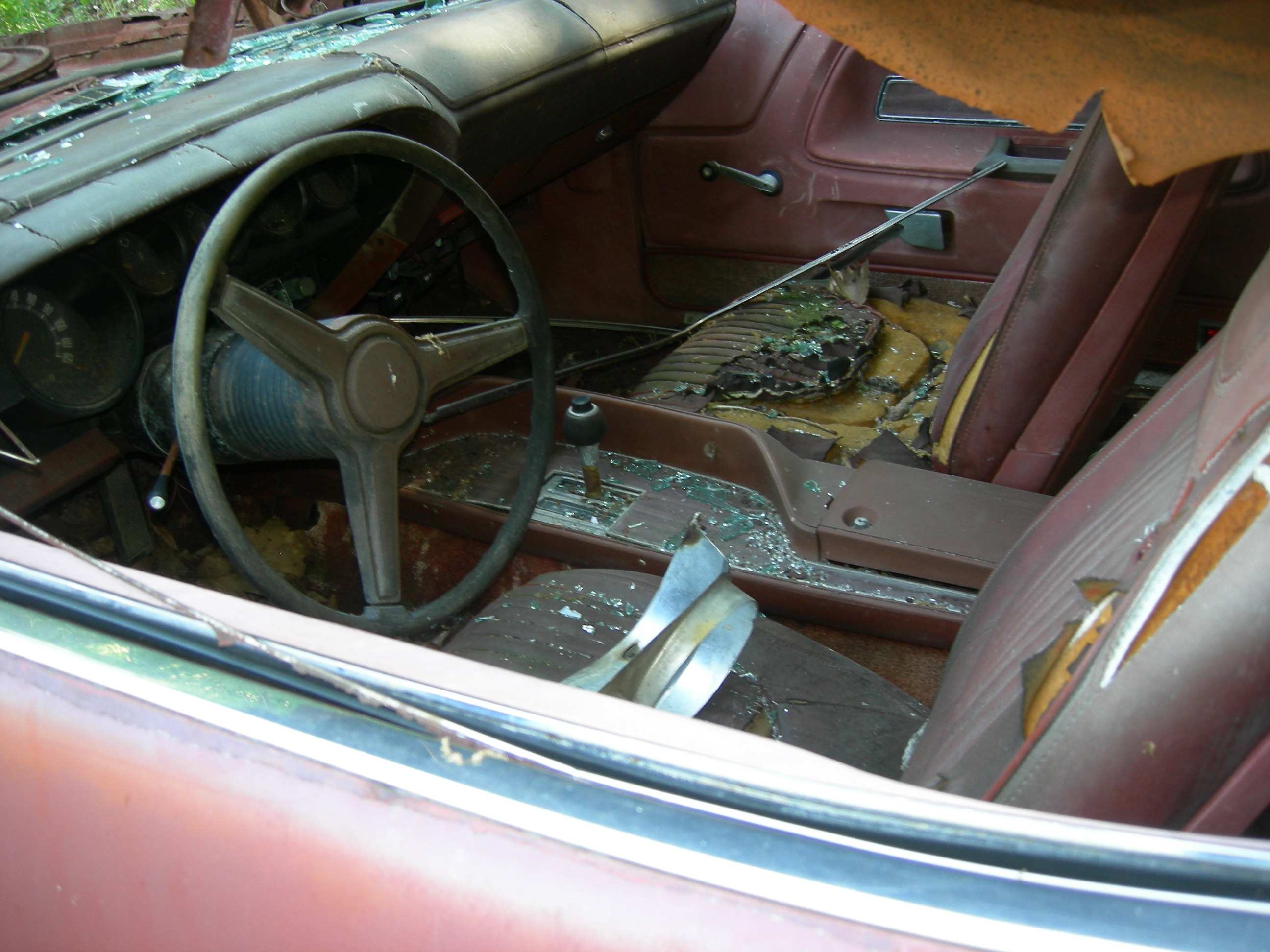

Unfortunate that left drivers side dash is kinda bungled up as it has no cracks in the middle as usual.
Water leaking in the rear window onto the interior seats.

Looked like the clear coat was burned thru by years of sun but I am not very paint knowledgeable I can just say for sure it was Fiberglas. And the car showed well on photos til you got to it in person
As you can see in the photos

Yeah, I agree. I can smell the mice through the pictures.
It does appear decent through the pictures until I enlarge them and really comb through the parts.
