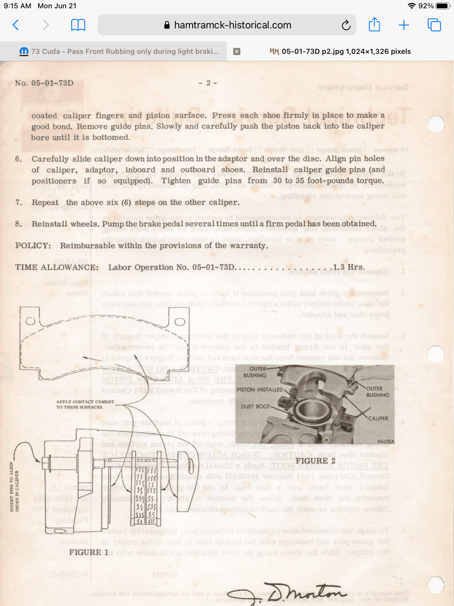

Might be way off base here, but it might be the pad vibrating. Hard braking stopped the vibration but light braking allowed the pad to oscillate causing noise. Had a similar problem with my slider pad on one wheel one time and I had to tighten the outer pad to an interference fit then no more noise. Wild guess here because hard braking stopped the noise. If pin type, maybe a loose fit between the pin and pad. Read somewhere in a Mopar service bulletin that recommended an adhesive be put between pad and caliper to stop noise. Total off the wall guess.

I thought about that also and did have the paste from another set of brakes, so I wiped that on the back of the pads and shims. No change unfortunately.
Well it wasn’t a paste. The stuff I used (and I still have some) went on wet but when it dried it was like rubber so that it absorbed any vibrations from the pad.
