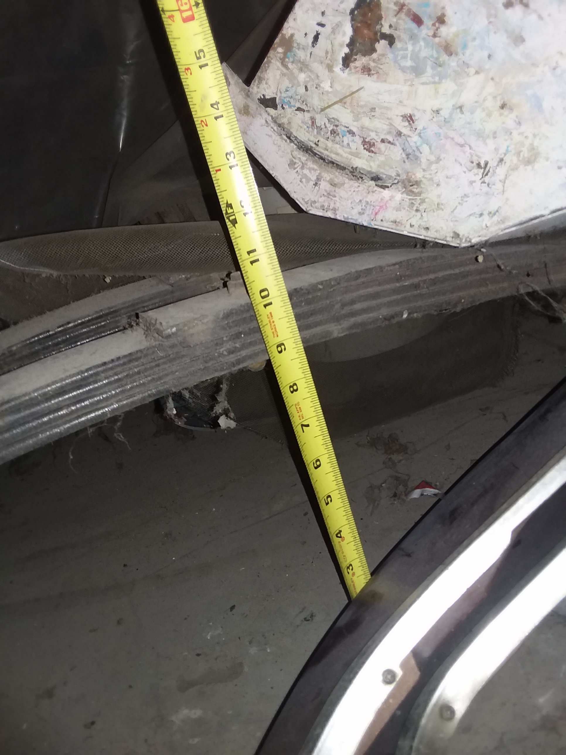

I have a nice set of originals, that I haven't used for fear of being too high.
Sitting on the spring eyes, hard to read without dragging them out, but I would say 8.75".
