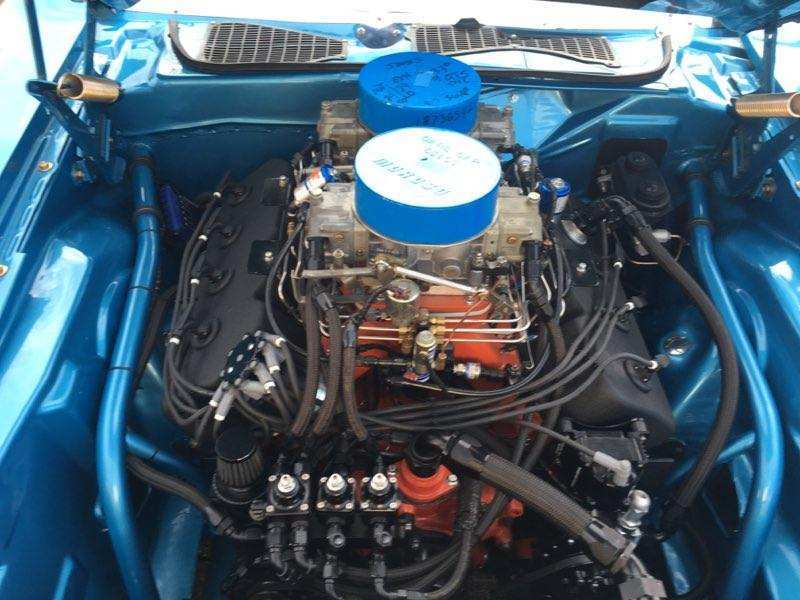

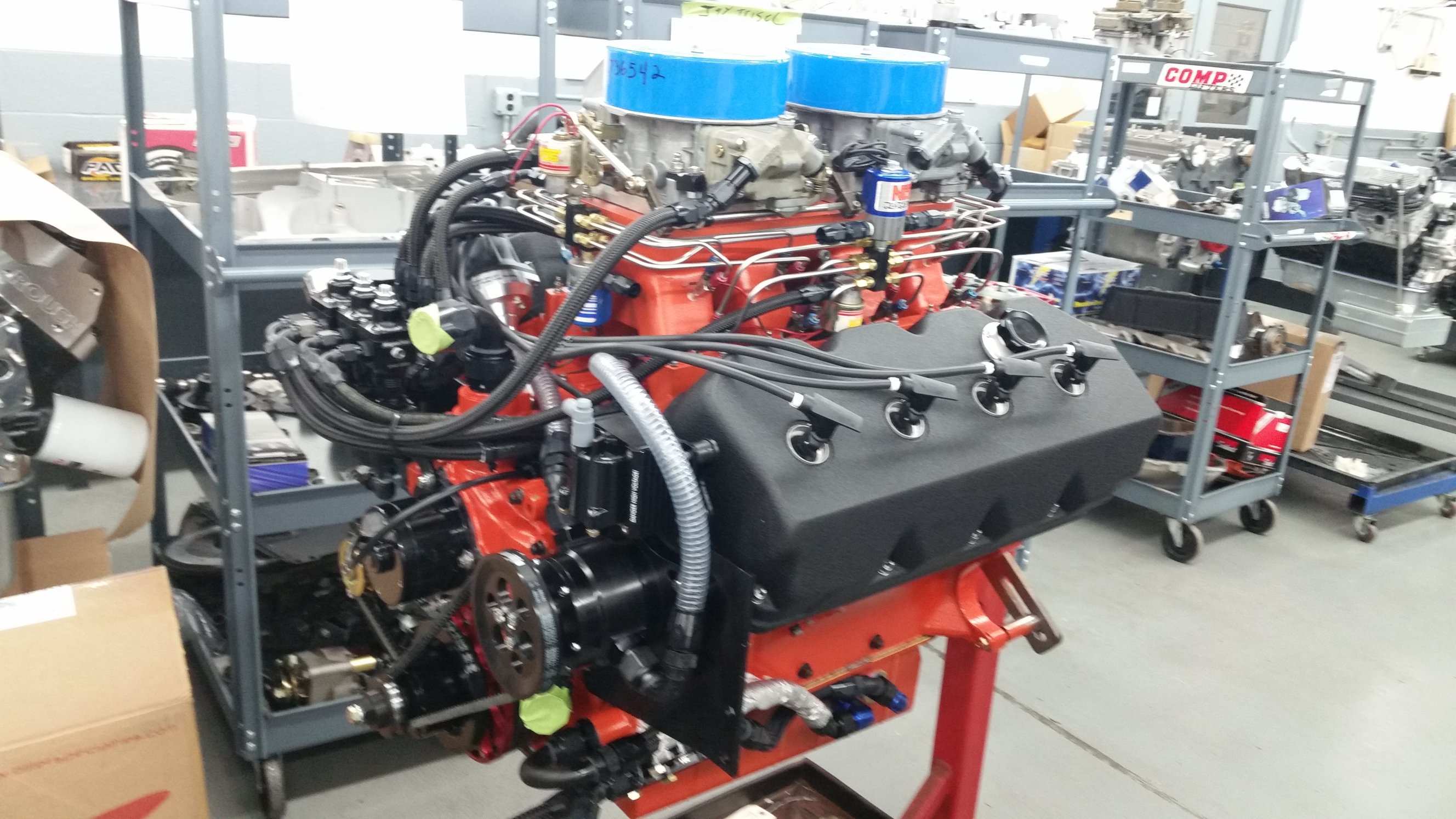

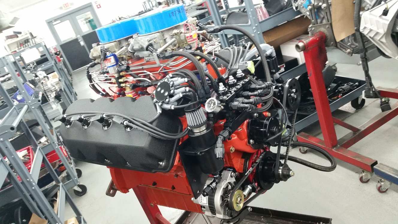

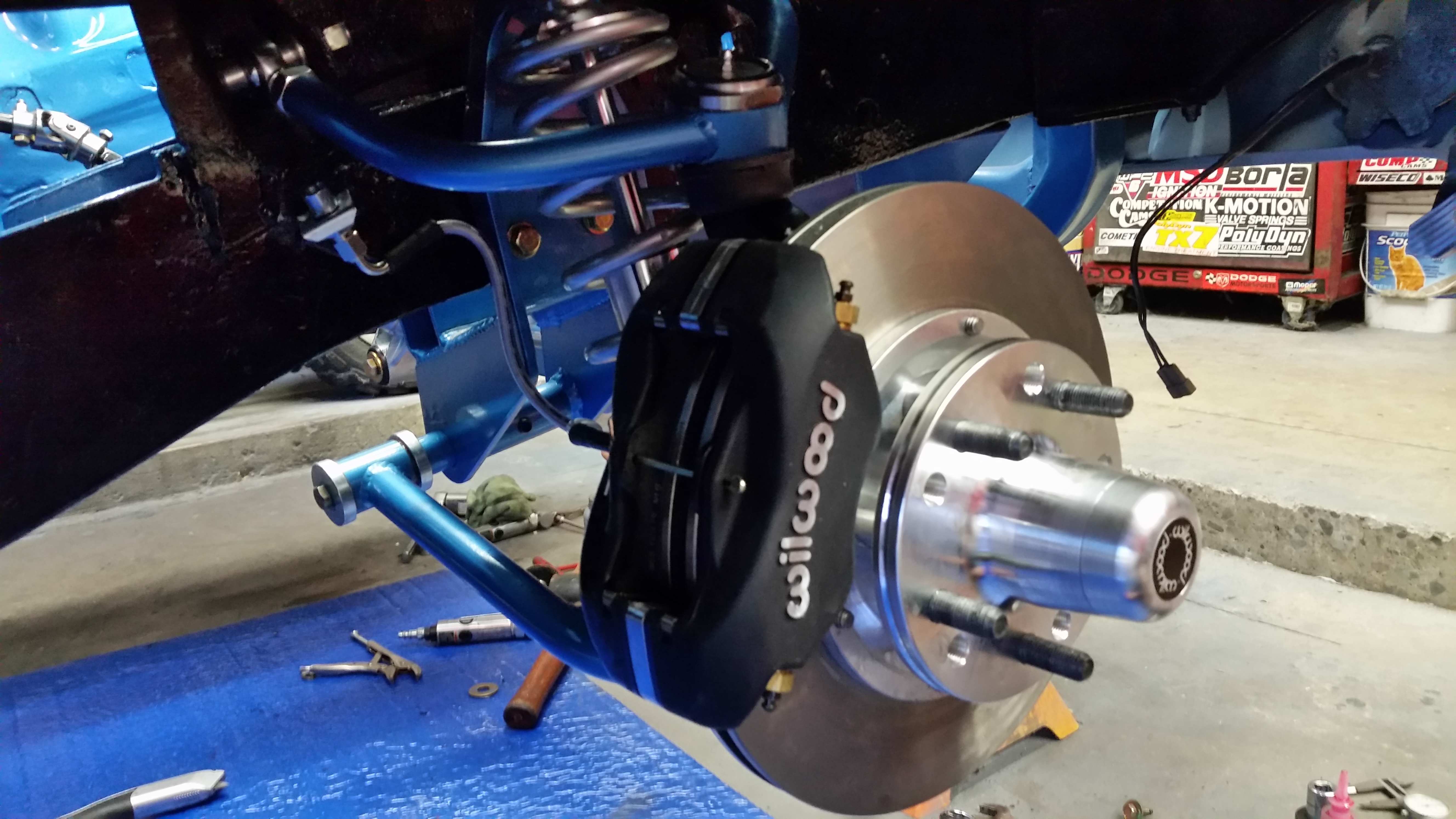

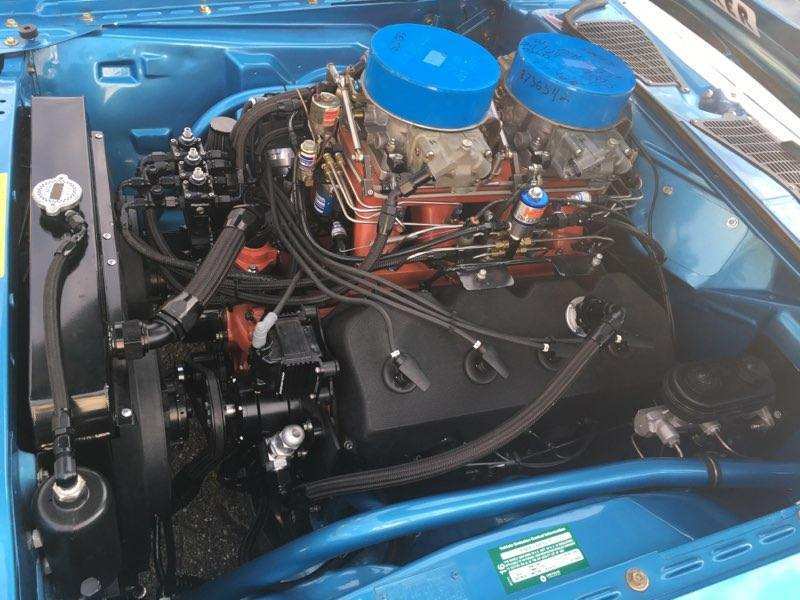

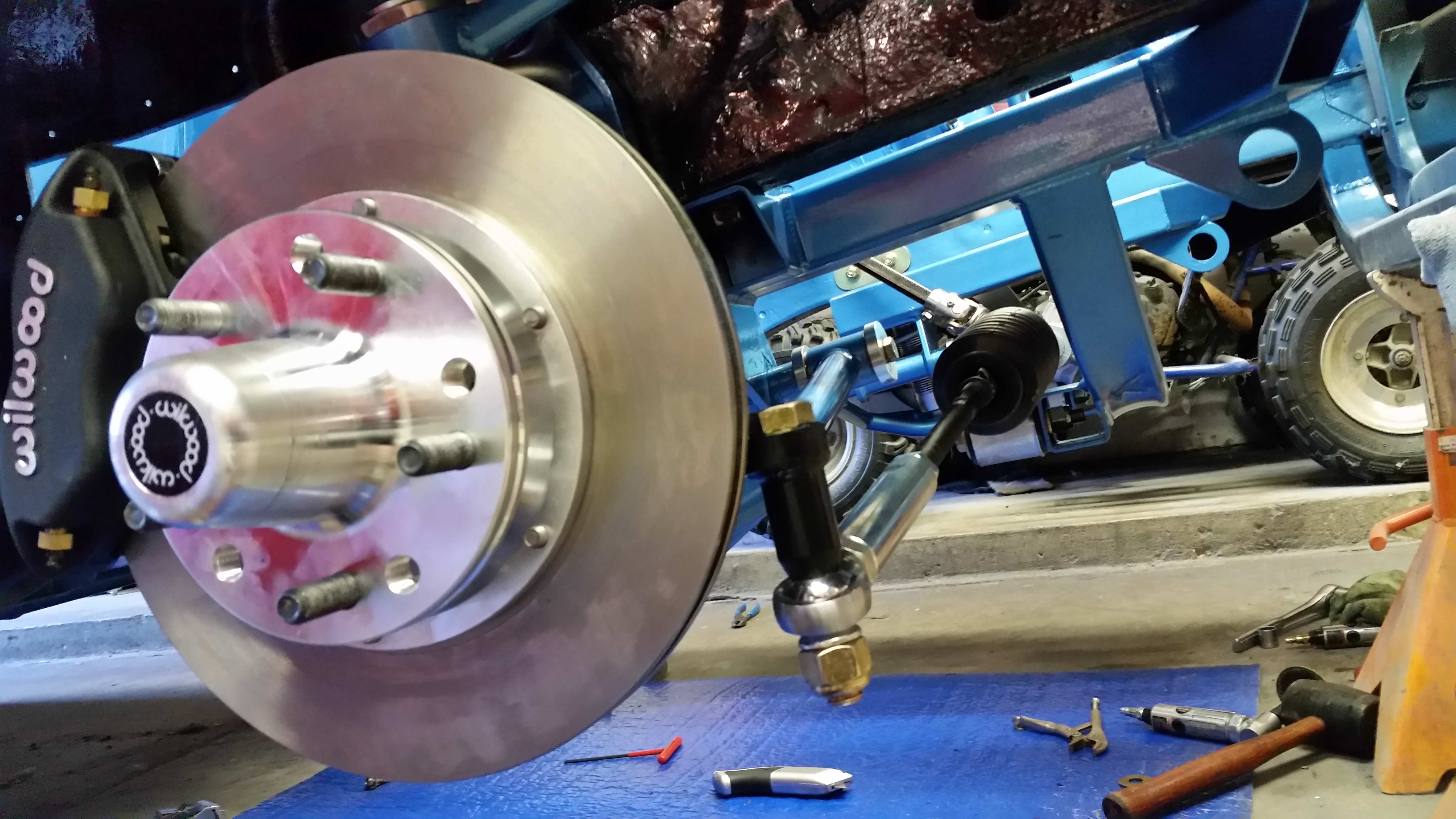

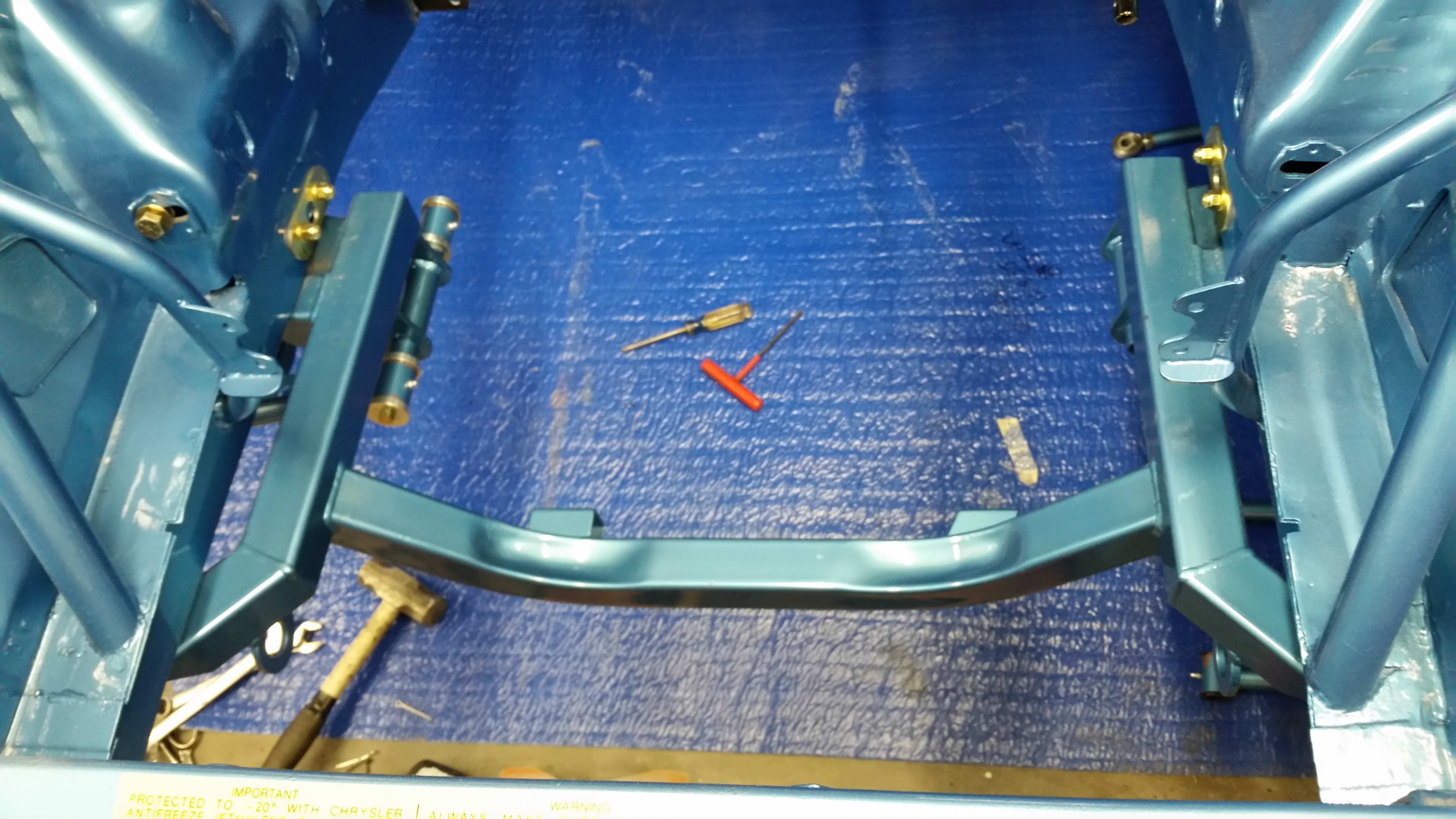

3/4" is alot. Are the ride tech arms different length from side to side? That far off wheels wouldn't even be even or equal within the wheel well openings. Nothing wrong with a stock front end rebuild. Depending on your over all goals. I have the alterKation front suspension kit on my Challenger for street/strip use with no issues. The advantages are lower ride height, less weight, more suspension travel, no torsion bars, I can install both sides 2nd Gen Hemi headers all welded together into 1 piece headers from underneath with engine in car in like 10 mins. More oil pan ground clearance and allowed to run a flat bottom 10 quart top fuel dragster/funny car type oil pan.
