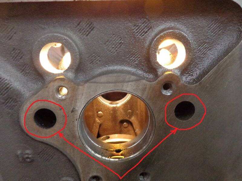

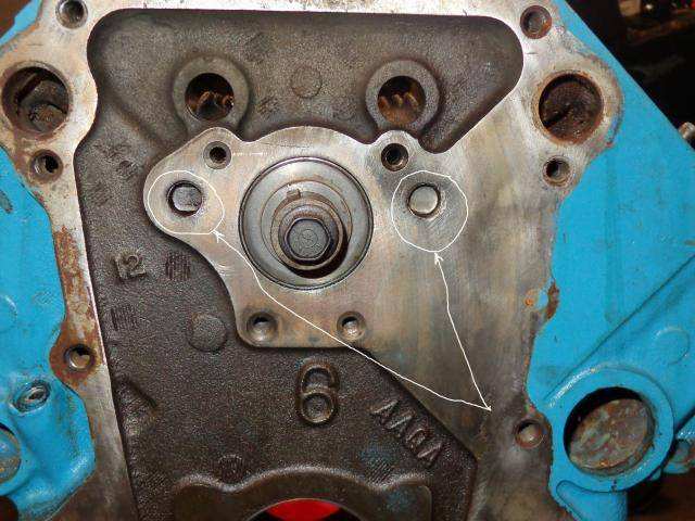

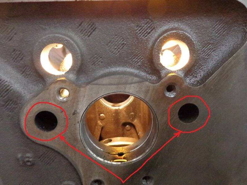

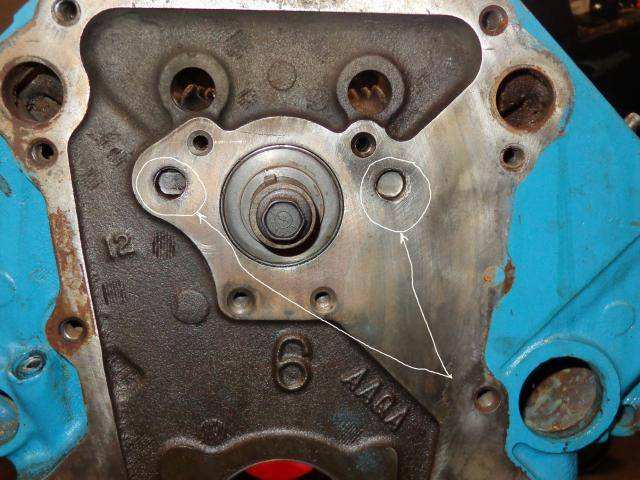

Have started my rebuilt 413 engine. It is still in the brake-in stage. When cold, oil pressure is above 50. As the engine heats up, the pressure begins to drop and settles at about 25 psi at idle (Approx. 900 RPMs). I brought the RMPs up to 2,500 and the pressure went back up to above 50 psi. Is this normal, or do I have a problem? The oil in the engine is 10W-40, Sensor and gauge are new. Do I need to go to a different grade/weight oil or use an additive?
Also, how many miles is the 'break-in, stage and what is the maximum spead I should go?
Thanks fellow members
I had a similar problem with that on a small block and it turned out that the machine shop left out the oil galley plugs for the lifter bores that are under the camshaft thrust plate...
That is so crazy. Good thing you notice it before you assembled, installed, and mounted it to the tranny. I think Mine is ok. I would have seen a mess of oil ont the floor when the engine was on the stand and I was priming the oil pump.
Thanks for the info. Another thing to be mindful of on the next rebuild.
