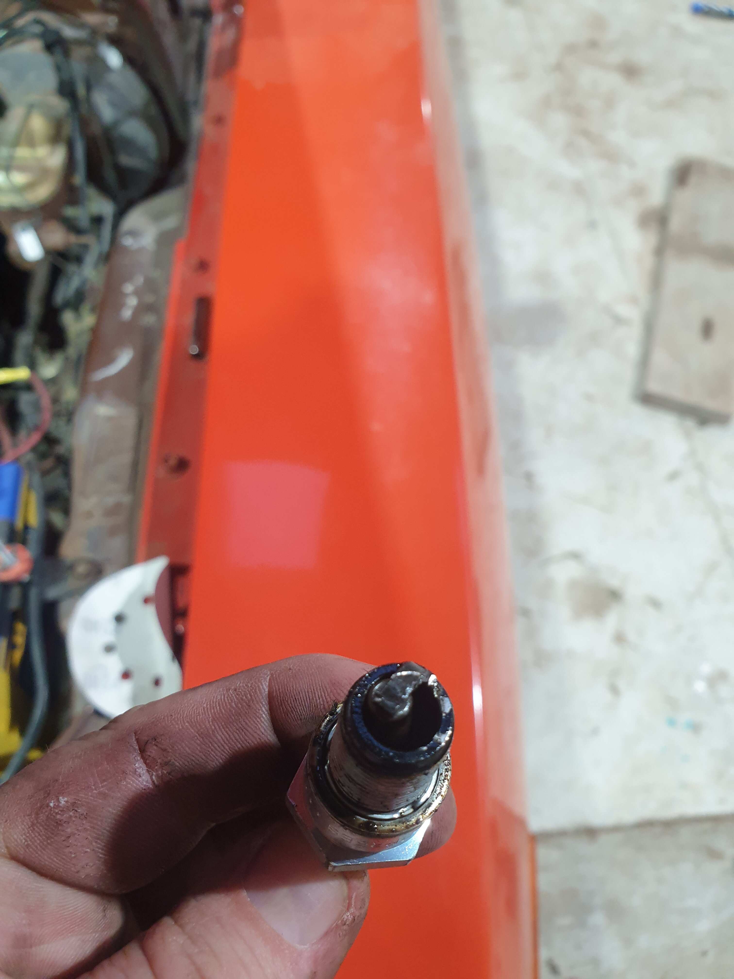

I was starting my 72 Barracuda 318 from cold, when I heard a bit of rattling (like a spring came loose) Then I noticed it was running very rough and would not idle.
I pulled all the spark plugs and noticed one of them is rather damaged...
Photos attached.

Something must have been dropped into the carb & Got past the valve into the engine , you can use a boroscope to look inside but I suggest you need to pull the head off

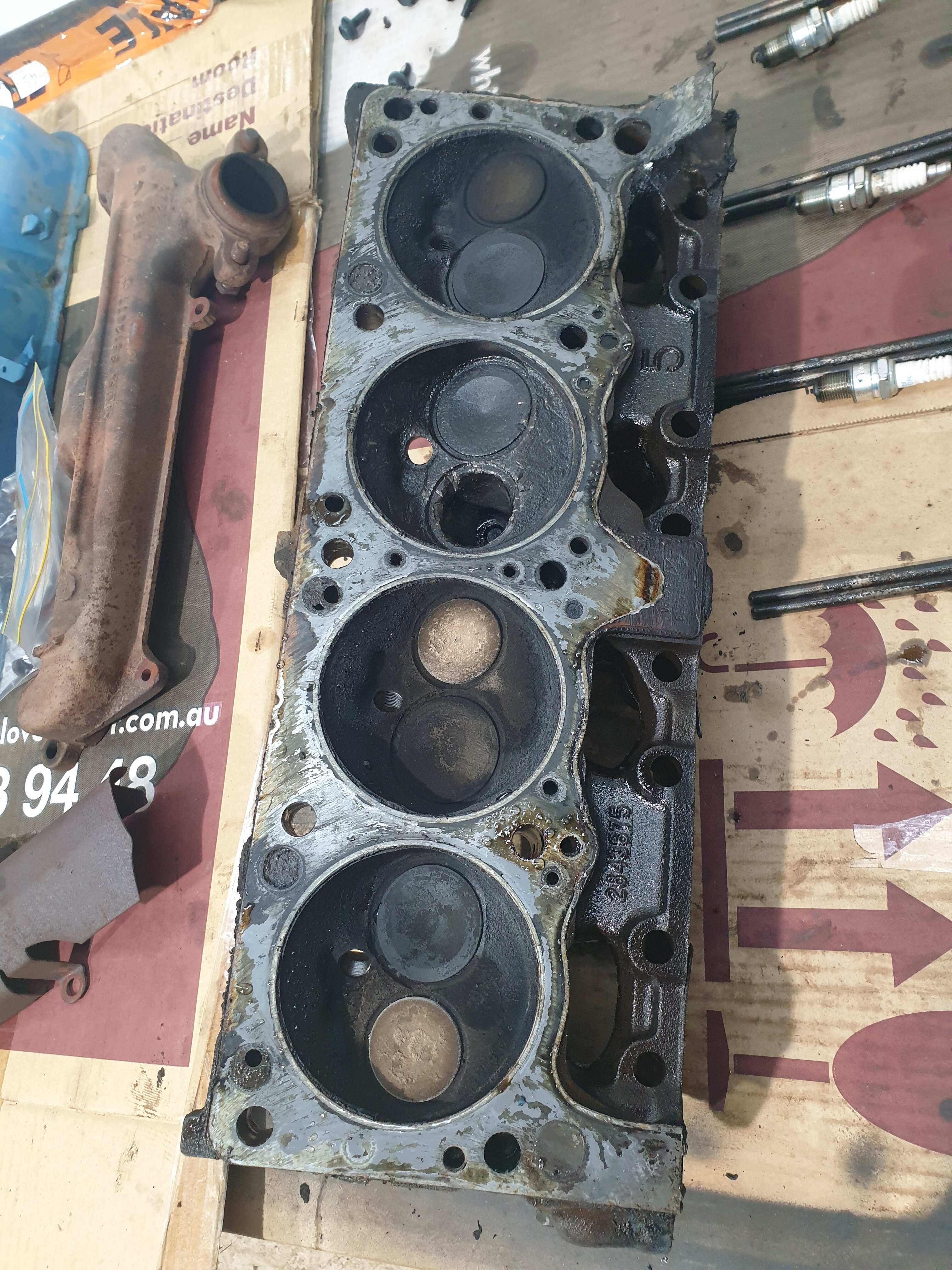

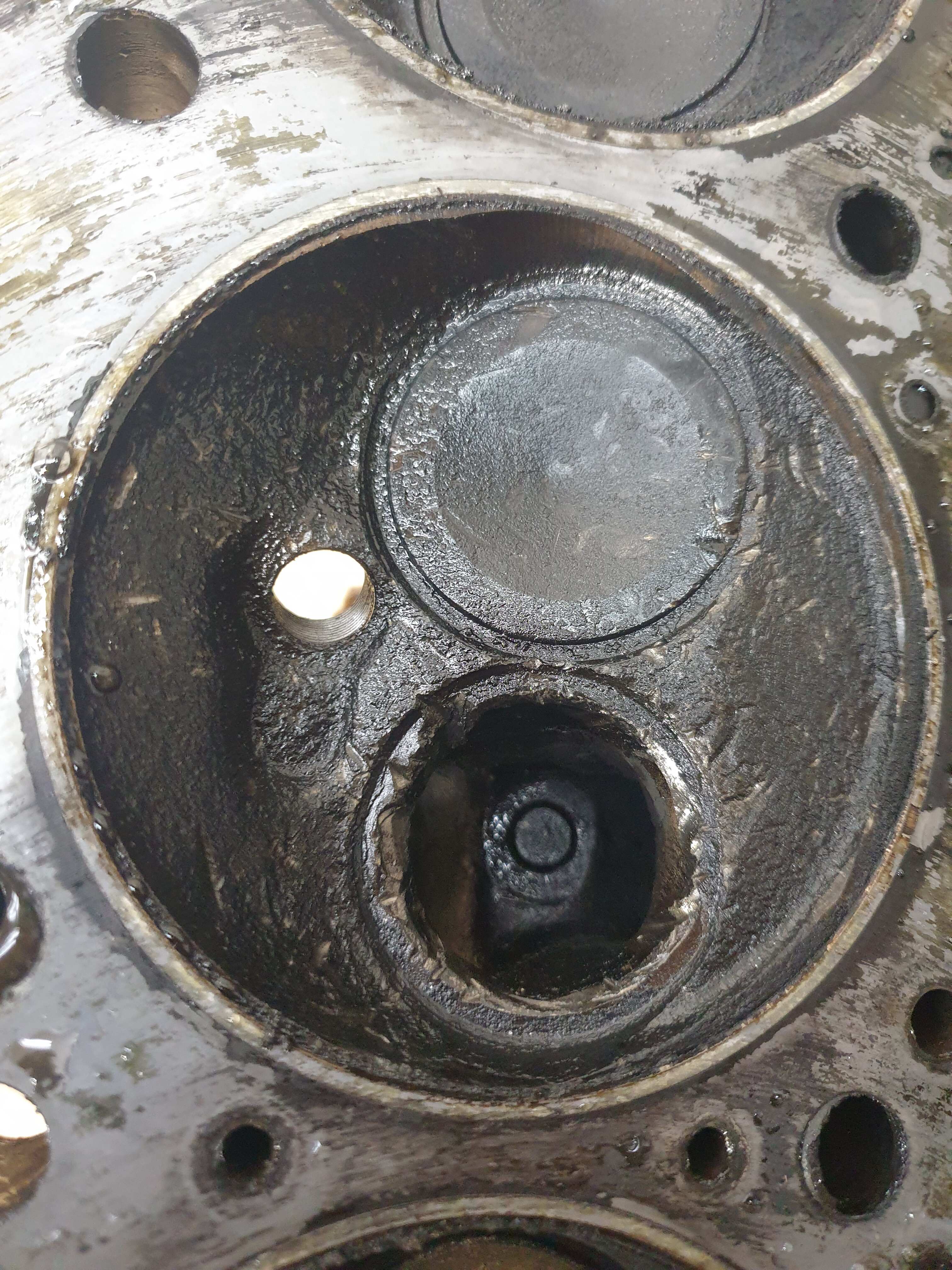

I agree, time to take the head off and see what happened. You might be looking at complete rebuild depending on damage.

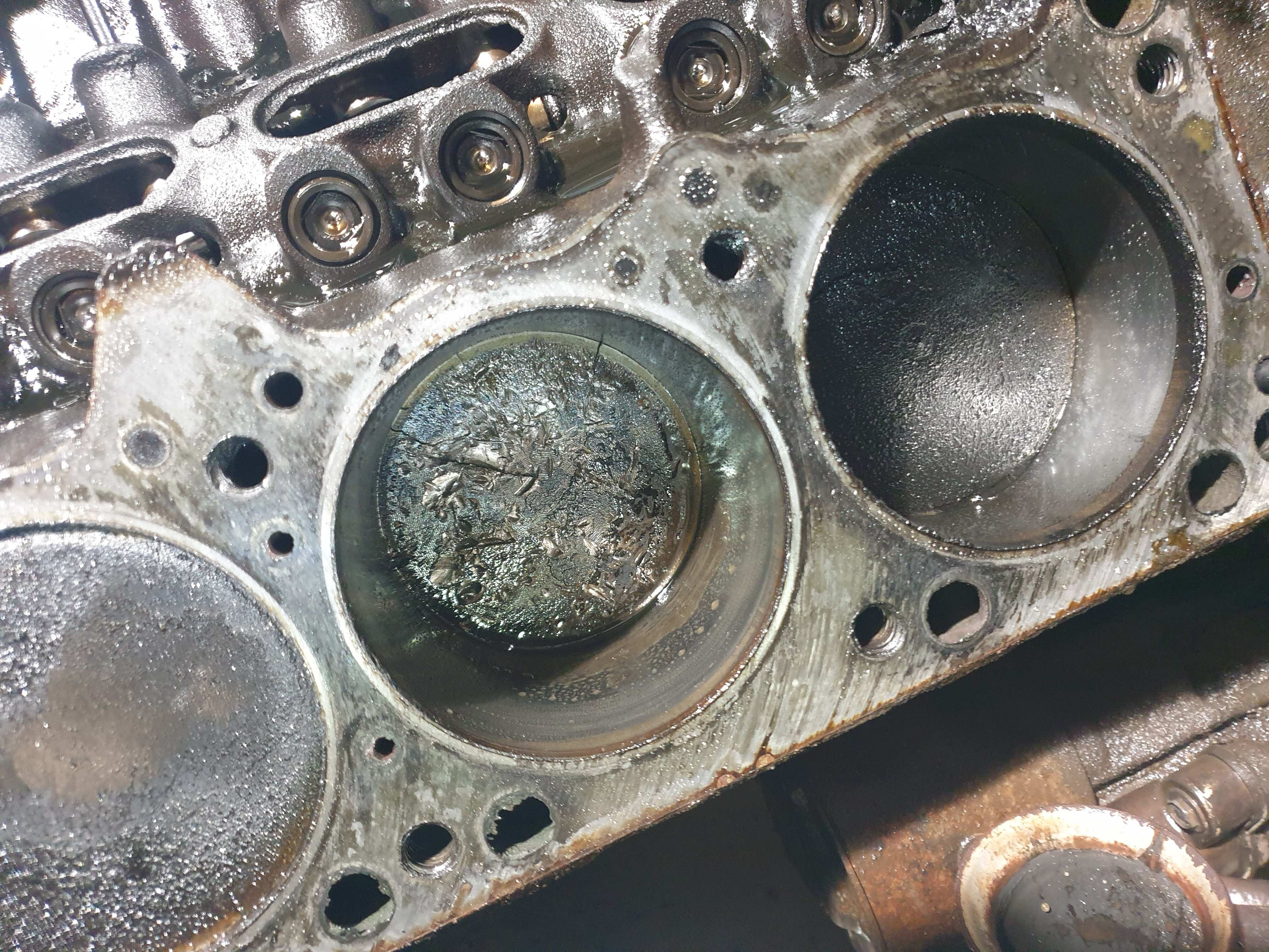

And that piston has a couple big cracks. Probably being held together by the rings and cylinder block. Is this the numbers matching 318? If so, I'd rebuild it - keep the Barracuda original. Just make sure the cylinder head and block are checked for cracks. If it's not the original 318, I'd spend my money on a 360. 360 long blocks are still easy to find. Or get a short block and run aluminium heads. All depends on your budget.
